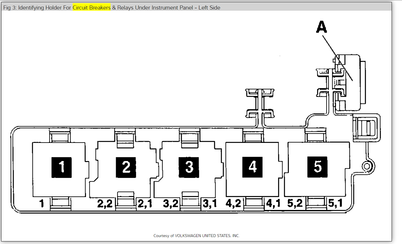

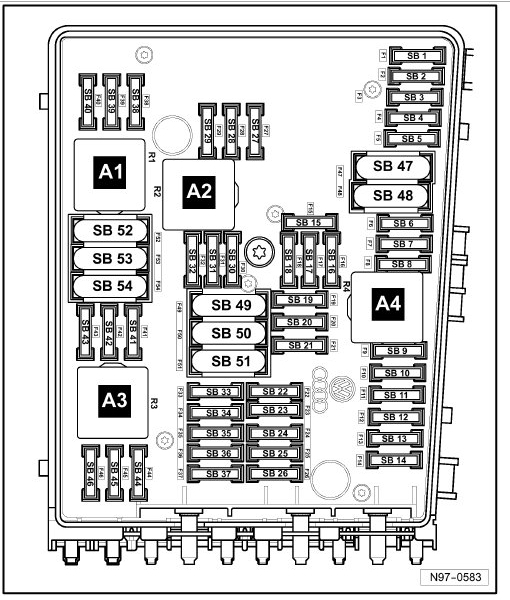

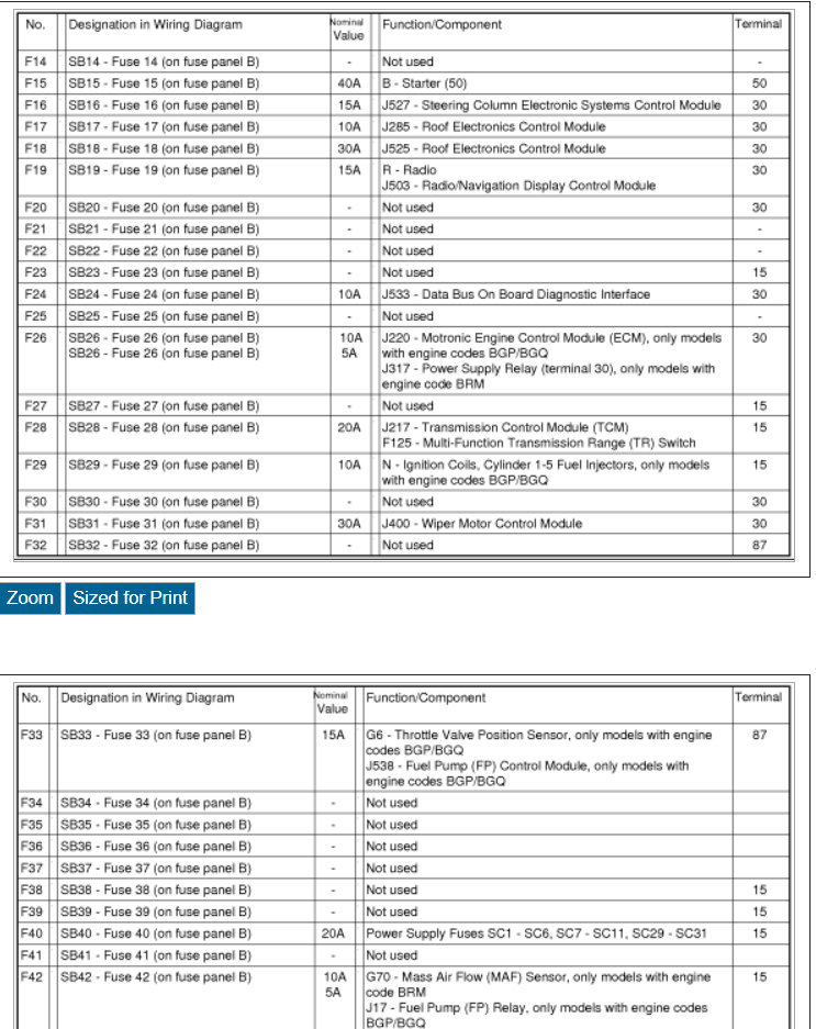

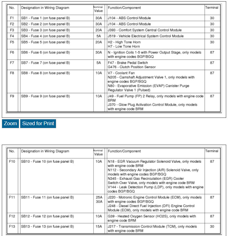

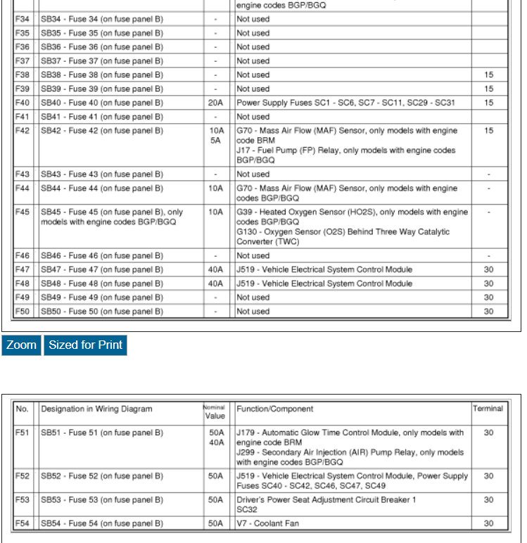

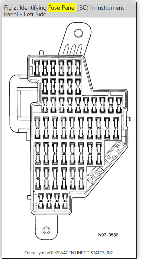

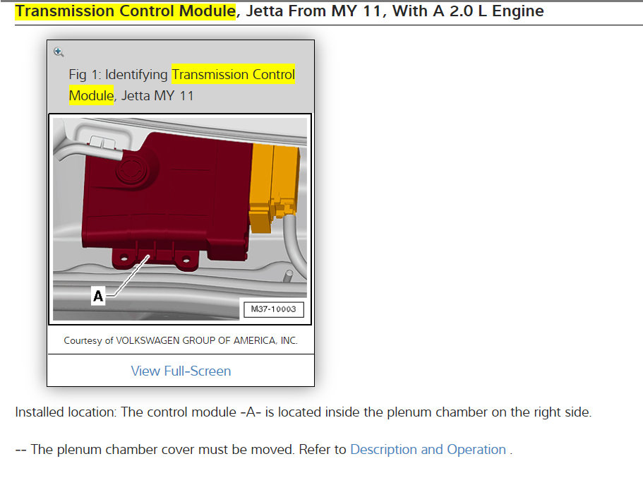

cranks no start. spark to coils but no spark.
Mar 30, 2021 at 3:39 AM
Experienced Mechanic
55,721 POSTS

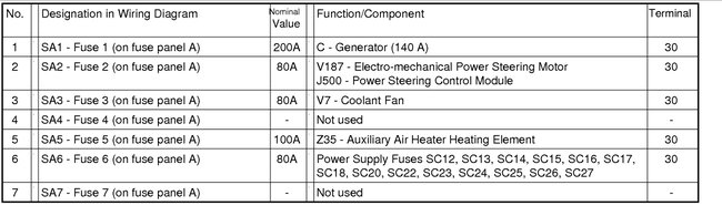

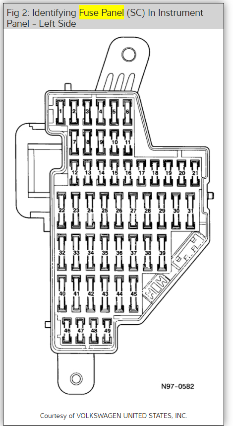

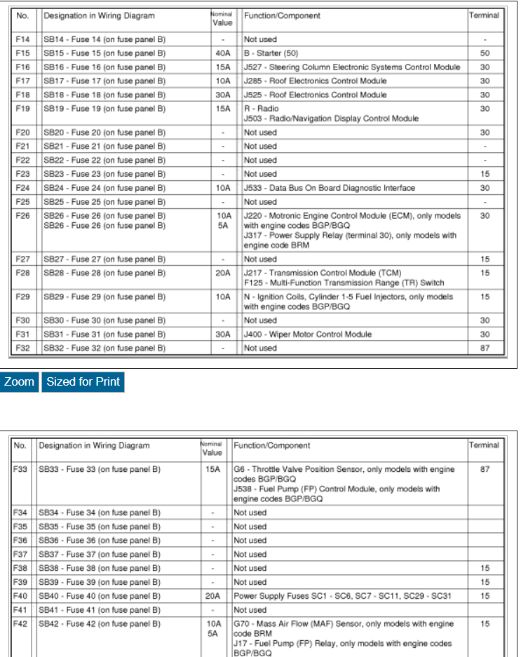

This means the transmission control module has lost power or is bad. lets start by checking the fuses. Here is a guide to help with the fuse and TCM locations below:
