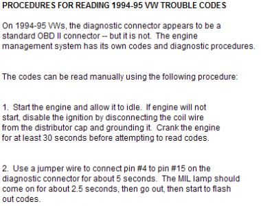

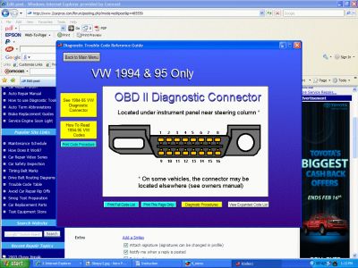

CAMSHAFT POSITION SENSOR, CHECKING Camshaft Position Sensor malfunctions are recognized by On Board Diagnostic (OBD). � � � Carry out electrical testing, test step 21. See ELECTRICAL TESTING . � � � Disconnect harness connector on Camshaft Position Sensor at Ignition Distributor. Fig. 12: Disconnecting Harness Connector On Camshaft Position Sensor At Ignition Distributor � � � Connect Fluke 83 multimeter with adapter cables from VW 1594 to measure voltage across outer terminals of connector. � � � Switch ignition ON. Specified values: � � � Up to 10.93 production, 49-states: 10 Volts min. � � � Up to 10.93 production, California: 5 Volts min. � � � From 10.93 production, all vehicles: 5 Volts min. If OK: � � � Replace Ignition Distributor. See Ignition distributor, removing/installing . If NOT OK: � � � Replace Motronic Engine Control Module (J220). Page 1 of 1 IGNITION-GLOW PLUG SYSTEM - 2.0L 4-CYL. 2V - ABA -1995 Volkswagen Jetta I... 2/14/2009 the codes like this

Next step is pull codes as shown above. Post results.
