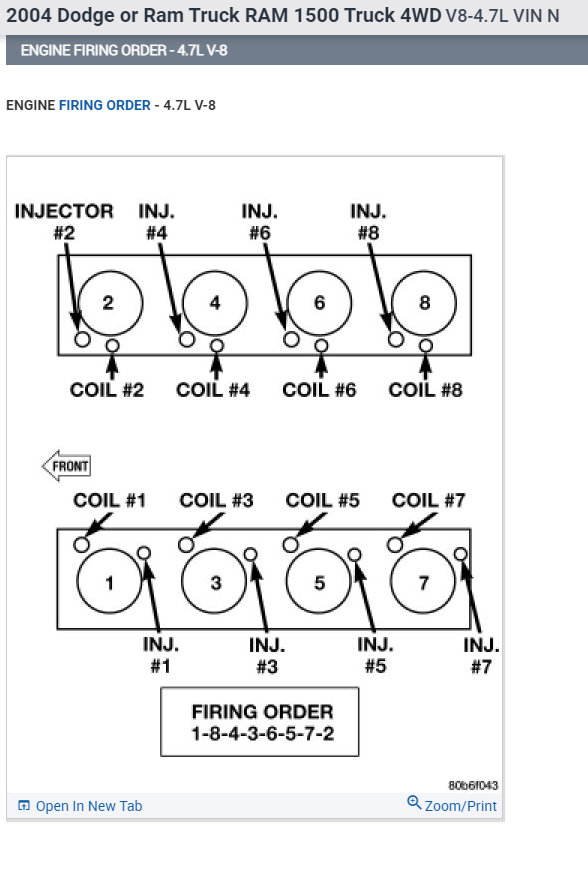

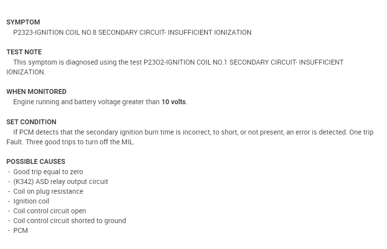

Bad coil pack what cylinder is letter H?
Oct 14, 2021 at 12:02 PM
SQM
  • 6,383 POSTS

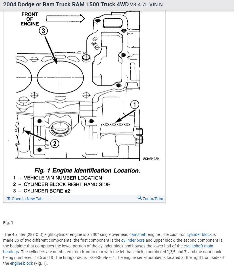

It should be cylinder number 8.
Which is located on the left-hand side, closest to the firewall (if you are facing the engine).

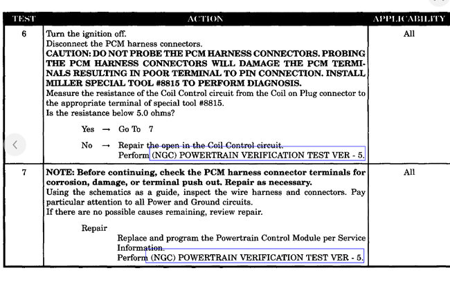

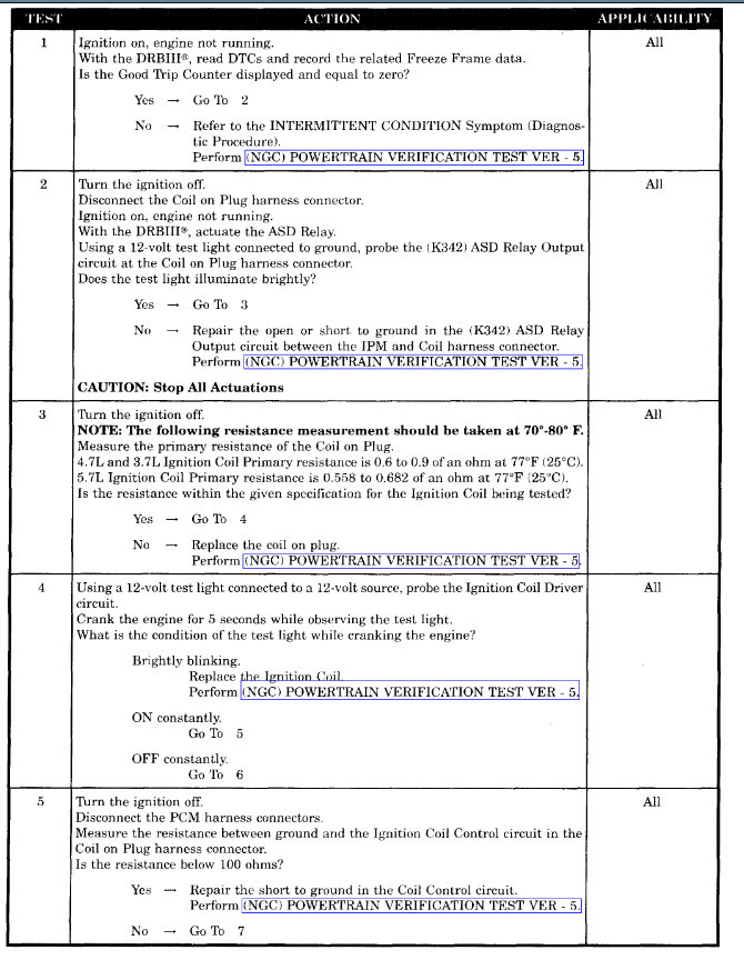

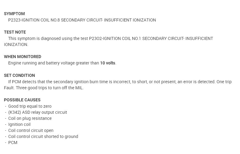

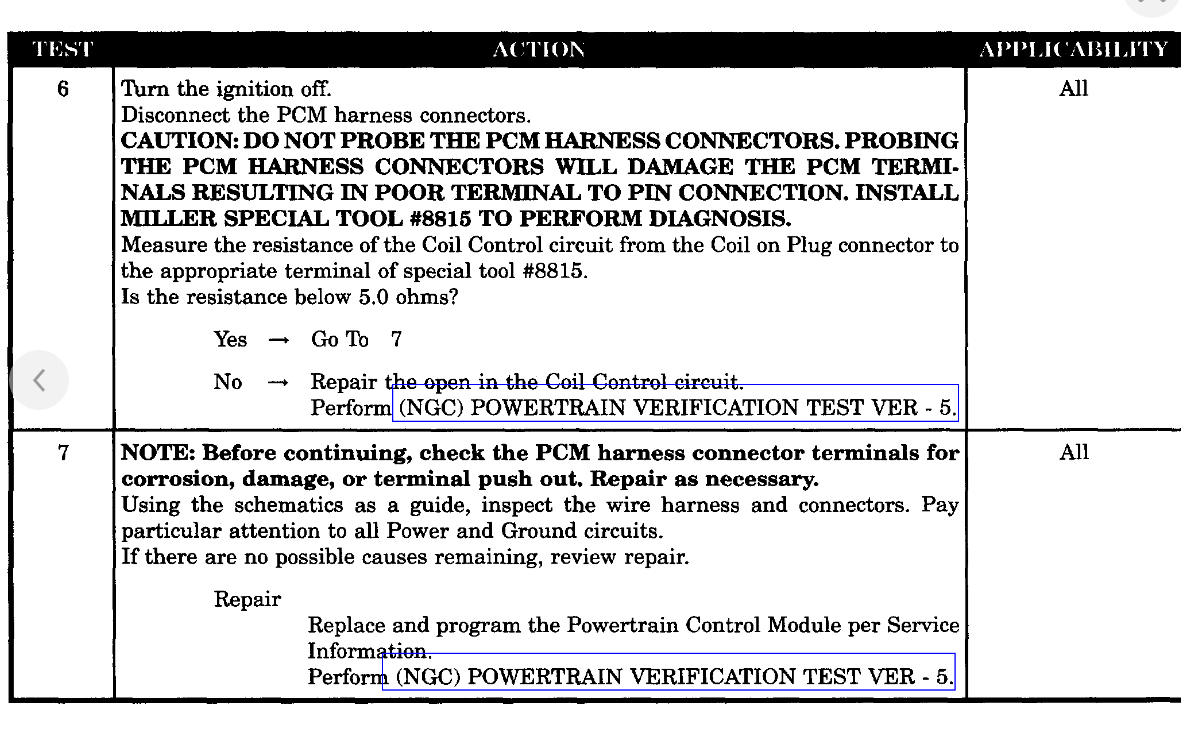

I have attached the P2323 trouble shooting steps below for your reference.
Oct 14, 2021 at 12:30 PM
KKEARNEY
Thank you it solved my problem.
Truck running great.
