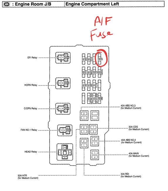

code p1135 and p1155
150,000 MILES • 3.0L • 6 CYL • 2WD • AUTOMATIC
TREVOR LA SHURE
My wife has the car listed above and we had Firestone tell us they wanted $3,000.00 to replace the intake manifold gasket and oil pan gasket as well as 4 engine mounts.. Being a DIY guy I took the project replaced everything.Working one side a time i used a floor jack to move it high enough to switch each mount. When I started the car back up it idled at 3,000 rpm with some white smoke for about 5 minutes and settled back down to 500 rpm, all the oil burned off? The car is now showing codes p1135 and p1155. So I went and got a new A/F sensor and replaced the easier to reach one in the front and unhooked the battery to let the computer restart and the code still shows. I was wondering if I messed up a ground somewhere? I can't imagine both going bad at the same time. Looking to sell the car ASAP as my wife is out of the country waiting for a VISA. Any information would be great going to check all fuses tomorrow.
Aug 2, 2019 at 2:20 PM
JIS001
  • 3,412 POSTS

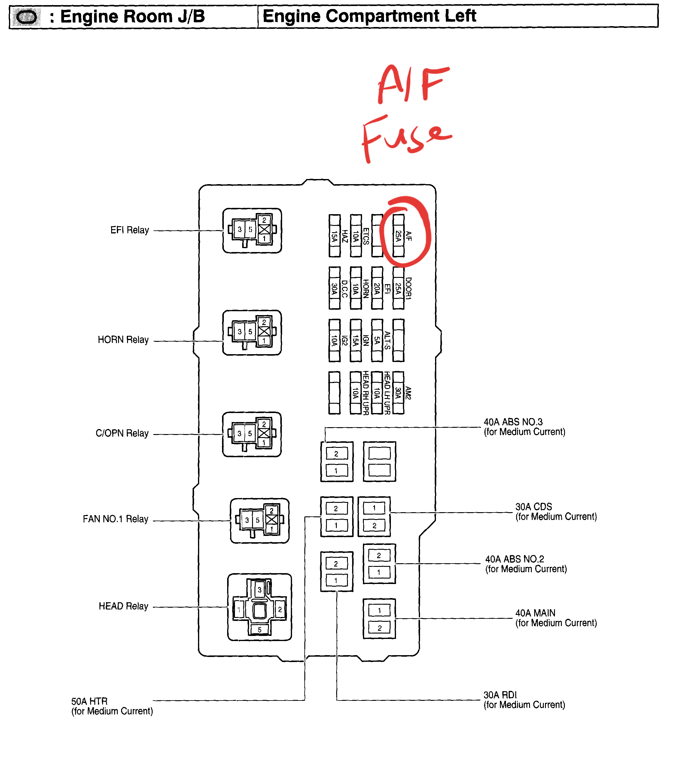

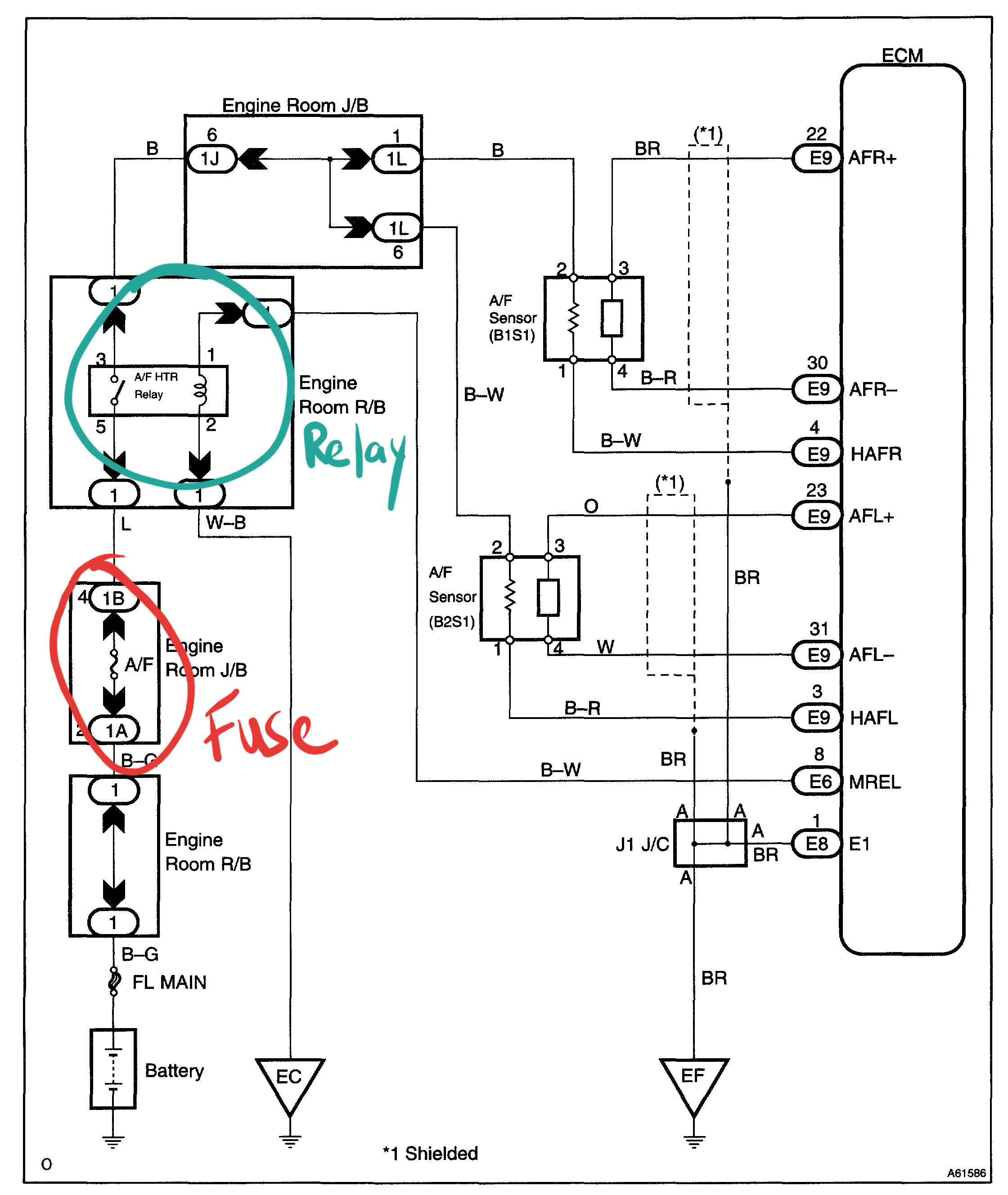

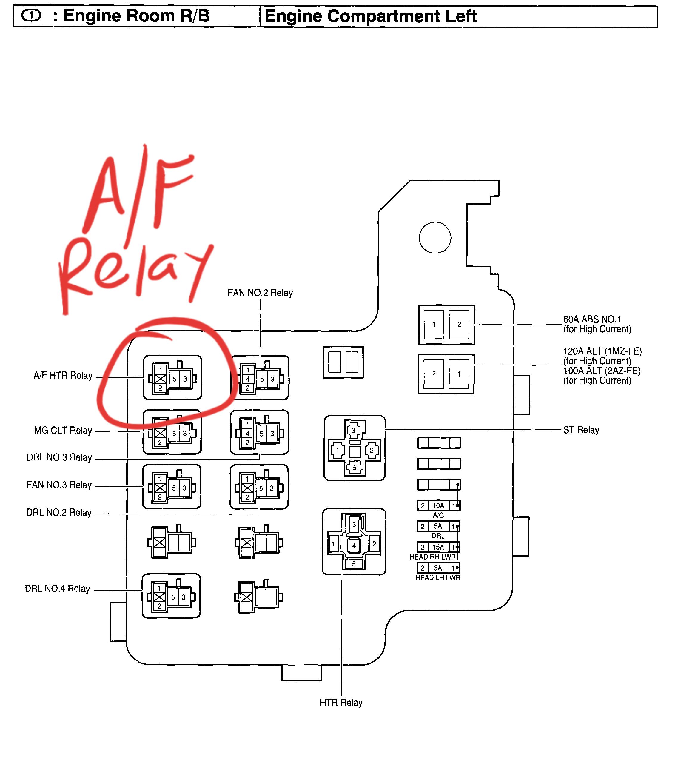

If you are replacing the A/F sensors I would recommend you replace them with OE or Denso. As for 2 sensors failing for a heater circuit malfunction I recommend you check the 25 amp fuse and if ok swapping out the A/F sensor relay. Attached images of locations. Let us know how the fuse looks.
Aug 2, 2019 at 3:22 PM
