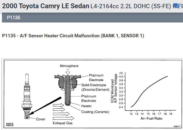

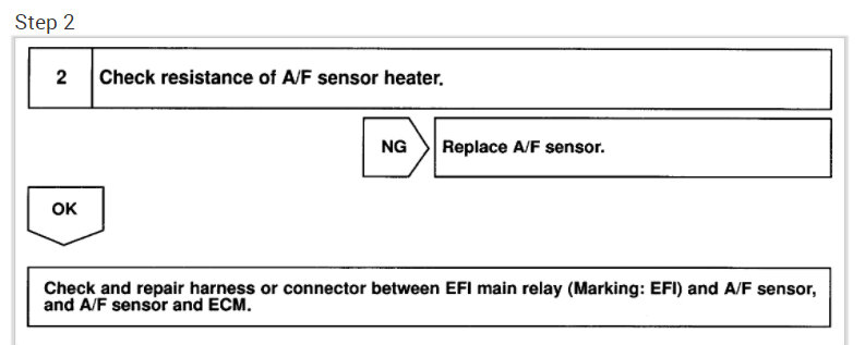

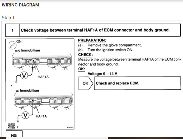

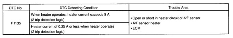

I got a CEL scan, code P1135 was the problem. Can someone tell me a little bit about this code and what needs to be fixed as well as an approximate cost? Thanks a lot.
Oct 24, 2009 at 10:21 AM
DANNY L
  • 5,648 POSTS
Hello, I'm Danny.

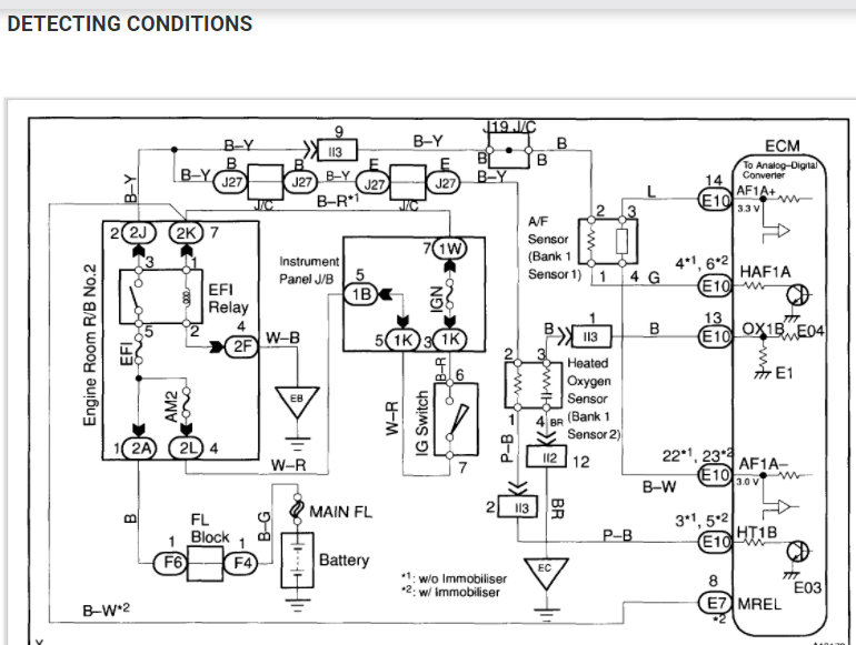

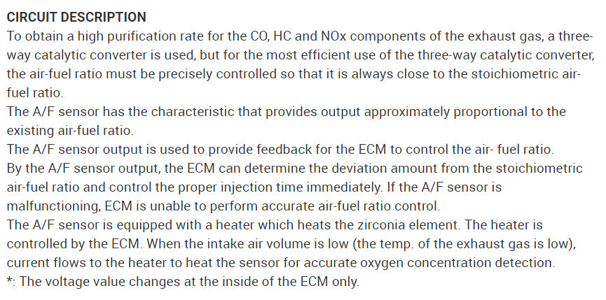

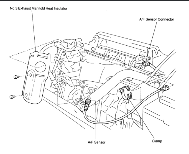

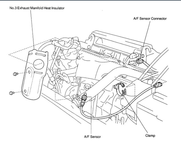

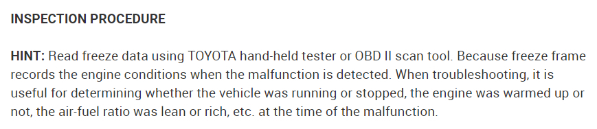

That particular code has to do with the front oxygen sensor on your car. It is what monitors the air-fuel ratio and emissions. Here are tutorials showing what is involved for operation and replacement:
https://www.2carpros.com/articles/how-an-oxygen-sensor-works
https://www.2carpros.com/articles/how-to-test-an-oxygen-sensor-02-sensor
https://www.2carpros.com/articles/how-to-replace-an-oxygen-sensor

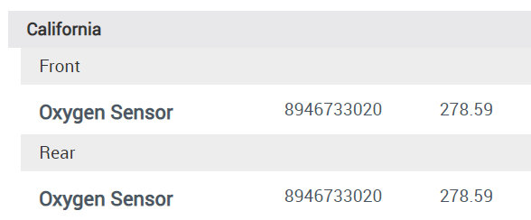

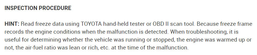

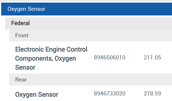

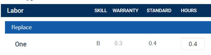

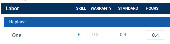

I've attached picture diagnostic steps and location below for your car. I've also attached the Toyota dealer part number, cost, and labor time. Depending on your area shop labor is around $100.00 an hour. Hope this helps and thanks for using 2CarPros.
