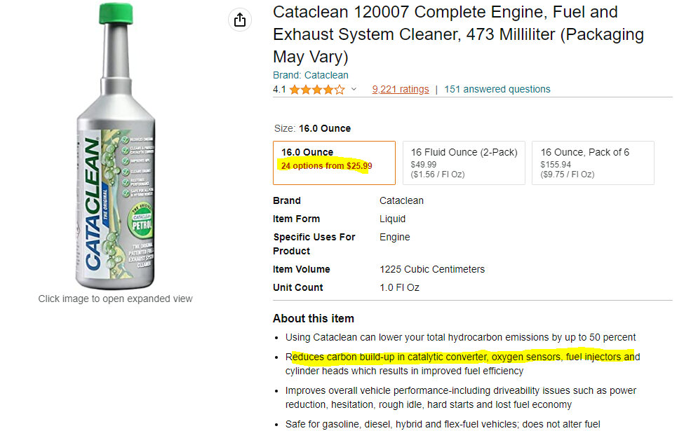

Hey Joe, thanks for your feedback. Could you please suggest to me the best way to use the fuel injector cleaner?
Close to empty the tank > Injector> premium fuel full tank??

There are a lot of different manufacturers that make it. I attached a pic below of an example that has helped others in the past.
This will be added to the fuel system. The directions are on the product.
See pic below.
