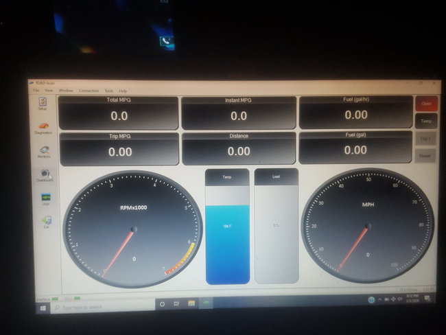

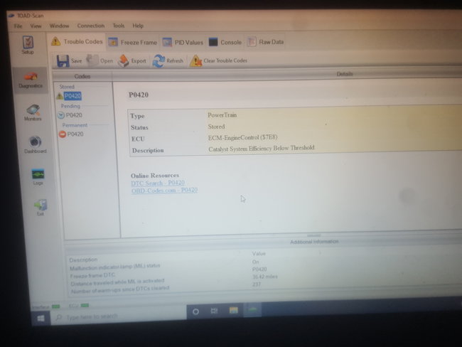

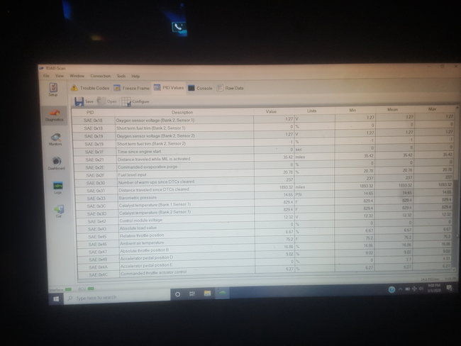

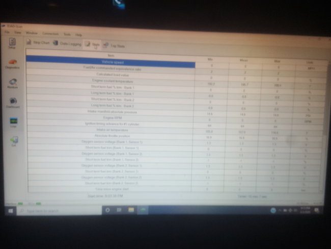

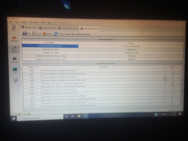

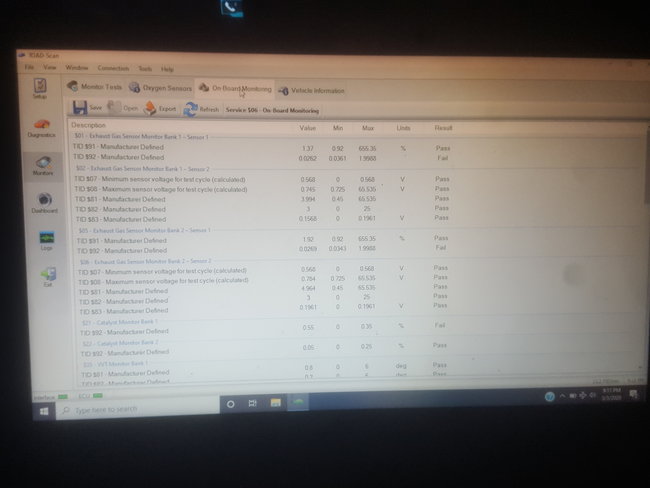

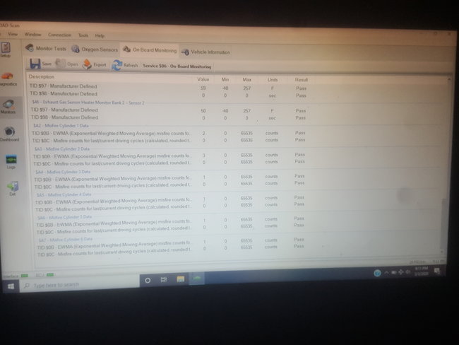

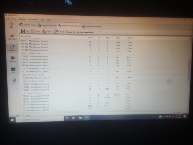

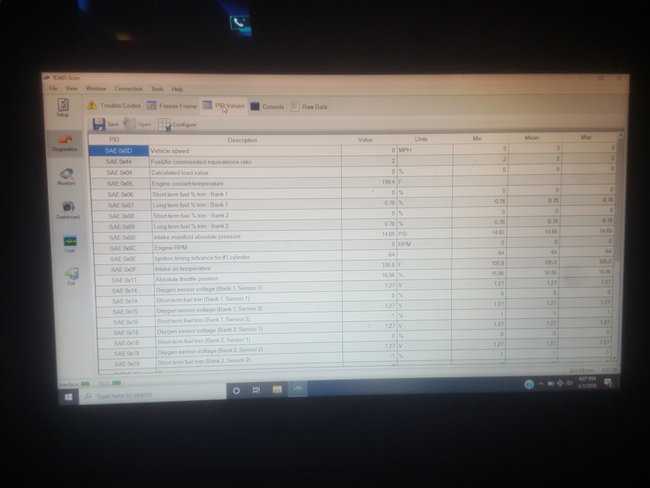

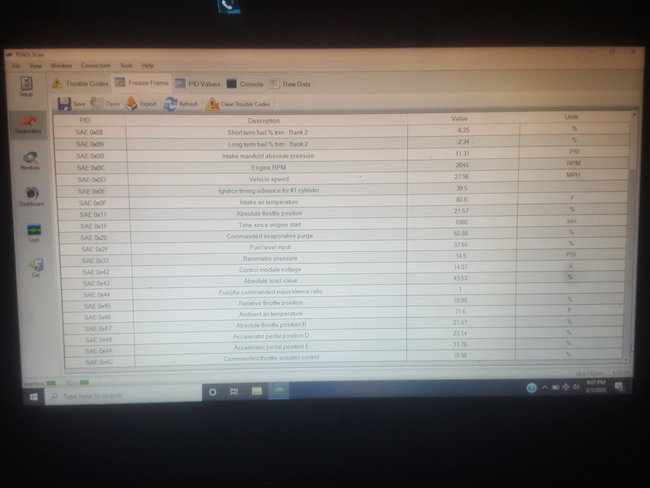

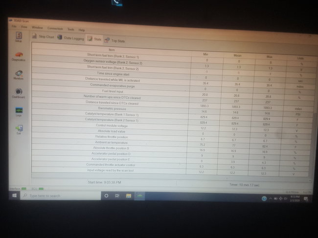

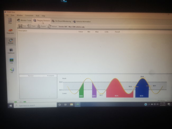

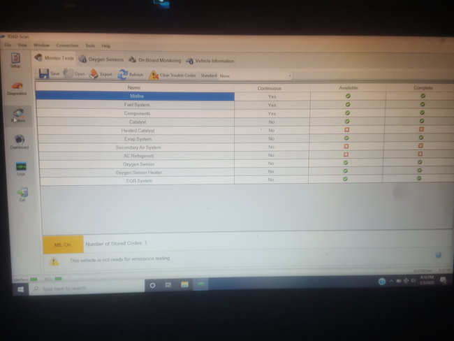

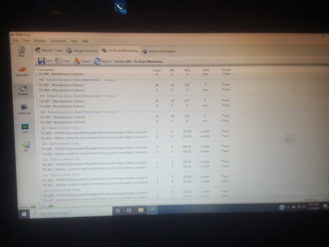

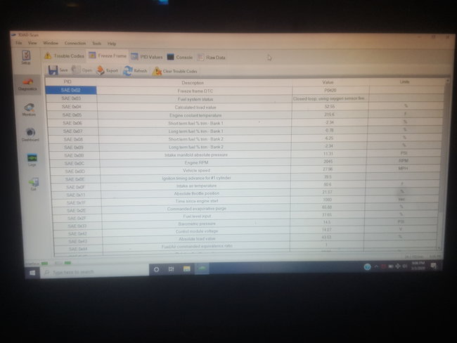

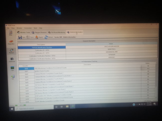

Code says P0420 pending, stored and permanent at same time . Will upload screen shot photos of diagnostics.
Where in any of the uploads shows the underlining issue that triggered the code?
What is the remedy ?
Are there any other strange readings showing in the diagnostics?
Thanks in advance.

P0420 - Catalyst System Efficiency Below Threshold (Bank 1)
The suspect is the driver's side catalytic converter needs to be replaced. Don't be mislead by a lot of people telling you to replace oxygen sensors. It takes properly-working front and rear O2 sensors to detect when no change is taking place in the exhaust gas as it passes through the catalytic converter.

Okay, thanks. Were there any anomalies within the diagnostic photos that i should be made aware? Or additional concerns?
Mar 9, 2020 at 9:51 AM
CARADIODOC
  • 34,381 POSTS
I can't read the listings. That's a common problem, so I just go by the fault code description.
I do have to correct myself on the list of suspects. It is important to understand that fault codes never say to replace a part or that one is bad. They only indicate the circuit or system that needs further diagnosis, or the unacceptable operating condition. When a sensor or other part is referenced in a fault code, it is actually the cause of that code about half of the time. With a code 420, I was taught it can only be caused by the catalytic converter, and it can only be detected with two properly-working oxygen sensors, one ahead of the converter and one after it. There is always a list of things to check first before spending our customer's money on a part referenced in a fault code, but as I mentioned, only the converter can cause this one, . . . or so I thought. In fact, it can be set by a defective sensor or a wiring problem for one of them. That takes care of the one mistake I allow myself per year!
I'm going to post the list of troubleshooting steps so you can see what we are supposed to go through before blindly replacing a part, but to do it justice, I have to copy and format some drawings. I'll work on that at home tonight, to put it in a format I can upload and you can read. I'm pretty confident the converter is going to have to be replaced, but look through the list first. You might recognize something on it that pertains to your car.

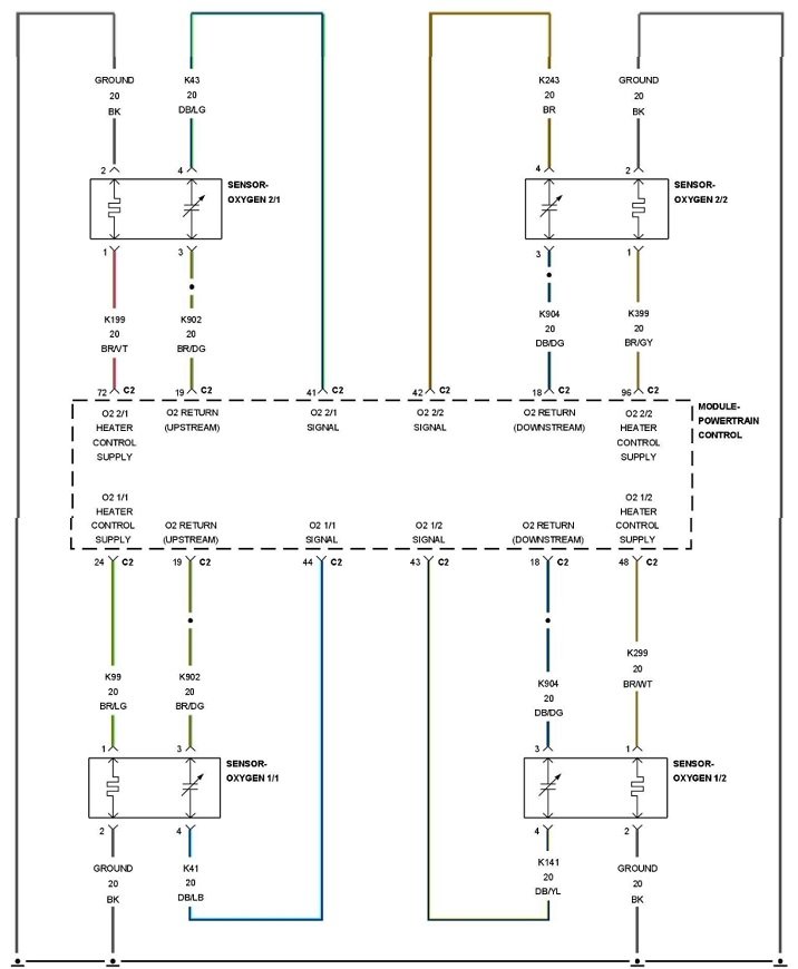

Drawing 1
Diagram 2
For a complete wiring diagram, refer to the Wiring Information.

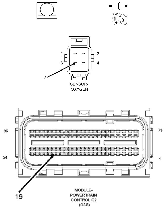

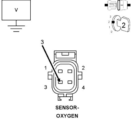

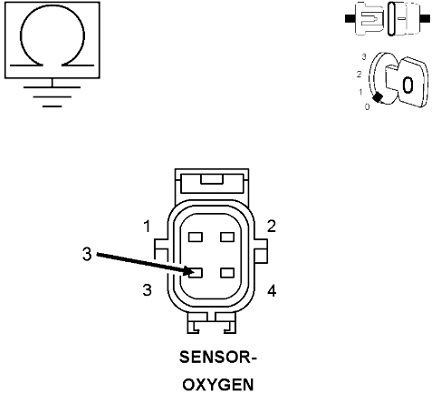

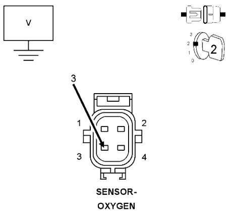

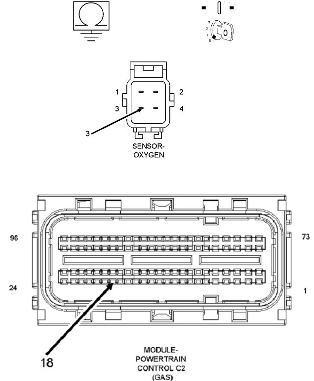

3. (K902) O2 SENSOR 1/1 RETURN CIRCUIT VOLTAGE CHECK
Drawing 4
1. Turn the ignition off.
2. Disconnect the O2 Sensor 1/1 harness connector.
3. Turn the ignition on.
4. Measure the voltage on the (K902) O2 Sensor 1/1 Return circuit in the O2 Sensor 1/1 harness connector.
Is the voltage at 2.5 Volts?
- Go To 4
- Go To 5

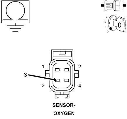

4. (K904) O2 SENSOR 1/2 RETURN CIRCUIT VOLTAGE CHECK
Drawing 5
2. Disconnect the O2 Sensor 1/2 harness connector.
4. Measure the voltage on the (K904) O2 Sensor 1/2 Return circuit in the O2 Sensor 1/2 harness connector.
- Go To 10
- Go To 7

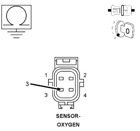

5. (K902) O2 SENSOR 1/1 RETURN CIRCUIT SHORTED TO GROUND
Drawing 6
2. Disconnect the PCM C2 harness connector.
3. Measure the resistance between ground and the (K902) O2 Sensor 1/1 Return circuit in the O2 Sensor 1/1 harness connector.
Is the resistance below 100 Ohms?
- Repair the short to ground in the (K902) O2 Sensor 1/1 Return circuit.
- Perform the POWERTRAIN VERIFICATION TEST. See: A L L Diagnostic Trouble Codes ( DTC ) > Verification Tests > Powertrain Verification Test.
- Go To 6

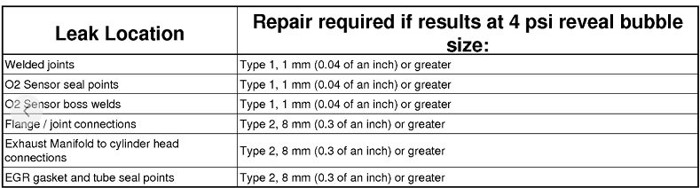

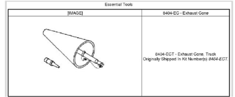

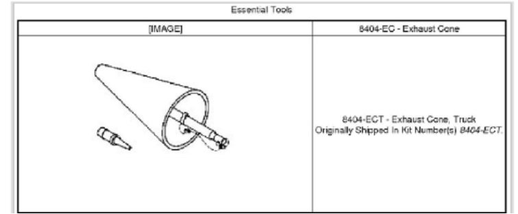

10. CHECKING THE EXHAUST SYSTEM FOR LEAKS
2. Raise the vehicle.
WARNING: The normal operating temperature of the exhaust system is very high. Never work around or attempt to service any part of the exhaust system until it has cooled. Special care should be taken when working near the catalytic converter. The temperature of the converter rises to a high level after a short period of engine operating time.
3. Connect Exhaust Cone or to Air Pressure Regulator (with hose) W-18-MIL-1146AS.
CAUTION: The air pressure must not exceed 27.6 kPa (4 psi), otherwise engine damage can occur.
4. Attach shop air to the air pressure regulator.
5. Adjust the Air Pressure Regulator to 27.6 kPa (4 psi).
6. Insert the exhaust cone into the vehicle tail pipe.
7. If the vehicle is equipped with dual exhaust. Use the with equipped attached plug, plug one side of the dual exhaust pipe. Pressurize the other as described above.
8. Apply Mopar(R) Air Leak Detector PN# 05191804AA (or an equivalent leak finder liquid) to the following areas:
- All welded joints from the exhaust manifold to 152.4 mm (6 inches) behind the downstream O2 Sensor
- O2 Sensor seal points
- O2 Sensor boss welds
- Flange/joint connection(s)
- Exhaust manifold to cylinder head connection(s)
- EGR solenoid gasket base and tube seal points (if equipped)
9. Watch for the liquid/soapy water to bubble.
10. Use the following definitions to help determine if system or component repair/replacement is necessary:
- Type 1 Leak is defined as a leak where very small foam like bubbles 1 mm (0.04 of an inch) or less appear. Any Type 1 or greater leaks found in welded joints, O2 Sensor seal points or O2 Sensor boss welds must be repaired or the component must be replaced.
- Type 2 Leak is defined as a leak where larger bubbles pea size, 8 mm (0.3 of an inch) or greater appear. Any Type 2 or greater leaks found in flange or joint connections, exhaust manifold to cylinder head connections or EGR gasket and tube seal points must be repaired or the components must be replaced.
Drawing 10
11. If a leak is found that matches the above definition, repair or replace the component as necessary.
12. Once the repair is complete, repeat the procedure to verify that all leaks have been repaired.
Were any exhaust leaks found?
- Repair or replace the leaking exhaust parts as necessary.
- Go To 11
