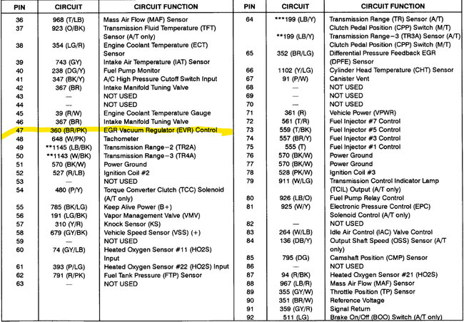

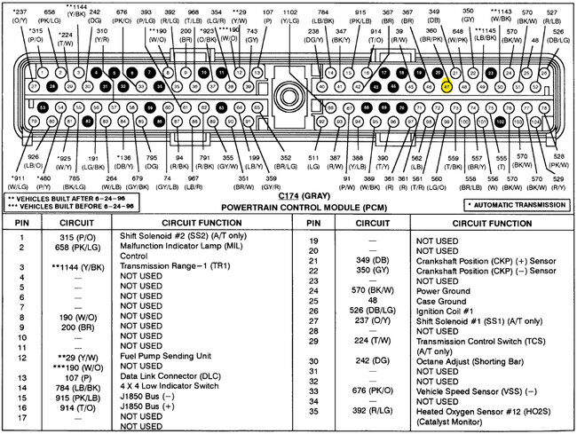

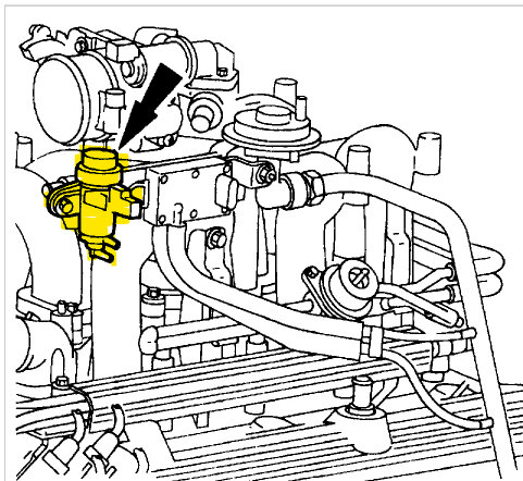

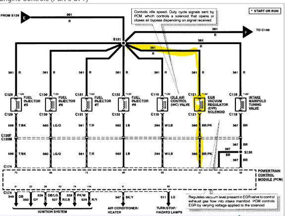

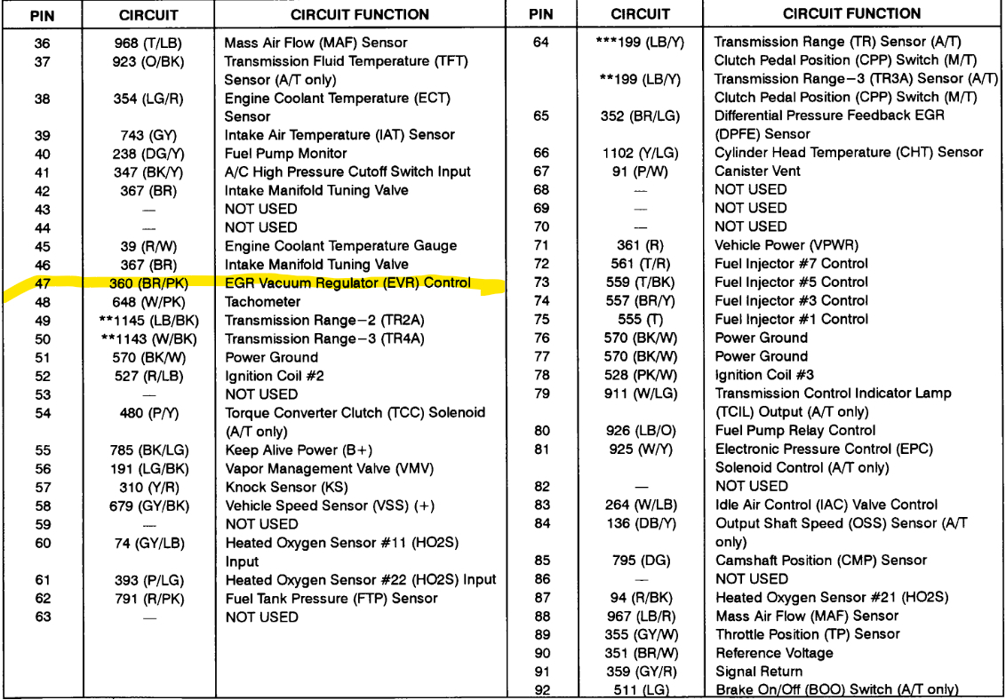

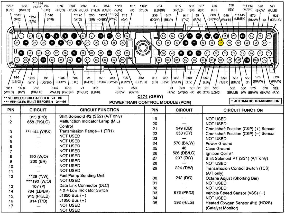

Great, thank you for that info. Let's check for voltage at the EVR solenoid. Disconnect the 2-wire connector from the solenoid and then turn the ignition to on. Measure voltage from the red wire to ground, you should get battery voltage. Since the PCM only commands the EVR solenoid on a warm engine while driving under light to moderate throttle, it can be hard to test the control side. We can test the BR/PK wire for a short to ground and short to power with KOEO. That's Key on Engine Off. If no issue is found, the next step would be to test for continuity from the EVR solenoid connector to the PCM connector. You will need to remove the battery and battery tray to access the PCM connector. Just test continuity from pin 47 of the PCM connector to the BR/PK wire of the EVR solenoid connector, anything under 5 ohms is good. You can also inspect the vacuum reservoir, lines and check valve while the battery tray is removed. I highlighted the EVR solenoid and related wiring. Let me know if this helps.
