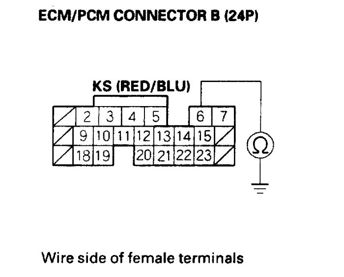

Car is throwing a knock sensor code (P0325). Have replaced everything I can think of to remedy the problem but have not been able to fix the problem. Parts that I have replaced so far; all of the coil packs, EGR valve, fuel injectors, fuel pump, knock sensor, knock sensor sub harness. The freeze frame data from the code reader shows the spark advance at 33° at 3,600 rpm. Where do I go from here?

I listed the possible issues around the codes. Most of the possibilities are wire harness related, not component.
Most of the parts you replaced have nothing to do with the code. The flow chart is below as well for tracking the failure for this issue.

6. Turn the ignition switch OFF.
7. Jump the SCS line with the HDS.
8. Disconnect the knock sensor subharness 1P connector.
9. Disconnect ECM/PCM connector B (24P).
10. Check for continuity between ECM/PCM connector terminal B6 and body ground.
Is there continuity?
YES - Repair short in the wire between the ECM/PCM (B6) and the knock sensor, then go to step 17.
NO - Go to step 11.

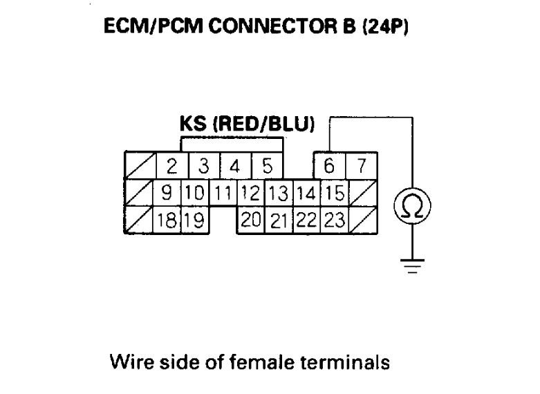

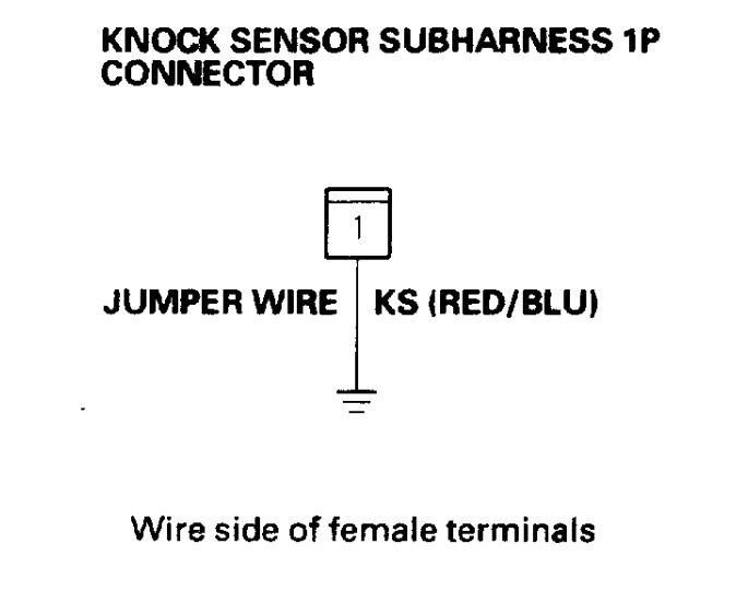

11. Connect the knock sensor knock sensor subharness 1P connector terminal to body ground with a jumper wire.
12. Check for continuity between ECM/PCM connector terminal B6 and body ground.
YES - Go to step 13.
NO - Repair open in the wire between the ECM/PCM (B6) and the knock sensor, then go to step 17.
