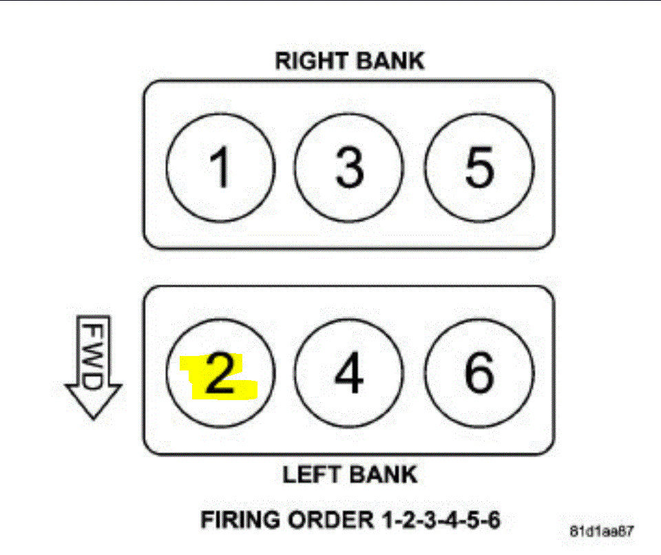

Again, I have no idea why the cylinder 6 spark plug was replaced and cylinder 2 wasn't. That makes no sense to me based on the code.

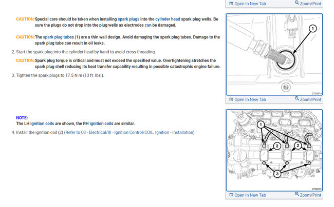

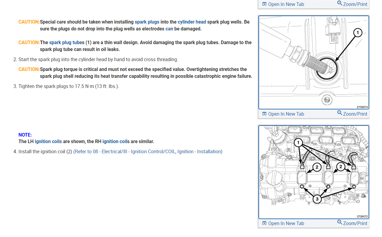

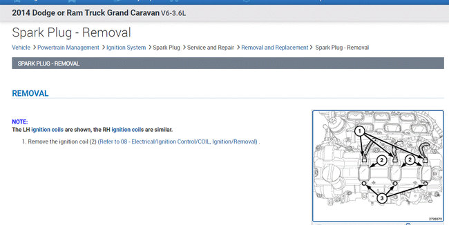

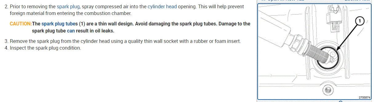

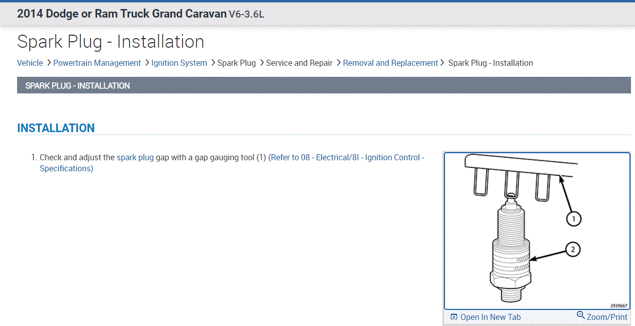

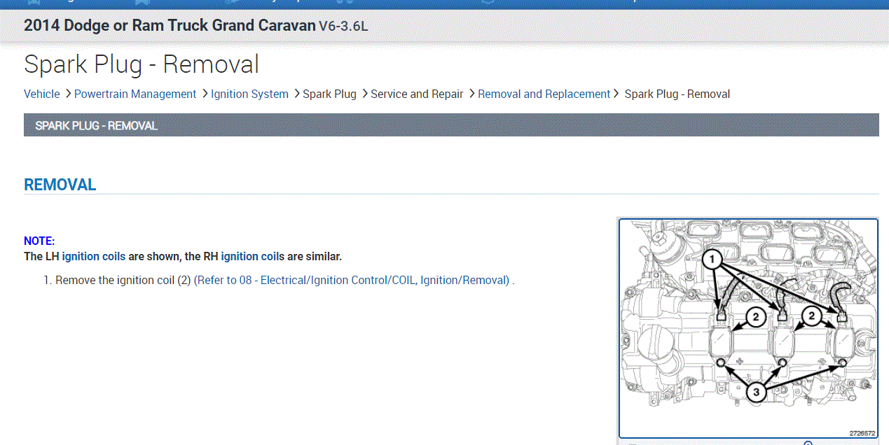

If you look at the pics below, they are specific to removal and replacement of the spark plugs for your vehicle. The last picture shows cylinder locations. I highlighted cylinder 2. It is one of the easiest to get to. Remove the spark plug and replace it with a new one. If the coil was bad, the plug may be bad.
The original equipment spark plug is a champion part number RER8ZWYCB4. It is an iridium spark plug so expect to pay between 8 and 10 dollars for one.
