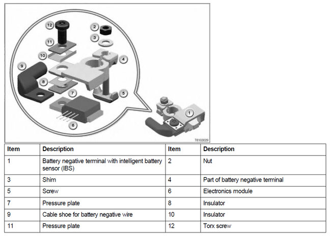

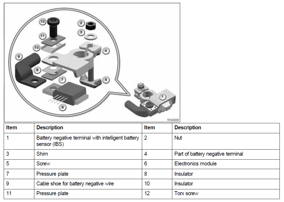

What goes wrong with these? They fail on the inside?
Tuesday, January 24th, 2023 AT 9:36 AM
BORIS K
  • 836 POSTS
Yes, the IBS fails on the inside.
The intelligent battery sensor (IBS) is an intelligent, mechatronic component that monitors the battery condition.
The power supply to the IBS is provided through a separate wire.
For the purpose of data transmission, the IBS is connected to the digital engine electronics (DME) or digital diesel
electronics (DDE) via the bit serial data interface (BSD).
The intelligent battery sensor (IBS) consists of mechanical components, the electronics module and software.
- Mechanical components
The battery terminal with earth cable is the connection to the negative terminal of the battery and serves
� to create an electrical contact to the body
� as the support for the sensor element for current measurements
� as the support for the electronic module
� to provide an adequate thermal contact between the temperature sensor and the negative terminal of the battery
� as protection for the sensitive electronic module
� as an earth connection for the IBS
The mechanical parts are listed in image 1.

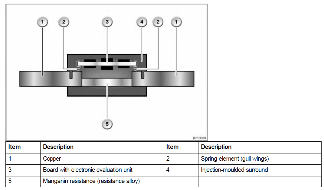

Electronic module:
The electronic module has the task of recording the voltage, the current flow and the temperature of the battery. The
following components are housed in the electronic module:
� a shunt (resistance for current measurement)
� a temperature sensor
� an electronic evaluation unit on a board
The board, which is about the size of a fingernail, contains an electronic circuit for evaluating the data measured.
The intelligent battery sensor (IBS) is able to withstand thermal loads of up to 105 °C and the chemical effect of the battery
acid. The IBS thus satisfies the necessary conditions for installation in the engine or luggage compartment.
The components of the shunt are illustrated below in image 2
