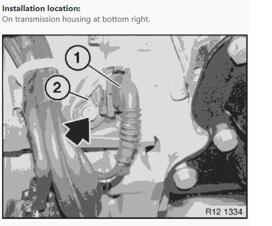

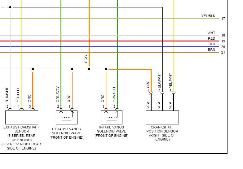

Code 51A6 is a transmission control module-engine control module communication issue.
Usually, a bad or missing signal from the engine control module.
This can be caused by a bad crankshaft position sensor or damaged/corroded wiring.
The sensor is located on the bottom right of the transmission housing, see image below.
Suggest inspecting the wiring and connector to the sensor first.

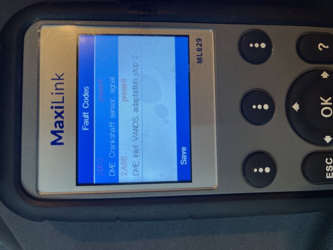

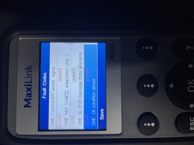

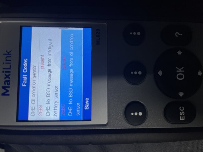

Changed CPS, but it is showing these codes.
Jan 16, 2023 at 1:35 PM

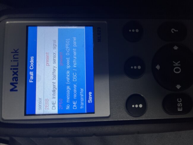

BHAMDOC1973
  • 2,007 POSTS

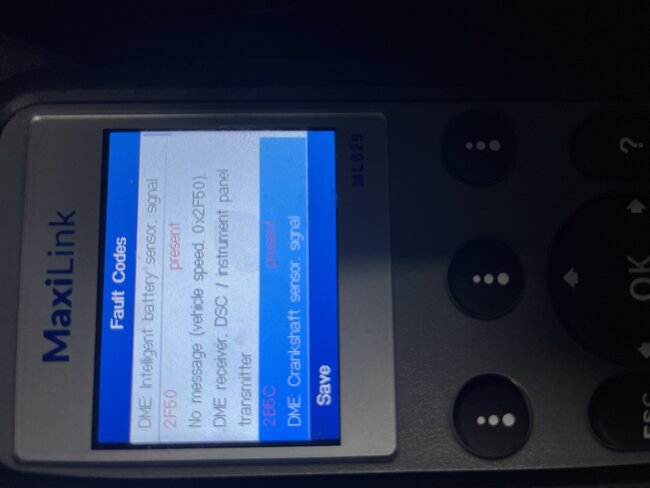

More.

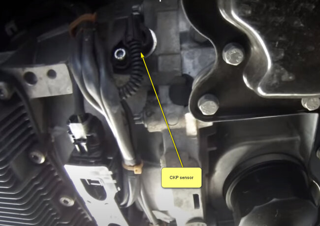

Looking at the fault codes you still report a crankshaft sensor fault.
Are you sure that you replaced the correct sensor at the transmission housing?
You report replacing the CPS sensor, which is a camshaft position sensor.
See image below for the location of the CKP sensor.

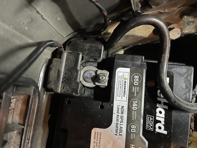

The intelligent battery sensor is located at the negative terminal of the battery.
This sensor can also cause no start no crank issues.

Yes, i replaced the crank one by the transmission housing. Not OEM. Let me check the intelligent sensor.

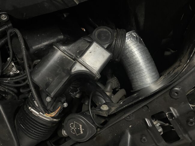

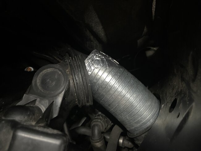

Also, there is an aftermarket filter that is not installed properly, but the MAF is still in place, i would think regardless of connecting this tube it should run okay.
Jan 17, 2023 at 7:00 AM

BORIS K
  • 836 POSTS
This contraption of intake system should not cause starting or idling issues but keep in mind that this will cause contamination of the MAF sensor and the obvious dirt ingress into the engine.
I would certainly strip the carpet back and check any surrounding wiring, connectors and modules for possible corrosion.
Cheers, Boris

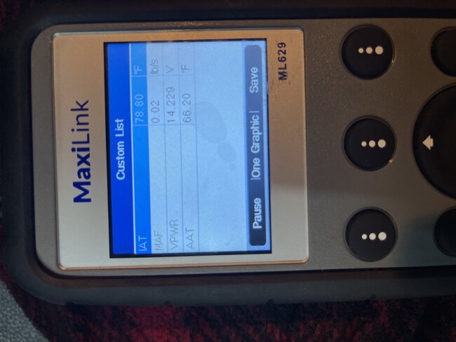

Cleaned out MAF and it started much better, RPM steady.
Jan 17, 2023 at 7:22 AM
BHAMDOC1973
  • 2,007 POSTS
Still some codes, with the scan er still shows in limp mode Nd 3rd gear.

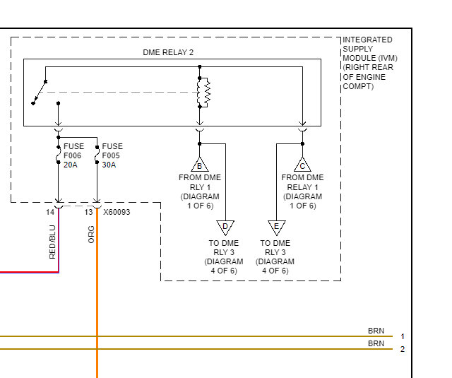

Can you check if this car has a fuse for the crank shaft position sensor? Also, i read some forums stating that their issue was solved after replacing the thermostat.

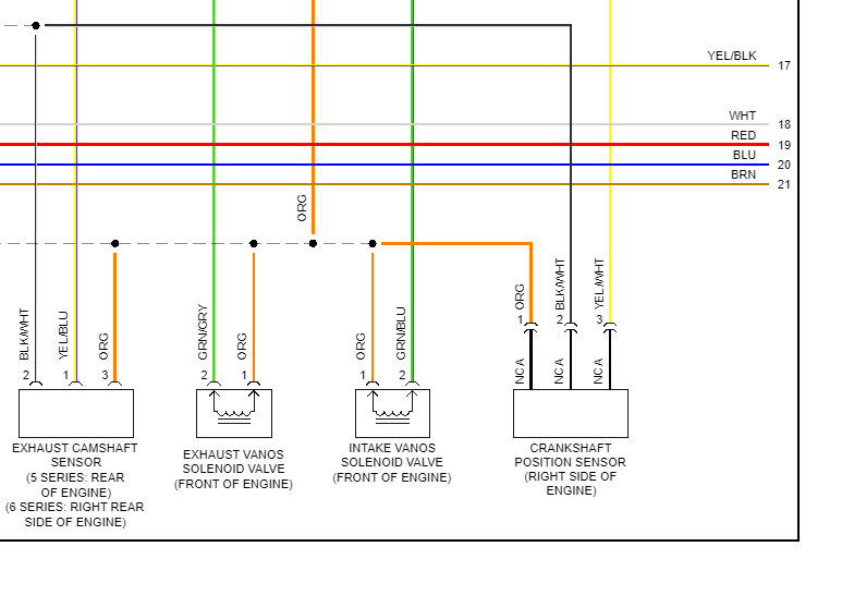

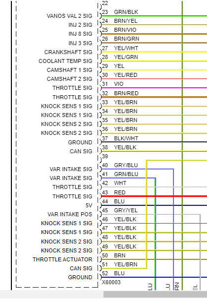

I checked wires on the crank sensor using a probe, one is ground, one battery voltage and the other just reads 10.3, does not say volts, does not beep or light up. i don't know if this is an issue.
Jan 18, 2023 at 8:27 AM
BORIS K
  • 836 POSTS

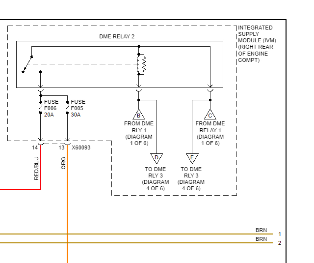

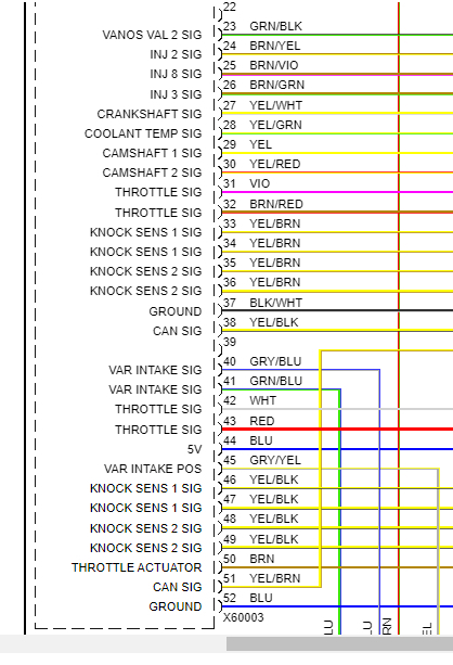

The crankshaft position sensor is supplied with 12V on orange wire from fuse F005(30A), see image 2 below.
The black/white wire is ground.
The yellow/white wire is the signal wire back to the DME pin 27, see image 3 below.
When the crankshaft sensor is disconnected then the DME will send a reverence voltage back up the signal wire.
How to test the sensor:
https://youtu.be/AacxF8dv_Sw
Cheers, Boris

I also looked at where the ivm is which also contains the ECM, but could not see any fuses.
Jan 20, 2023 at 9:36 AM
BHAMDOC1973
  • 2,007 POSTS
But since am getting 12v and ground it should be okay.

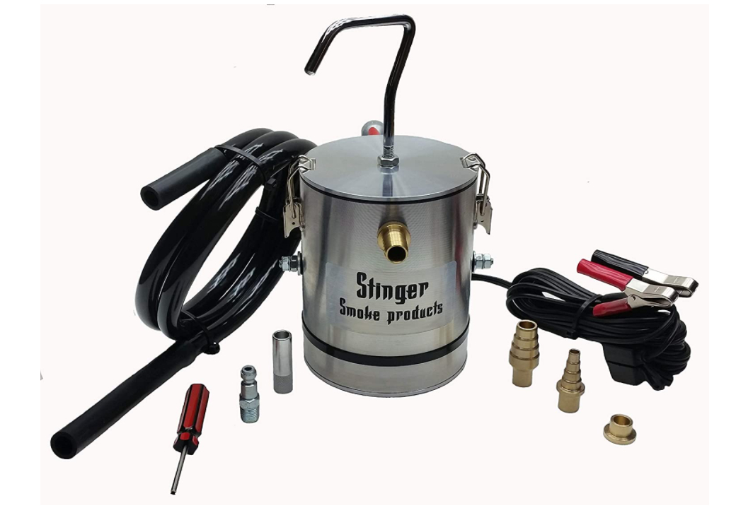

The best way of finding a vacuum leak is by using a smoke tester. A lot of people like spraying brake cleaner or carburetor cleaner to try find a leak but this can be hazardous as these liquids are flammable.
See image below regarding a smoke tester .
How to use a smoke tester:
https://youtu.be/LV2Cx41IccU

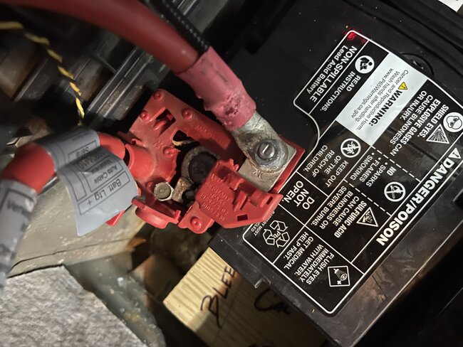

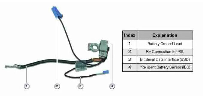

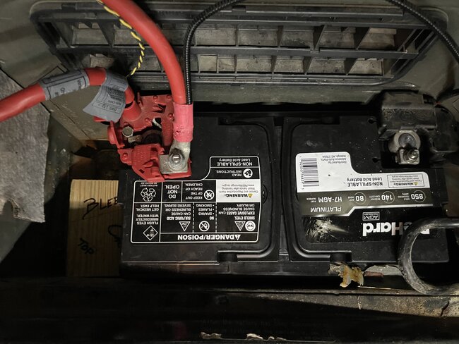

Does the intelligent sensor have a fuse?
Jan 23, 2023 at 1:51 PM
BORIS K
  • 836 POSTS
I have searched a lot of documentation but cannot seem to find a fuse for the power supply for the IBS, intelligent battery sensor.
See image below for the sensor layout.
Cheers, Boris
Jan 24, 2023 at 9:34 AM
BHAMDOC1973
  • 2,007 POSTS
What goes wrong with these? They fail on the inside?
Jan 24, 2023 at 9:36 AM
BORIS K
  • 836 POSTS

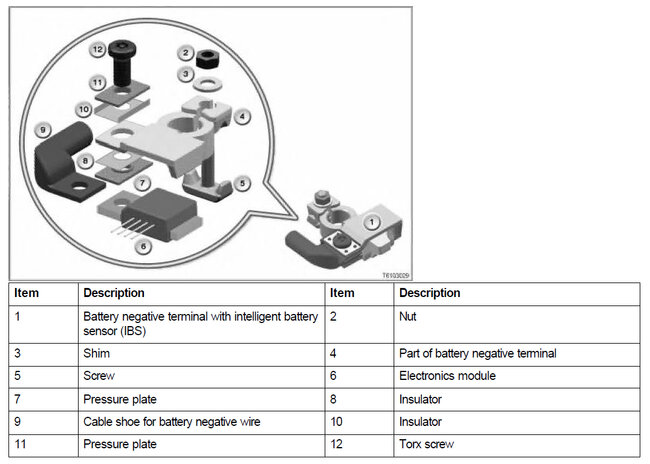

Yes, the IBS fails on the inside.
The intelligent battery sensor (IBS) is an intelligent, mechatronic component that monitors the battery condition.
The power supply to the IBS is provided through a separate wire.
For the purpose of data transmission, the IBS is connected to the digital engine electronics (DME) or digital diesel
electronics (DDE) via the bit serial data interface (BSD).
The intelligent battery sensor (IBS) consists of mechanical components, the electronics module and software.
- Mechanical components
The battery terminal with earth cable is the connection to the negative terminal of the battery and serves
· to create an electrical contact to the body
· as the support for the sensor element for current measurements
· as the support for the electronic module
· to provide an adequate thermal contact between the temperature sensor and the negative terminal of the battery
· as protection for the sensitive electronic module
· as an earth connection for the IBS
The mechanical parts are listed in image 1.

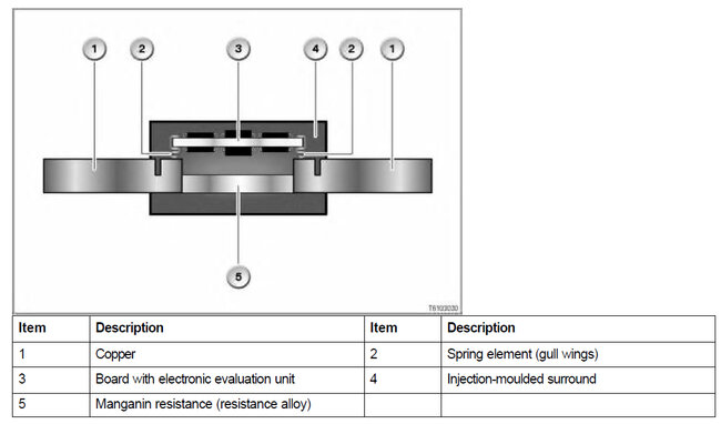

Electronic module:
The electronic module has the task of recording the voltage, the current flow and the temperature of the battery. The
following components are housed in the electronic module:
· a shunt (resistance for current measurement)
· a temperature sensor
· an electronic evaluation unit on a board
The board, which is about the size of a fingernail, contains an electronic circuit for evaluating the data measured.
The intelligent battery sensor (IBS) is able to withstand thermal loads of up to 105 °C and the chemical effect of the battery
acid. The IBS thus satisfies the necessary conditions for installation in the engine or luggage compartment.
The components of the shunt are illustrated below in image 2
