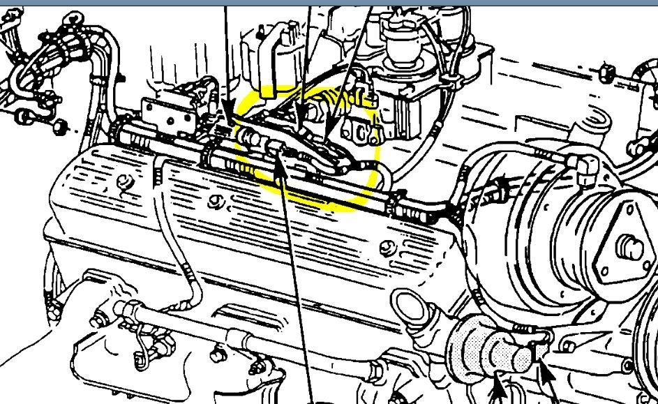

I have the truck listed above that had a motor swap a couple years ago. haven’t had the truck on the road for a while but the swap was from a 1992 Buick road master. I do not have a ESC module, but I replaced the knock sensor and distributor from reading other post that you have comments on. I can’t figure out where to go next, is there a way to tell me if that truck should have the ESC module and maybe it was never put in but I don’t see any plugs in the harness that could say that something is missing? I’m pretty lost on what to do to get rid of this light and If is causing an issue to the vehicle. can you please give me some guidance? Thanks

The module is mounted at the coil. They are in the same bracket.
The ignition module is in the distributor itself.

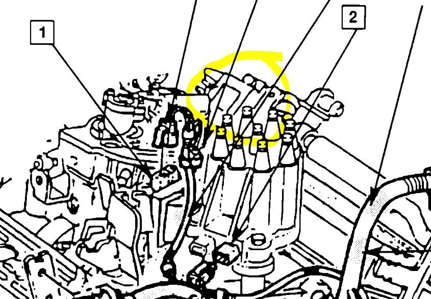

Got it.
I attached two pictures of the location of the module.

See my motor doesn’t have that module in that location and my harness has no wire in that area for the ESC. that was the first area I check is there any other way it would be throwing that code?
Mar 20, 2019 at 4:14 AM
The 43 is for the ESC module or knock sensor module. If it is not there, then it will code.
You could swap engine harness from the other truck and that will eliminate it. Use the ECM from it as well.
