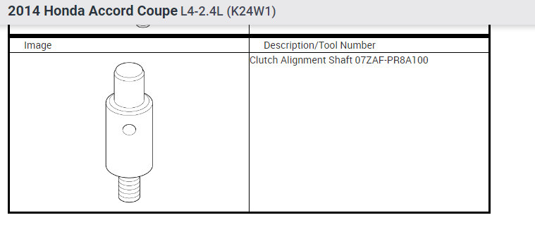

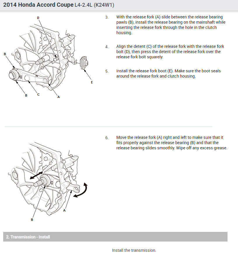

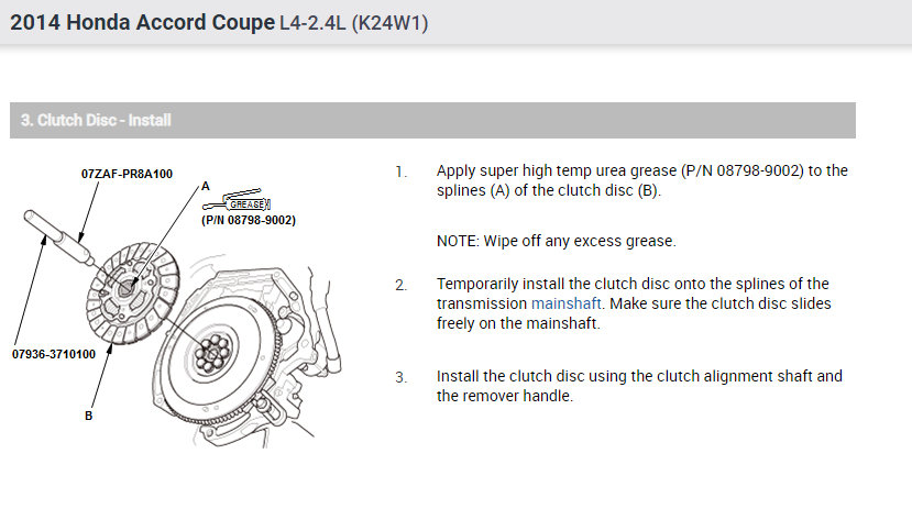

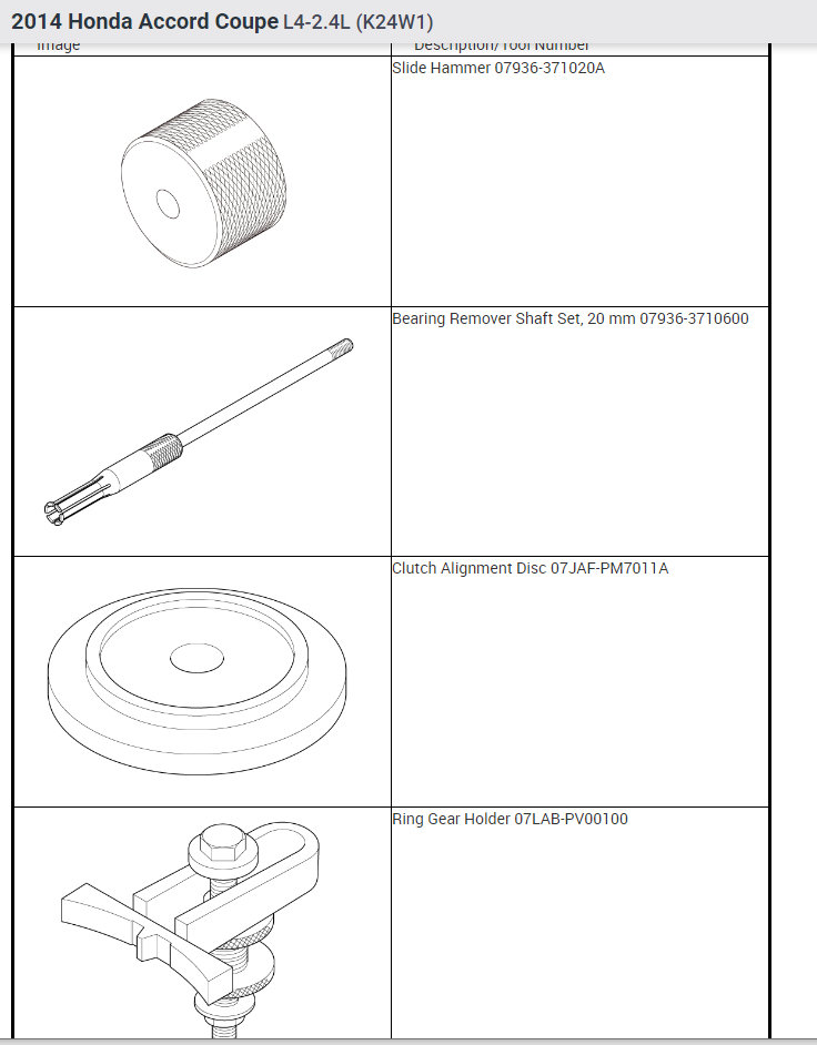

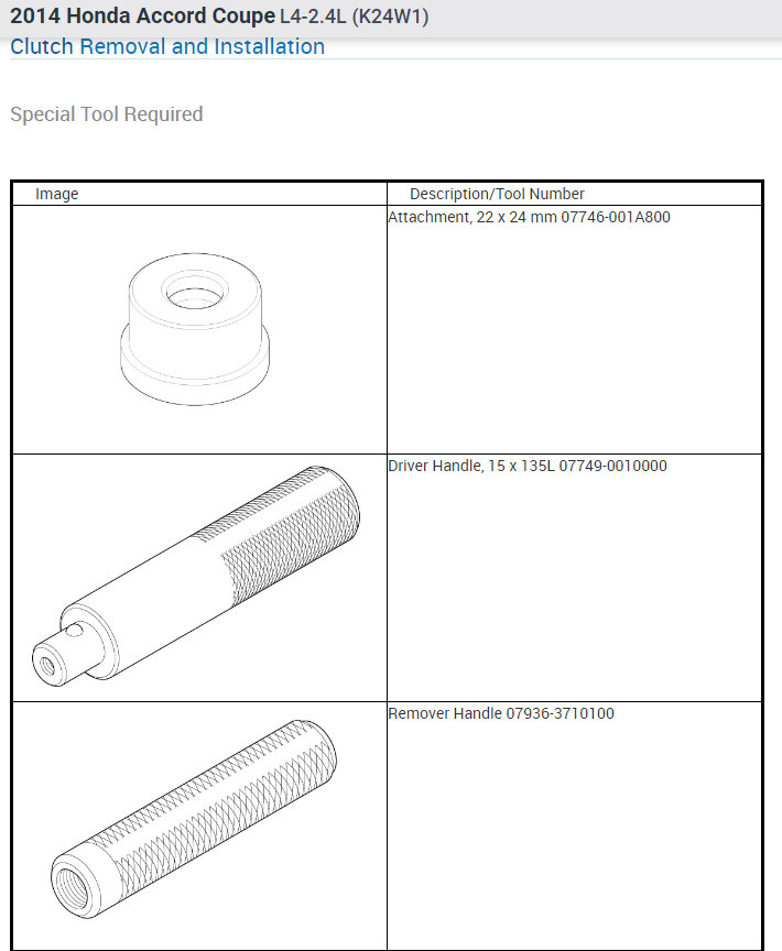

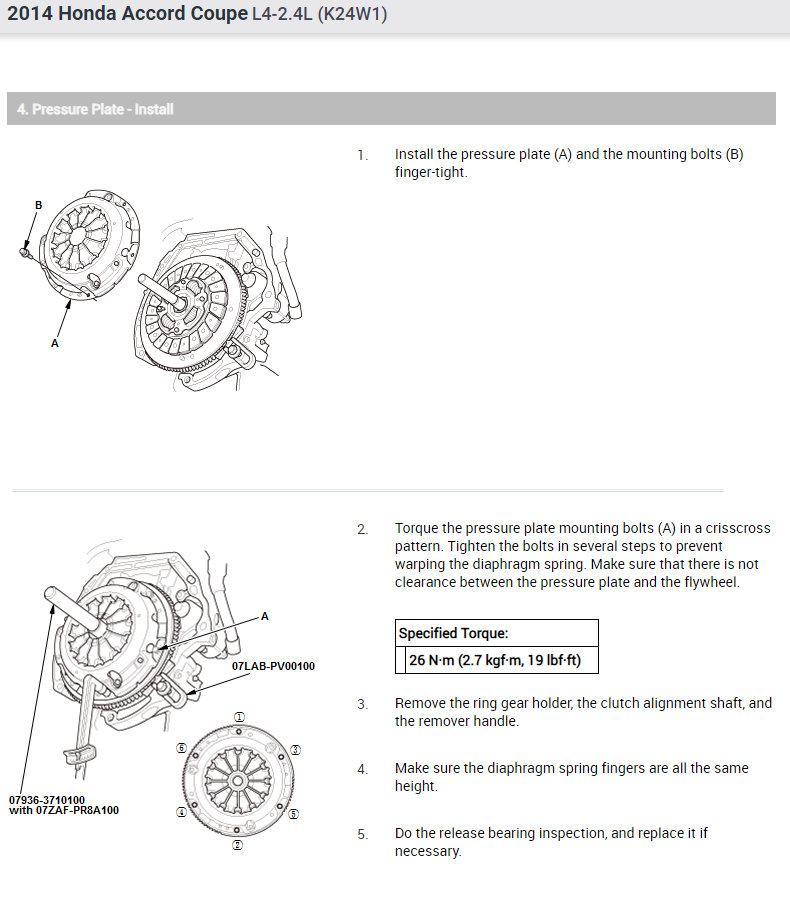

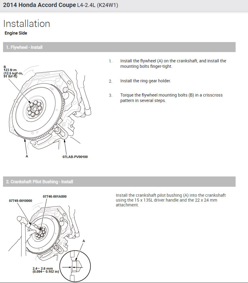

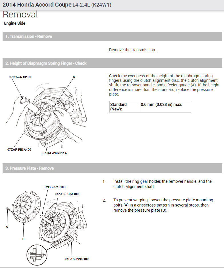

Replacing the clutch is a fairly extensive work and does require some special tools.
Here are the answers to your questions:

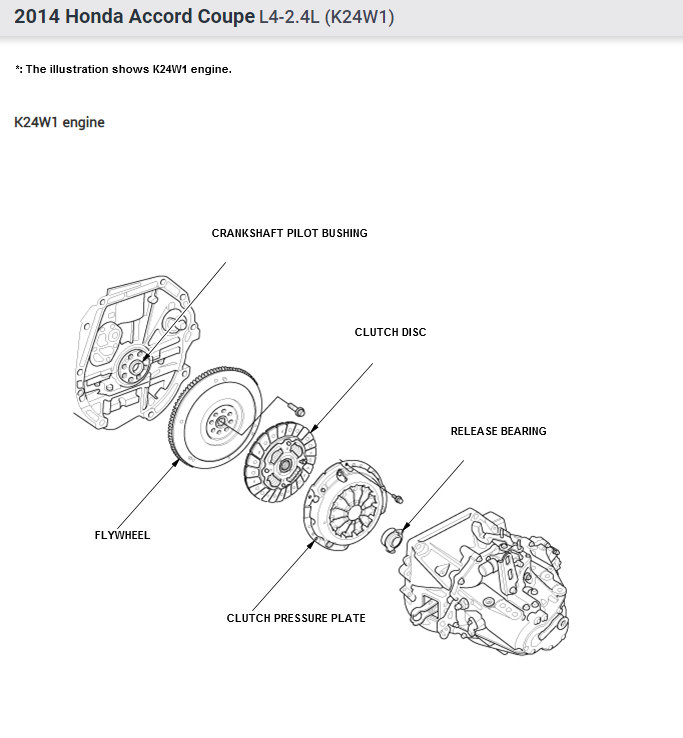

1. Is there any additional part that should be in the clutch kit other than noted?
A. The pars that you noted is all that you will need for a successful clutch kit replacement.
2. What clutch kit brands/manufacturers are recommended?
A. There are few good brand that will work. I have personally used Exedy brand on Honda vehicles in the past and worked very well. You should be able to get a Exedy Pro kit, which will include everything. I think one of those kits comes with the flywheel as well. This are readily available online (amazon, eBay etc.)
3. Same as Q 1 and 2 as to flywheels?
A. Look above.
4. Hours for the work said to be 10-12. Decent time estimate or not?
A. It is a decent time quoted. The book calls for removing the transmission for this job. So 10 hours is reasonable.
5. Suggestions, thoughts, advice, etc. That you think might be important.

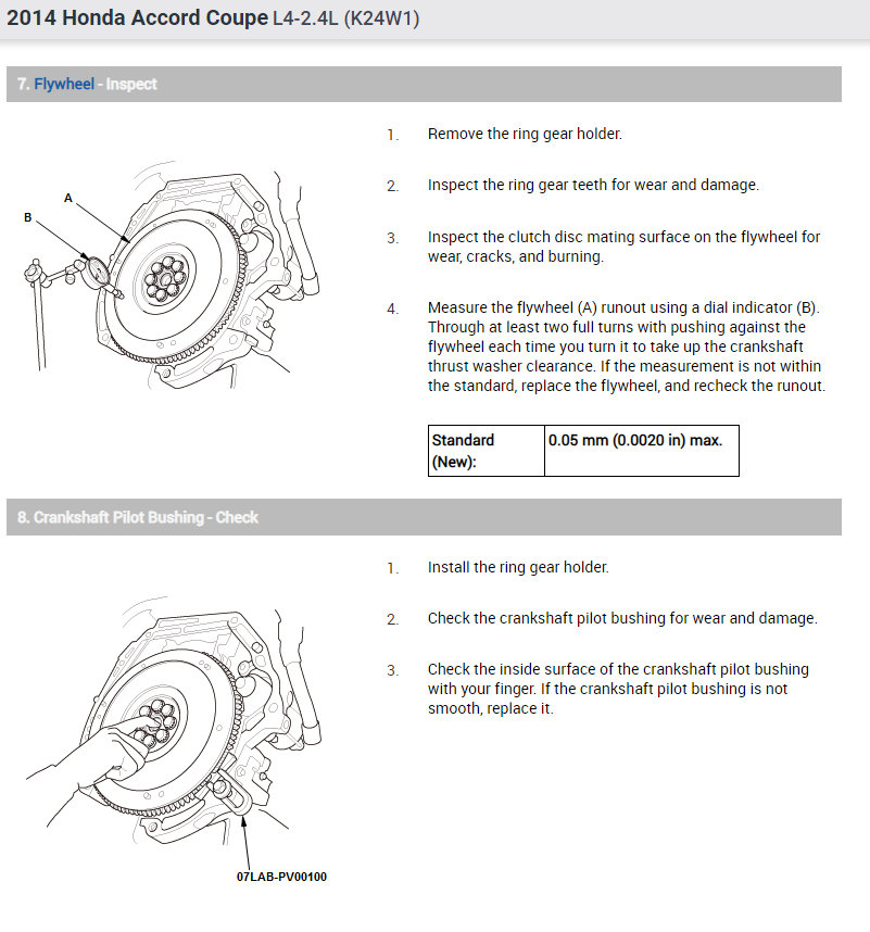

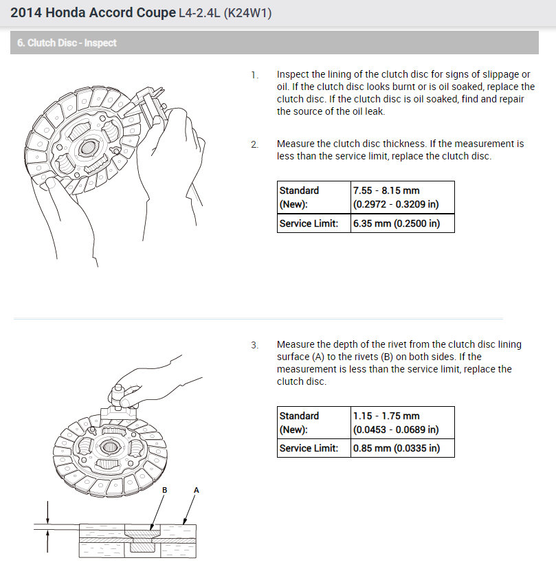

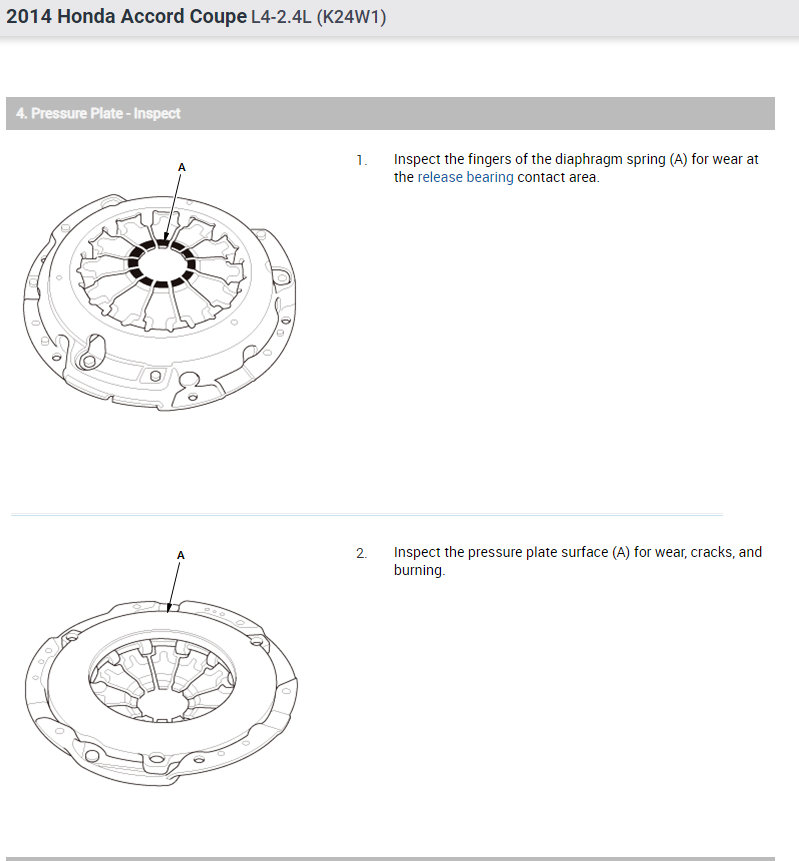

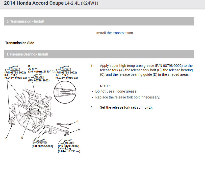

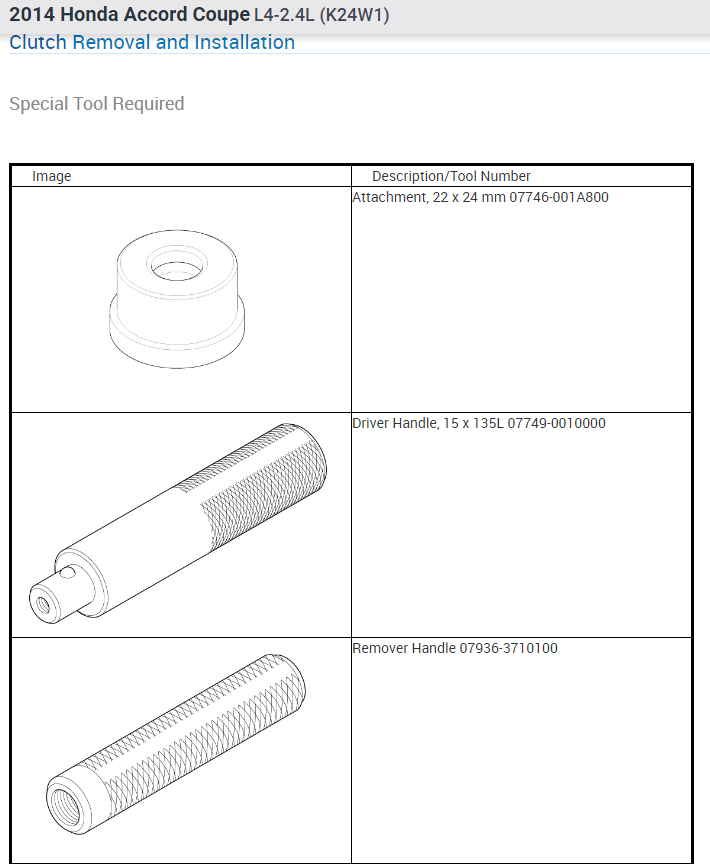

A. This job requires some specialty tools besides the typical wrenches and sockets. If you do not replace the flywheel, get it resurfaced, which can be done at your local parts store or machine shops.
Here is couple of helpful articles:
https://www.2carpros.com/articles/clutch-doesnt-work-sometimes-or-not-at-all
https://www.2carpros.com/articles/throw-out-bearing-replacement

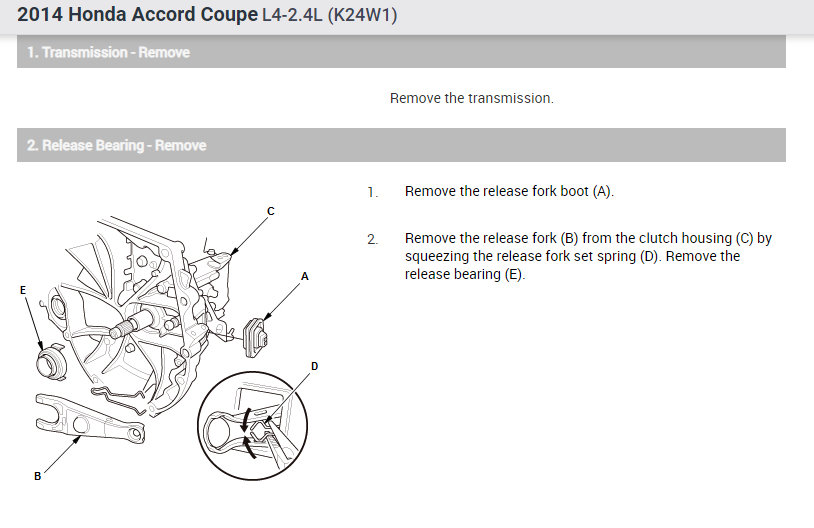

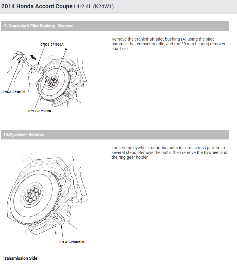

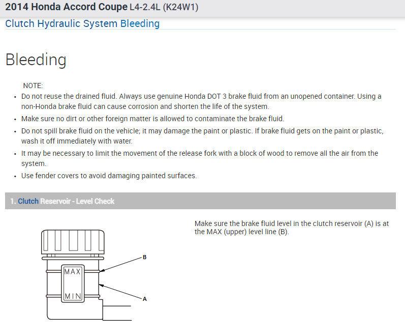

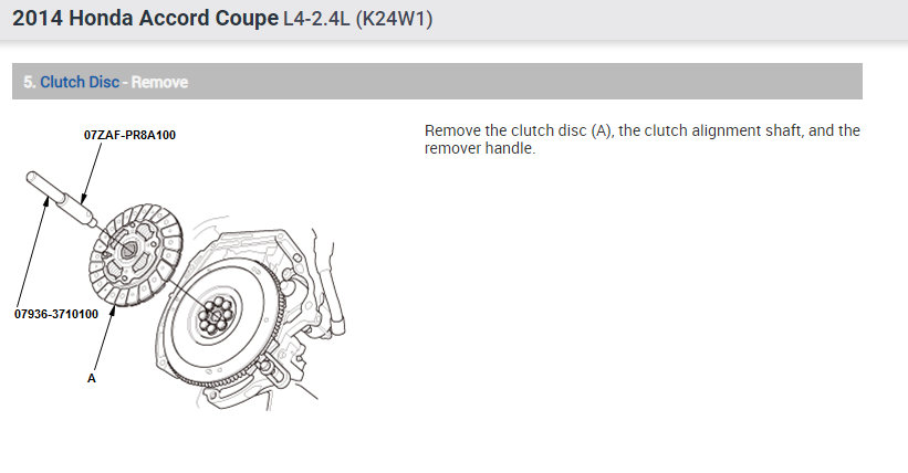

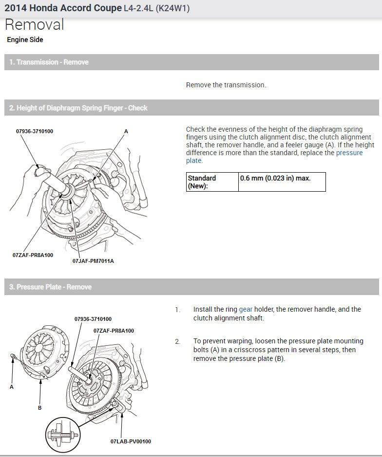

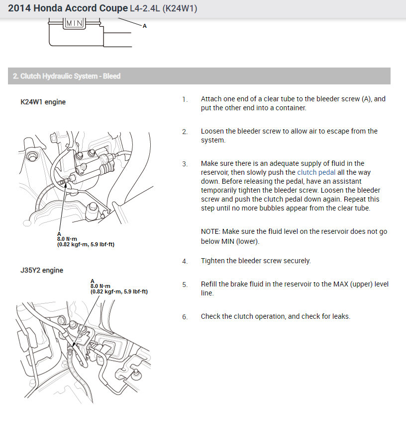

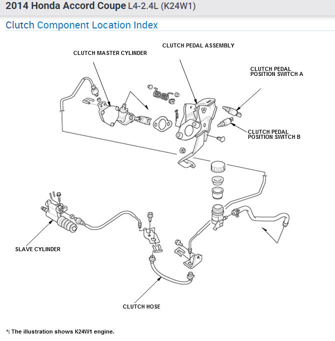

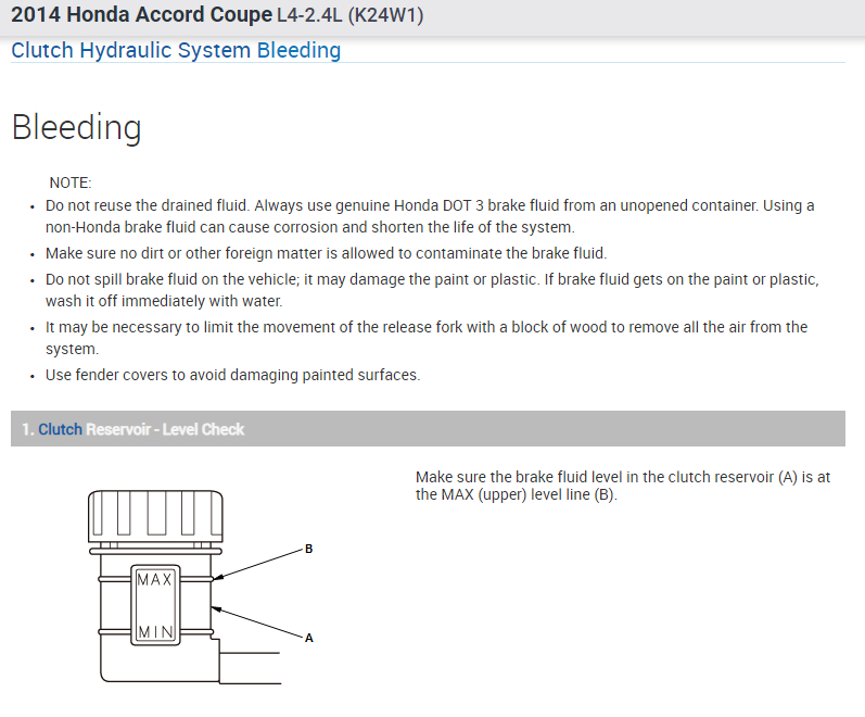

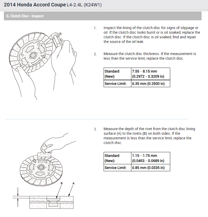

I have included the clutch replacement procedure for your reference.
