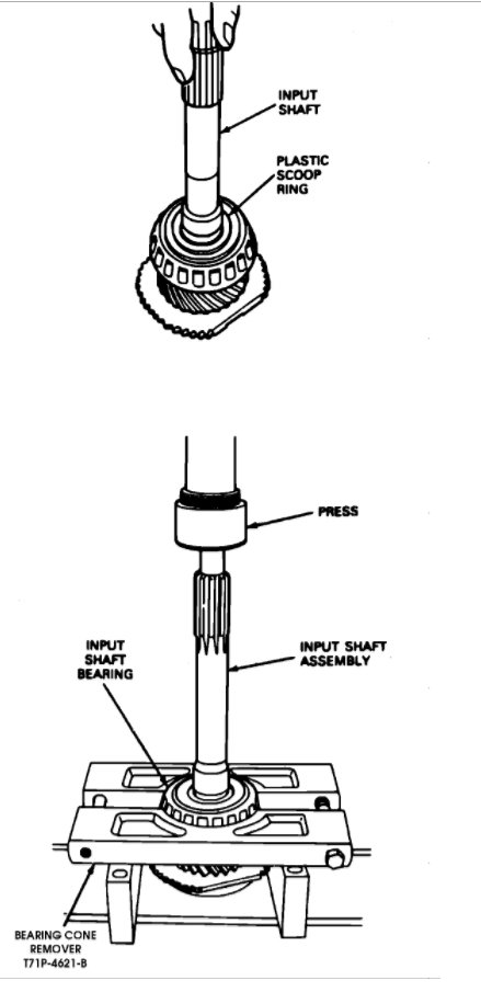

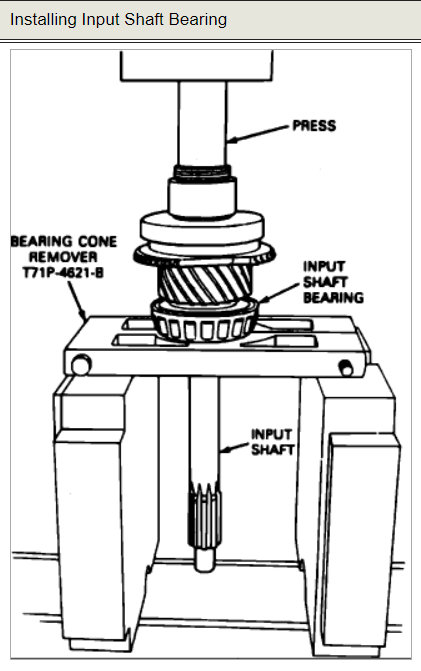

That will do it, the pilot bearing must be in good working order and if the input shaft is damaged then a new bearing wont help and you will need to replace the input shaft. Here is a guide to show you how to replace the shaft. Maybe you can resurface the input shaft or send me a picture of it so I can see if it can be saved.

Ken, thanks for your reply and the pictures of the trans. After seeing the small groove in the end of the input shaft, I got a selection of mini files and worked it to remove and smooth the groove out. I polished it with fine emery cloth and it put a nice finish on it. I put the new pilot bearing on the shaft and it rotates smoothly and has no catch points at all. I also found that there is a front and back side to the pilot bearing. I tried it both ways and found the slightly rounded end allows for it to go onto the tapered end to line it up and the flat end fits tighter to line up and secure the bearings in the cage. As soon as the taper ended and the shaft began, the flat end would not allow any movement for starting it on the shaft but the rounded end would. I've been driving it back and forth to work this week and am getting used to the engagement point on the floor. It releases a little more than 1/2 an inch from the floor and will go into all the gears. Once the new flywheel is delivered and I get time to change it, I'll let you know what the thickness is on the old and new ones are. Thanks for keeping in touch with me on this issue and offering your advice and help, Craig
