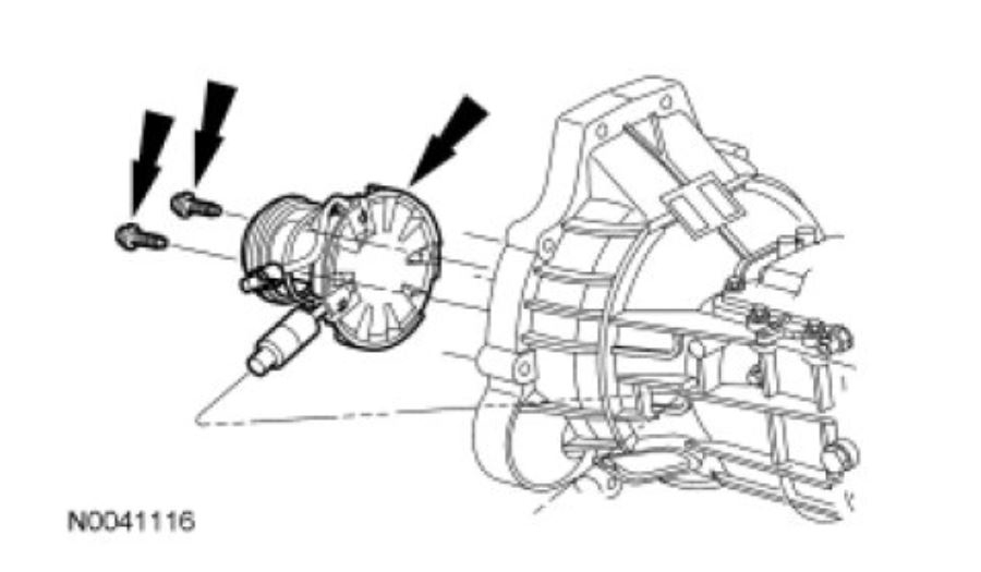

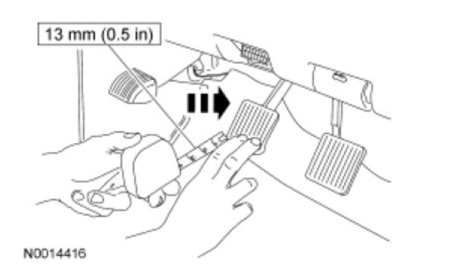

I thought it was the clutch master cylinder so I changed that, but there was no change in the pedal. I looked online about pulling the snap ring and easing the piston out of the cylinder to bleed it so I did that but still n change. I still have a soft pedal and can't get it into gear.
Dec 23, 2019 at 2:15 PM
Good evening,

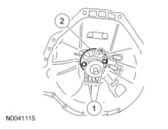

This sounds like the slave cylinder has failed. That is part of the throw out bearing. The transmission need to be removed to access the slave cylinder.
Here is a you tube video of the procedure for you:
https://www.youtube.com/watch?v=8YZf1tktyck
Dec 23, 2019 at 4:18 PM
TANKK2014
  • 29 POSTS
Hey,Roy. Sorry it took so long to respond. I replaced the slave cylinder 9 thanks for the video, it helped immensely) got everything back together, bled the slave cylinder but it still won't go in gear with the truck running. I'm kind of at a loss here.
Jan 4, 2020 at 4:19 PM
Try this bleeding process.
Manual Transmission and Clutch
Pinpoint Tests
Pinpoint Test C: Clutch Pedal Feels Spongy or Has Excessive Travel/Clutch Will Not Disengage

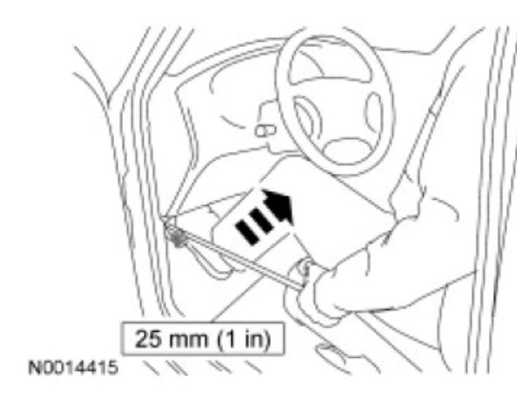

C4 CHECK THE CLUTCH PEDAL RESERVE
NOTE: The clutch reserve is the distance between the clutch pedal when fully depressed and the position when the vehicle starts to move forward.
Park the vehicle on a level surface.
Check for obstructions behind clutch pedal.
Attach a cable tie to the lower clutch pedal.
Attach a tape measure to the cable tie.
Depress the clutch fully and start the vehicle.
Shift the transmission into 1st gear.
While observing the tape measure, slowly engage the clutch, noting when the vehicle starts to move forward.
Is the clutch pedal reserve greater than or equal to 25 mm (1 in)?
The clutch hydraulic system is OK. TEST the system for normal operation.
GO to C5.

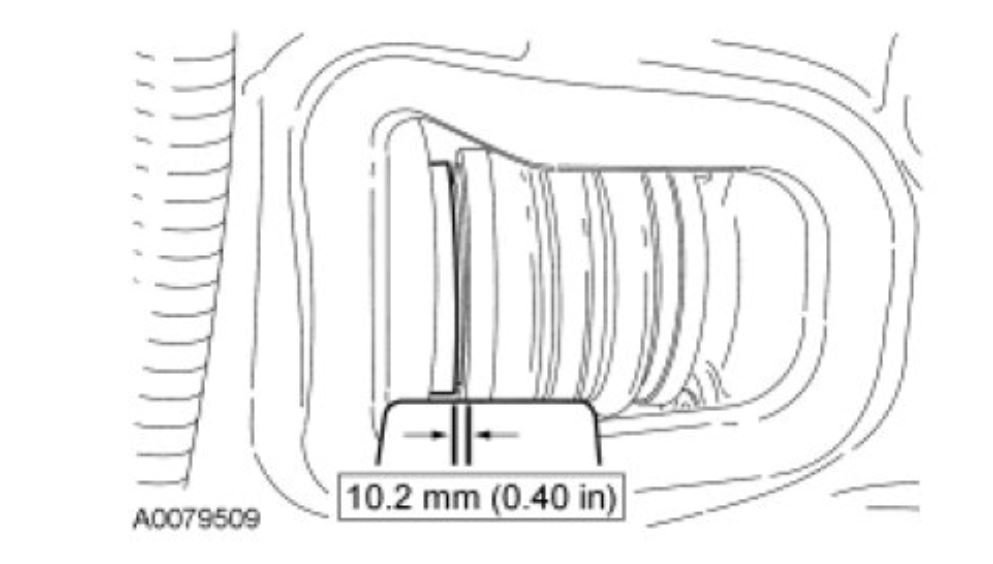

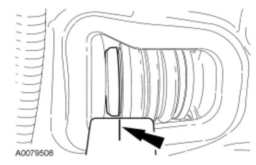

C5 CHECK THE CLUTCH SLAVE CYLINDER TRAVEL
NOTE: The clutch slave cylinder travel is the distance the bearing portion moves forward when the clutch is fully depressed.

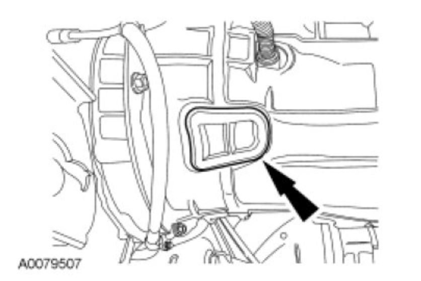

With the vehicle in NEUTRAL, position it on a hoist. Refer to Jacking and Lifting See: Vehicle Lifting > Procedures > Jacking and Lifting.
Remove the inspection plug.
Using a wooden ruler, index-mark the rear of the bearing onto the ruler. Have an assistant fully depress the clutch pedal. Index-mark the rear of the bearing. Measure the distance between the 2 index marks.
Is the clutch slave cylinder travel equal to 10.2 mm (0.4 in)?
GO to C6.
GO to C8.

C8 CHECK CLUTCH PEDAL FREE PLAY
NOTE: The clutch pedal free play is the distance between the clutch pedal when fully released and the position when slight resistance is felt on downward motion.
Engine OFF.
While observing the tape measure, slowly push downward on the clutch pedal until a slight resistance is felt.
Is the clutch pedal free play less than 13 mm (0.5 in)?
GO to C9.
