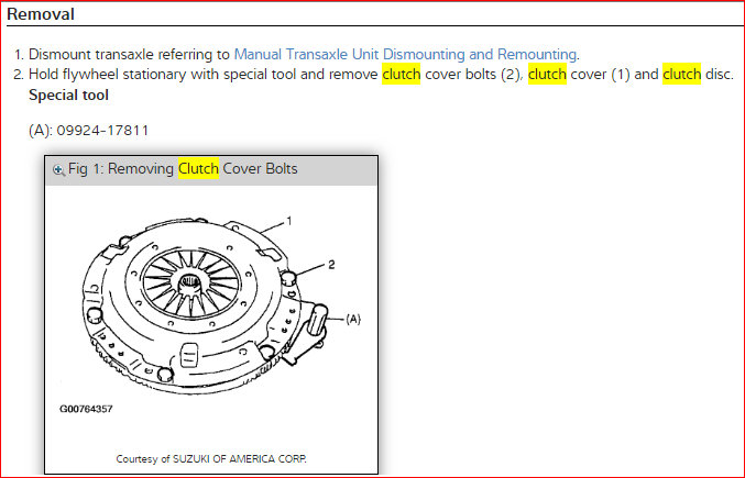

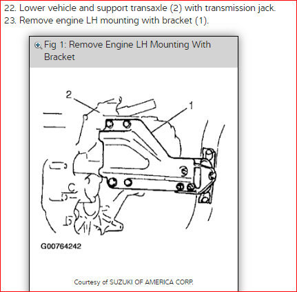

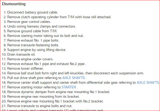

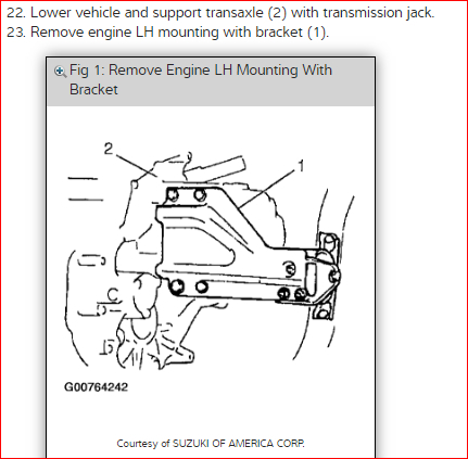

Need to replace the clutch.
Sep 16, 2018 at 2:37 PM
DANNY L
  • 5,648 POSTS
Hello, I am Danny.
I have attached a tutorial on replacement and pictures as a step-by-step instructions for you. You will need to remove transmission to gain access to the clutch (Instructions included with pictures attached. When installing clutch cover it is to be torqued to 17 Ft-lbs. Hope this helps and feel free to ask any questions.Thanks for using 2CarPros.
