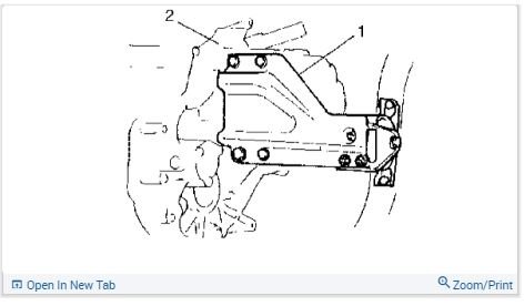

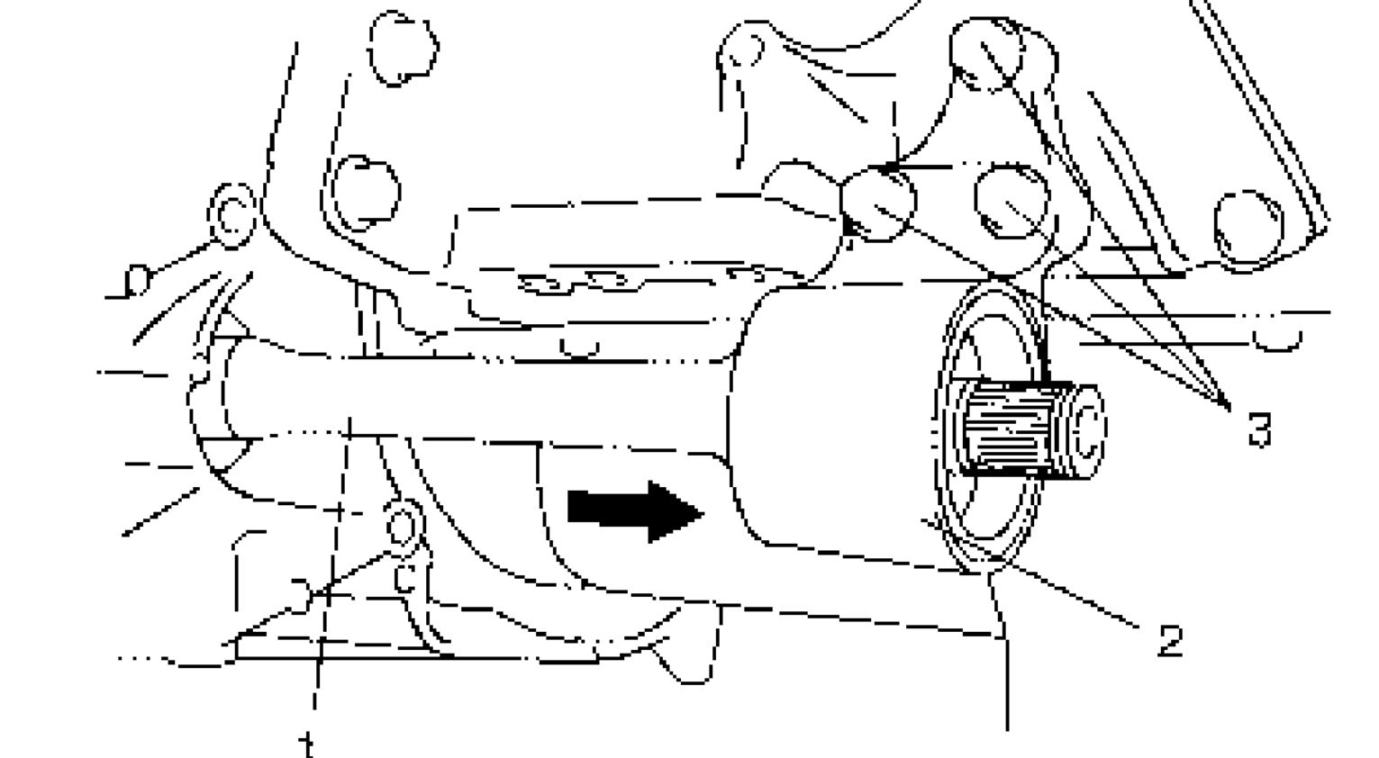

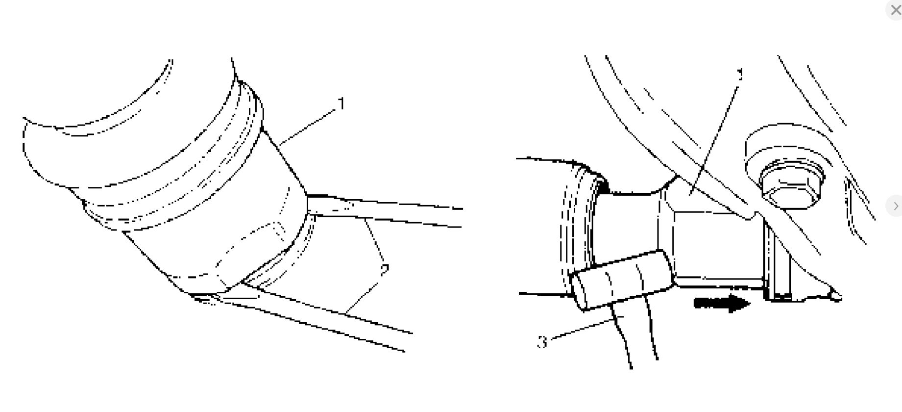

My suzuki Aerio needs a clutch change. It is with a friend who has never worked on an Aerio before (works competently on Nissan z). we are trying to figure out how to drop the (manual) transmission - getting axle out etc. Suzuki technicians either do not want to divulge the process or state that they have not worked on many aerios before. Can anyone walk us through this step by step? Thanks.

6. Using flat head rod or the like (2), pull out drive shaft joint (1) at differential side so as to release snap ring fitting of joint (for LH drive shaft). Using plastic hammer (3), drive out drive shaft joint so as to release snap ring fitting of joint spline at center shaft (for RH drive shaft).
7. Remove center shaft support bolts (3) and remove center shaft support (2) with center shaft (1) from differential side gear.
8. Remove dynamic damper from engine rear mounting No.1 bracket.
9. Remove engine rear mounting from its bracket.
10. Remove engine rear mounting No.1 bracket with No.2 bracket.
11. Remove transaxle to engine bolts and nut.
12. Lower vehicle and support transaxle (2) with transmission jack.
13. Remove engine LH mounting with bracket (1).
14. Remove other attached parts from transaxle, if any.
15. Pull transaxle out so as to disconnect input shaft from clutch disc and then lower it.
