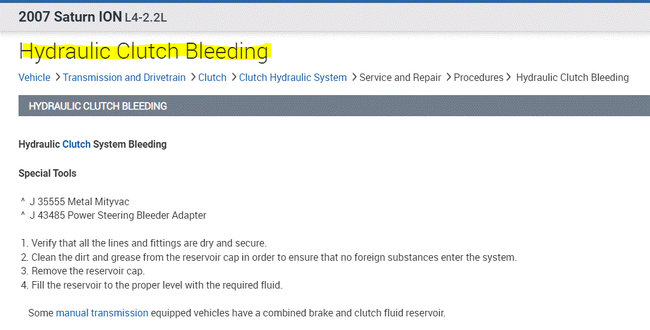

Hello, my clutch pedal was soft straight to the floor and wasn't able to go into gear with engine on. Found a hole in a line on master replaced both the line and master. Pedal feels exactly how it did before the problem, however, it still will not go into gear have tried bleeding the air out countless times and still nothing.

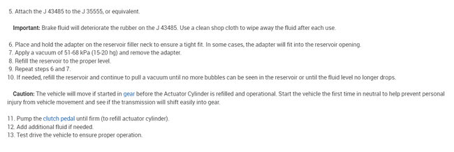

Was everything working properly before the clutch pedal failed? Also, I attached the manufacturer's directions below for bleeding. Take a look through them and see if you missed anything.
