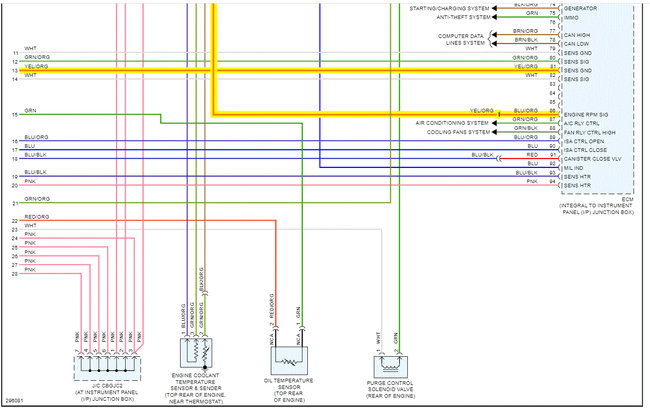

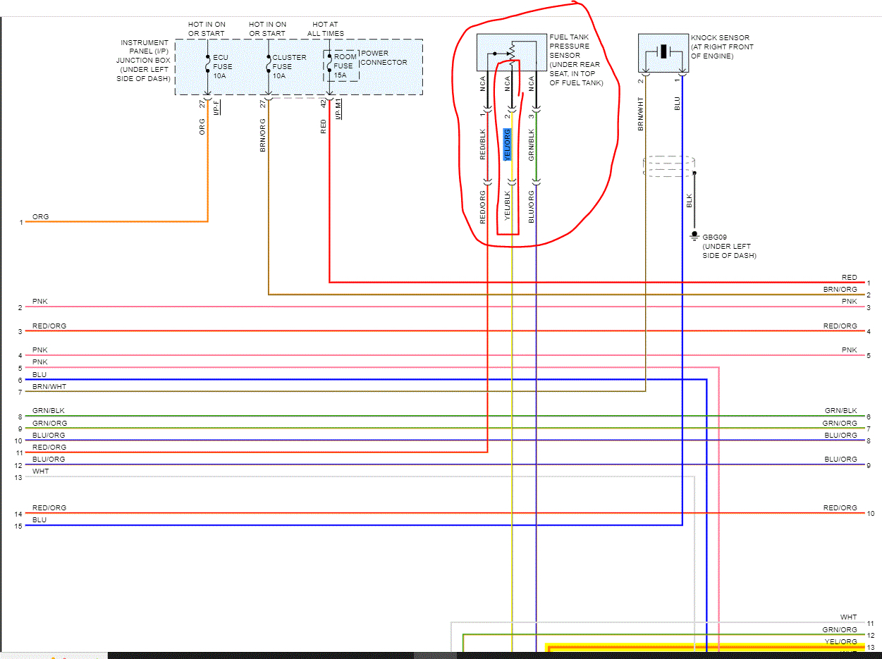

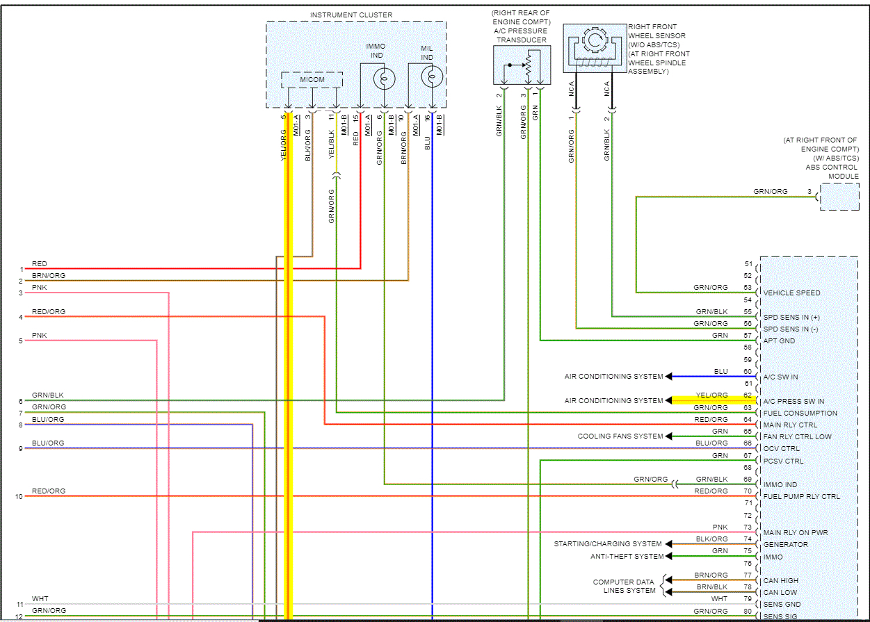

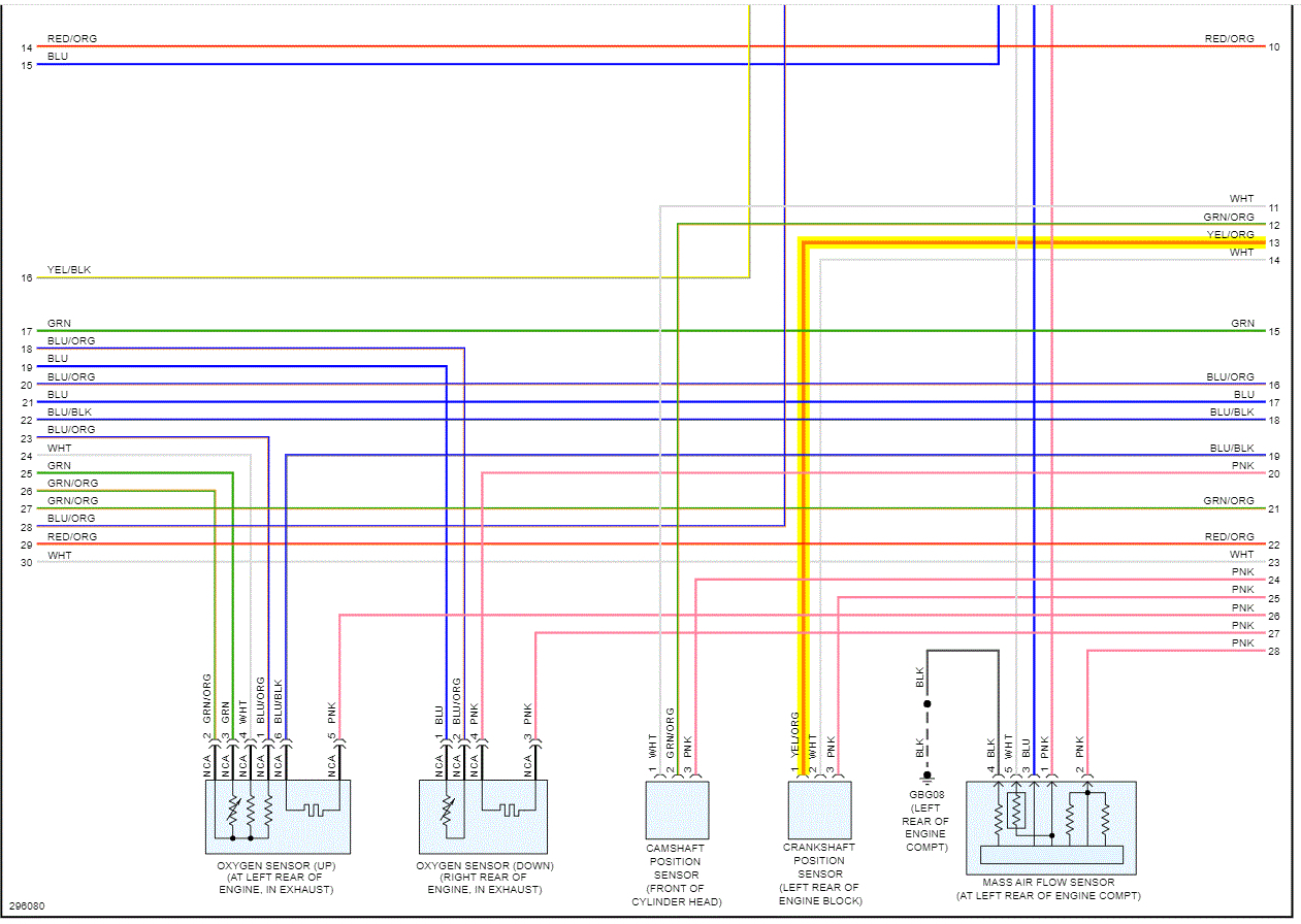

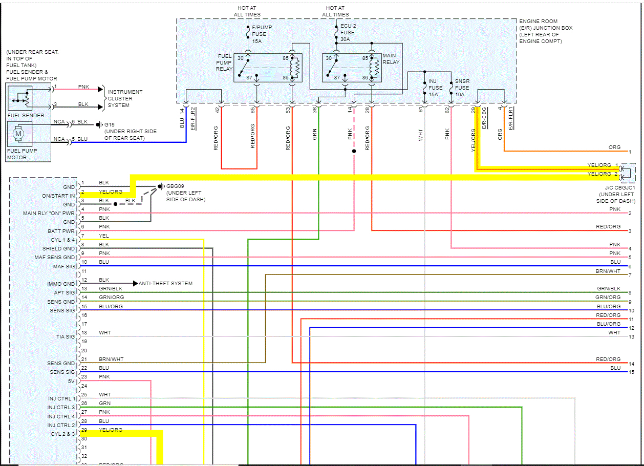

I went through the entire powertrain management schematic and found no 5-pin connector with yellow/orange wires. Additionally, I can find all junction connectors but not JC4. This has me confused.
Take a look at the schematics below. Note the original was three pages. I had to cut each pic in half to make them readable. I did overlap them. Also, I highlighted every yellow/orange wire I could find.
Take a look and see if that helps in any way.
Take care and let me know.

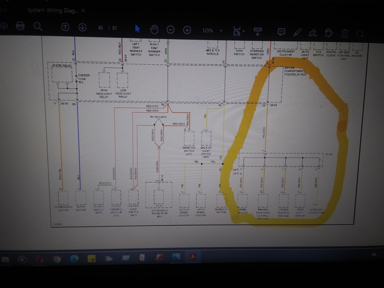

Here is a 5 pin with yellow and orange wires. I have a set of wiring diagrams for this car. Hope this will help.

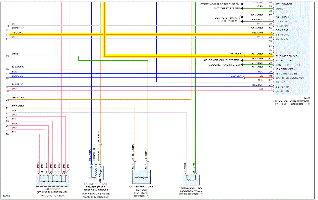

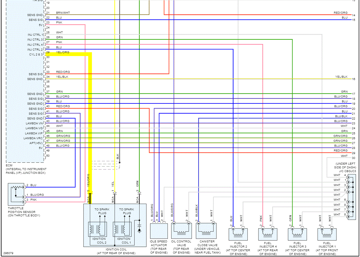

After I looked through the power distribution schematic, that isn't the correct one. There should be an 8-pin connector that controls the CCV. The wires to the connector are all white and it is CBGJC3.
See pic below.

Okay, there are three connectors next to each other, and I believe there's one with all white wires.
When I'm checking the ohms am I checking the wires or the close valve itself?
Saturday, April 30th, 2022 AT 7:23 PM
  • 109,885 POSTS
I would check the wiring. If I recall, you mentioned it was operating when you used a jumper.
