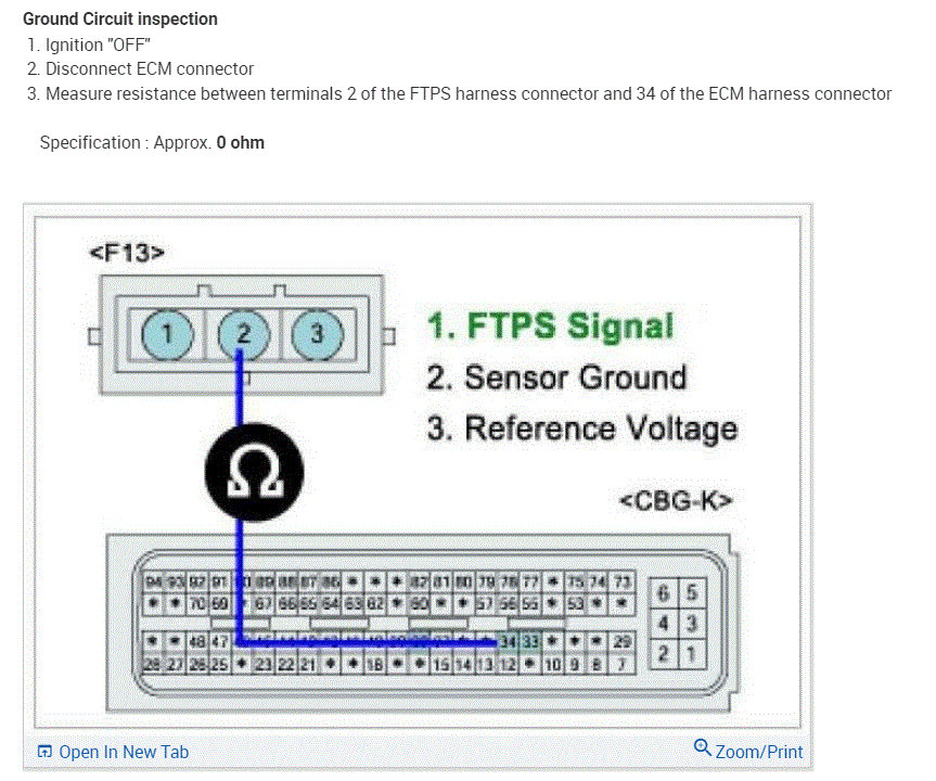

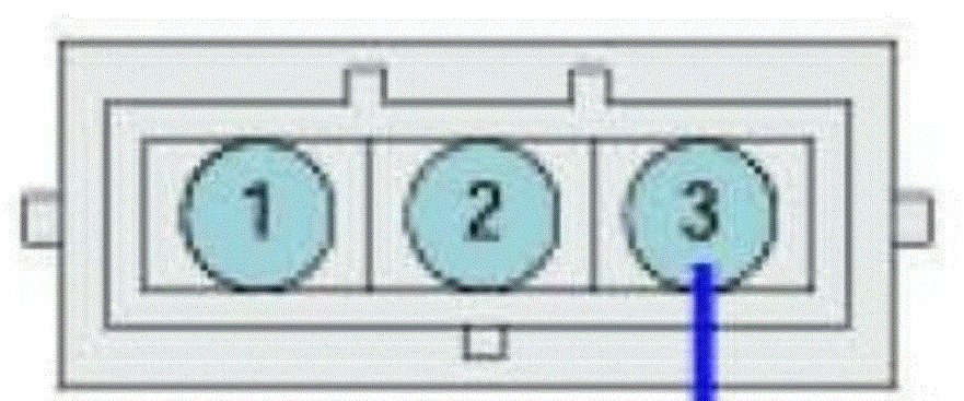

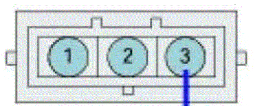

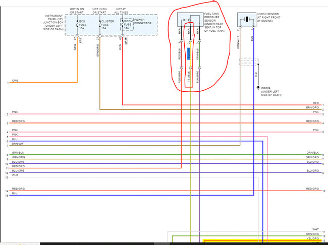

To the best of my knowledge, yes, it should go down. It sounds like the sensor itself may be bad. Take a look through the pic below and confirm the voltages I mention are shown at each pin.
A) Key on engine off: Measure voltage between terminal 3 of the FTPS harness connector and chassis ground. You should have 5v.
B) Key on engine off: Measure voltage between terminal 1 of the FTPS harness connector and chassis ground. You should have 0V.
C) Key off: See pic 2 below for directions for signal ground.
Let me know if that is what you are getting. Note: Pic 1 is the connector pinout.
I will watch for your reply.

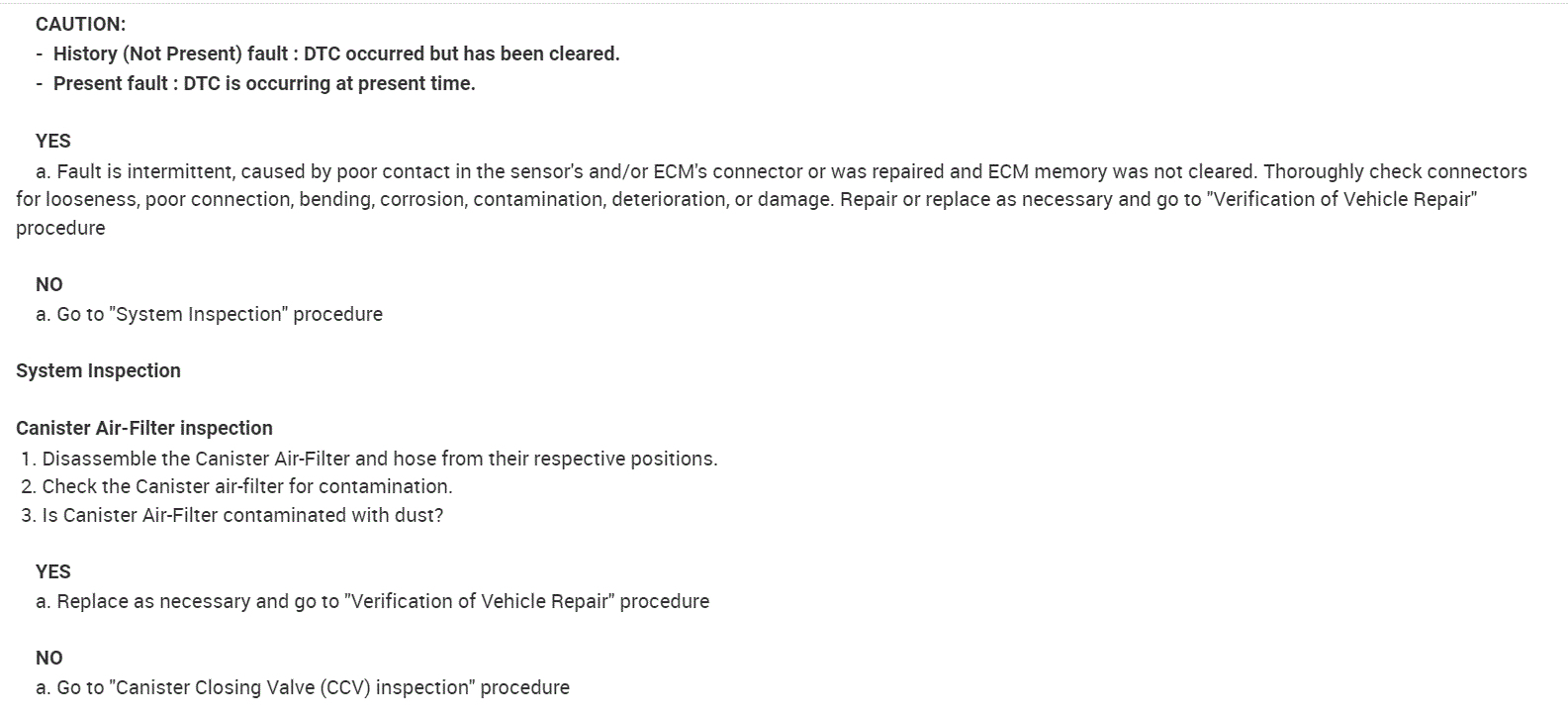

  • 110,236 POSTS

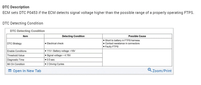

If everything checks good, there has to be a leak. Since you are not noticing anything that appears to be leaking, at this point you need to smoke test the system.
Basically, smoke is injected into the evap system at a very low pressure. If there is a leak, smoke should exit at that point
You need a smoke machine to do this. I don't know if parts stores have anything like this to rent. You may need to have it done at a shop if you don't have the tool.
If the sensor checks good, the connections between the sensors are accurate, it should work. So, there has to be a leak.
The code itself indicates signal voltage is too high from the FTPS. To me, it sounds electrical, but everything is passing.

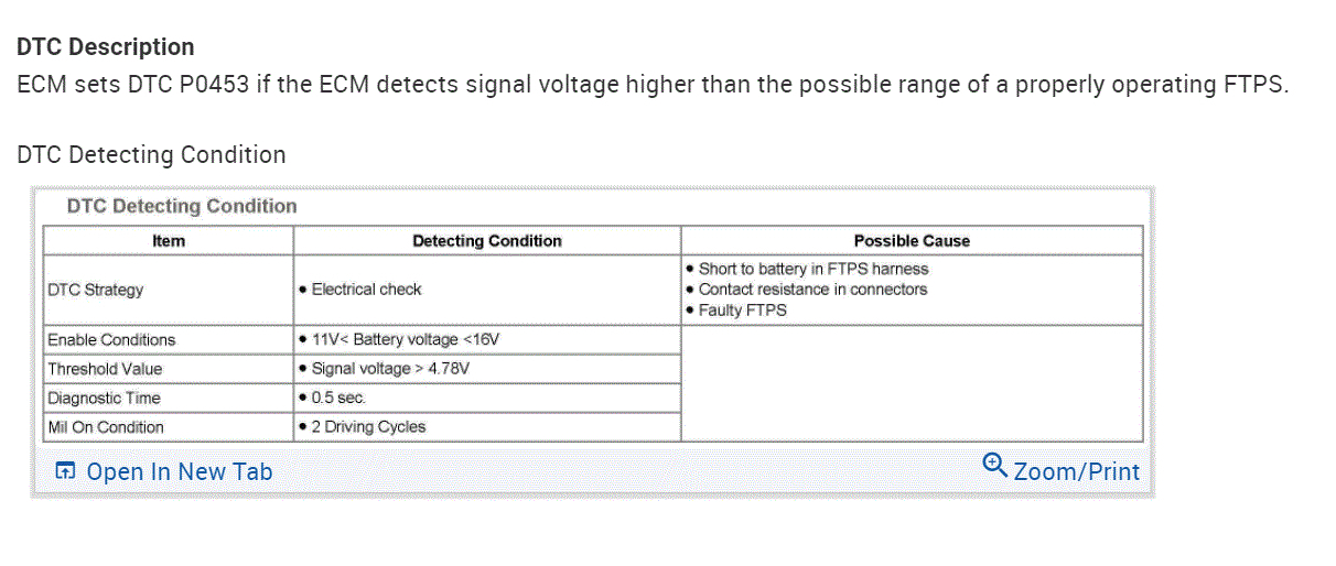

Look at the pic below. It indicates the code, what it means, and what are the possible causes.
Let me know your thoughts.
See pic below.
Apr 20, 2022 at 12:02 PM

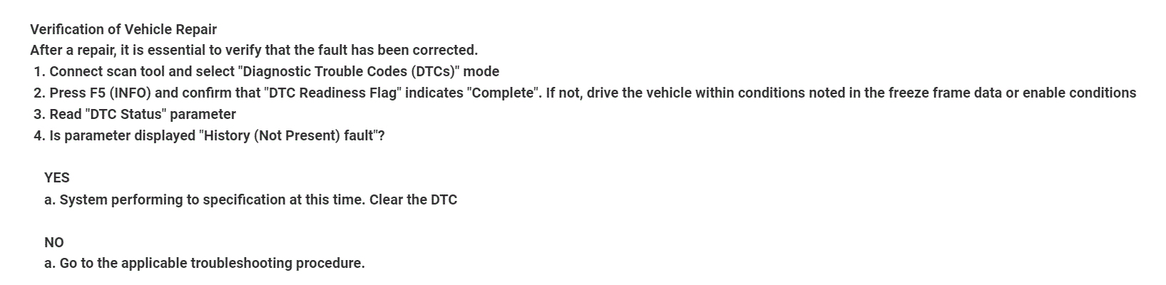

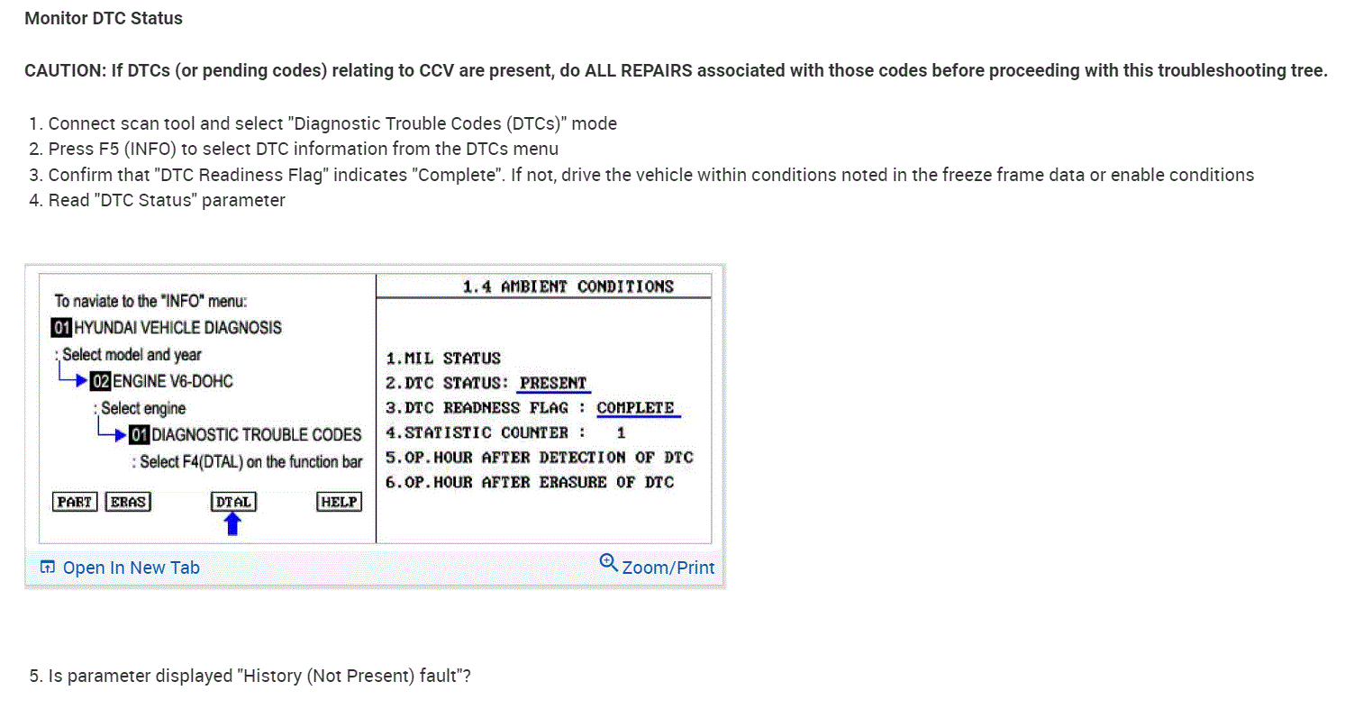

Okay, Joe, i ran the check you gave me and had 0.34 ohms. so, i ran a new wire from the ECM to the pressure sensor and now have 0.00 ohms. The po543 went away. now i have a po449. I replaced the vent valve so I'm assuming it's either another wire issue or the ECM.
Do you have a check i should do for this one?
Apr 21, 2022 at 8:34 AM
  • 110,236 POSTS
It certainly seems like that is a good possibility.
I attached the diagnostics below for the P0449. It walks you through checking resistance and all checks.
Apr 21, 2022 at 9:52 AM

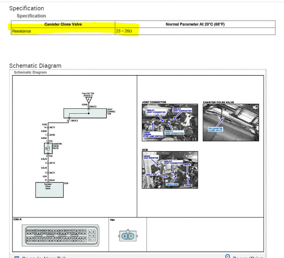

Okay, Mr. Joe, i have 00.5 ohms at best, what now, replace the wire?
Apr 22, 2022 at 7:13 AM
  • 110,236 POSTS
That is what I would at least try. It sounds like you may have found it again.
Let me know if that takes care of the issue. I'm interested in knowing.
Apr 22, 2022 at 11:45 AM
RD66
  • 61 POSTS
Okay, i ran a temporary wire from the ECM connector to the vent valve connector. I'm still reading 00.5 ohms. I did find something though. A few months ago, i replaced the vent valve and the canister. I just ran a hot and a ground from the battery and the valve is not closing. I put another one in it and its holding vacuum and its closing, but it didn't solve the po449. Some of the hoses and clamps have been replaced and there don't seem to be any clogs.
I'm stumped! What next?

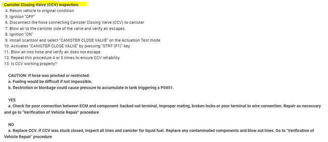

Did you delete the code, and it came back? I ask because of this. The Canister Closing Valve (CCV) closes off the air inlet into the canister for leak detection of the evap system.
If it wasn't closing, that would set the 449. P0449 is set if pressure is lower than the predetermined threshold which could result from the vent valve being stuck open.
Apr 22, 2022 at 1:46 PM

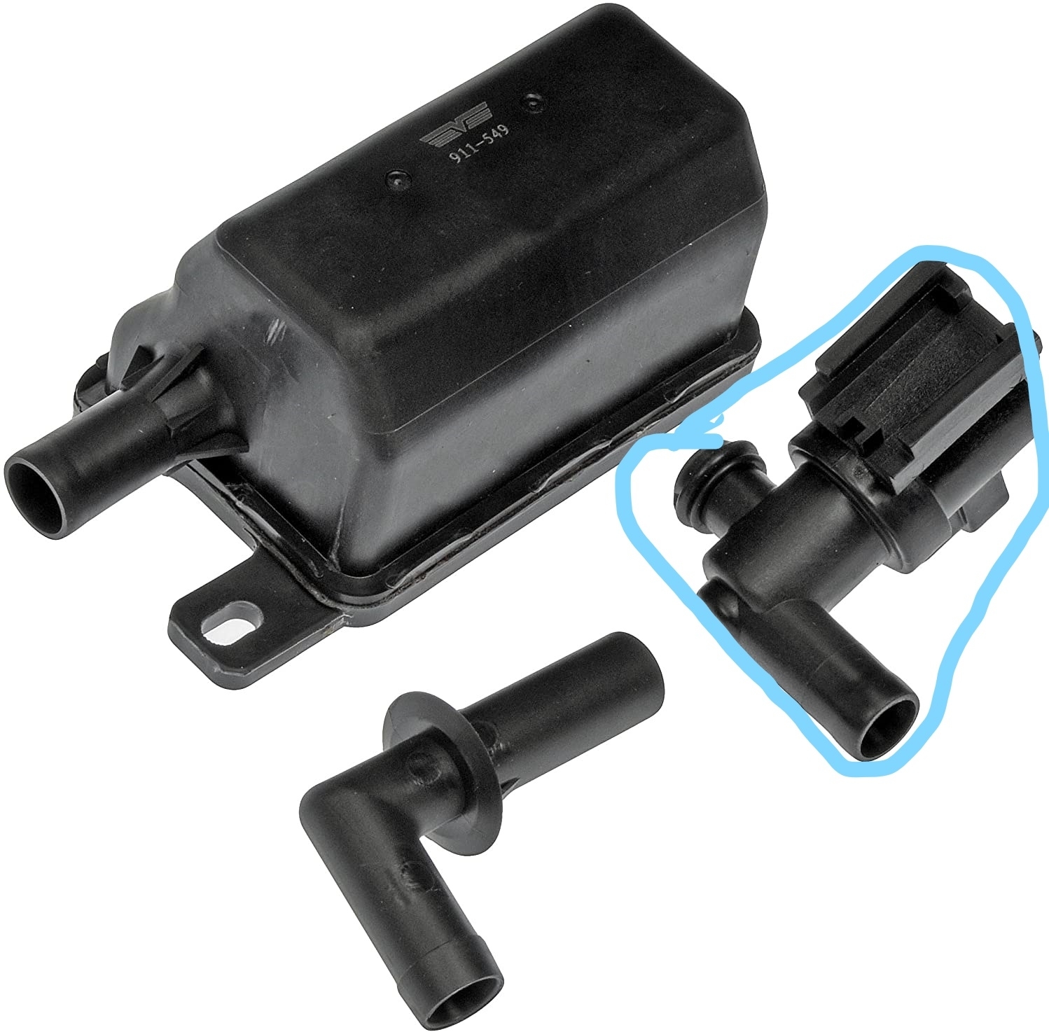

This is my (CCV) with it off the car, when i apply vacuum does both ends need to be sealed?
Apr 22, 2022 at 2:04 PM

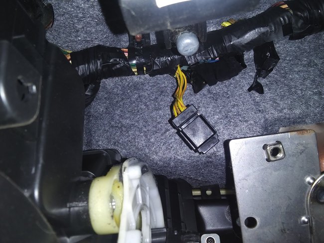

RD66
  • 61 POSTS
Is this it ?
Apr 25, 2022 at 11:18 AM

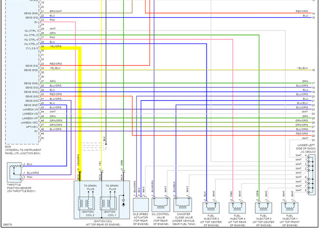

  • 110,236 POSTS

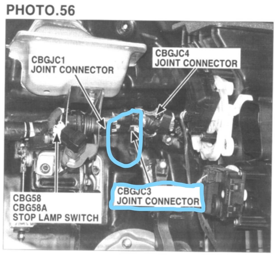

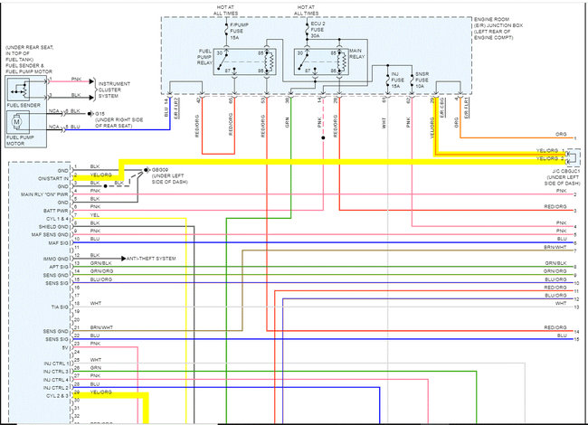

How many wires are going to the joint connection? Are they all solid yellow? Interestingly, I found every joint connector on the vehicle except CBGJC4. I am trying to confirm the wiring color in the schematics to make sure you have the correct one. However, I believe you do. However, other J/C's are yellow with an orange tracer, so let me know.
Apr 25, 2022 at 11:54 AM
RD66
  • 61 POSTS
There are 5 wires all yellow with orange tracer.
Apr 25, 2022 at 2:21 PM

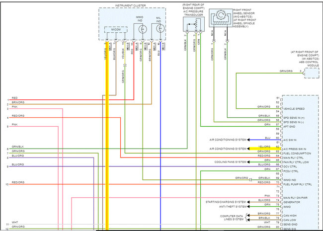

  • 110,236 POSTS

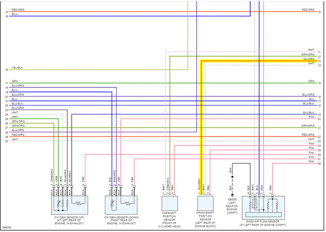

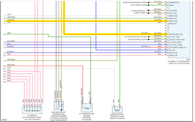

I went through the entire powertrain management schematic and found no 5-pin connector with yellow/orange wires. Additionally, I can find all junction connectors but not JC4. This has me confused.
Take a look at the schematics below. Note the original was three pages. I had to cut each pic in half to make them readable. I did overlap them. Also, I highlighted every yellow/orange wire I could find.
Take a look and see if that helps in any way.
Take care and let me know.
Apr 26, 2022 at 9:50 AM
RD66
  • 61 POSTS

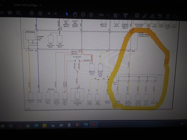

Here is a 5 pin with yellow and orange wires. I have a set of wiring diagrams for this car. Hope this will help.
Apr 29, 2022 at 3:21 PM
  • 110,236 POSTS
After I looked through the power distribution schematic, that isn't the correct one. There should be an 8-pin connector that controls the CCV. The wires to the connector are all white and it is CBGJC3.
See pic below.
Apr 30, 2022 at 12:12 PM

Okay, there are three connectors next to each other, and i believe there's one with all white wires.
When I'm checking the ohms am i checking the wires or the close valve itself?
Apr 30, 2022 at 12:23 PM
  • 110,236 POSTS
I would check the wiring. If I recall, you mentioned it was operating when you used a jumper.
