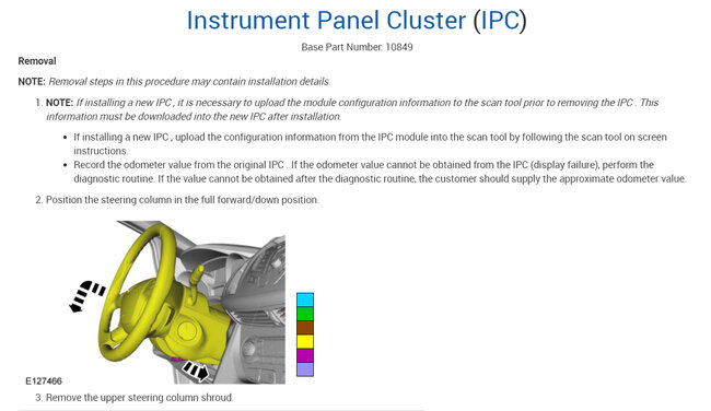

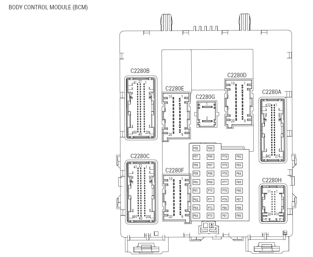

Cluster gauge no working no speedometer information center is on but doesn't show anything. Also, ABS and traction control light is on and no power steering.
Feb 5, 2023 at 2:36 AM
  • 55,421 POSTS

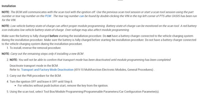

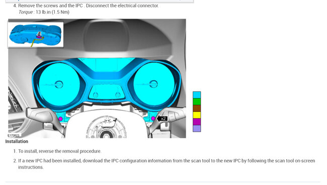

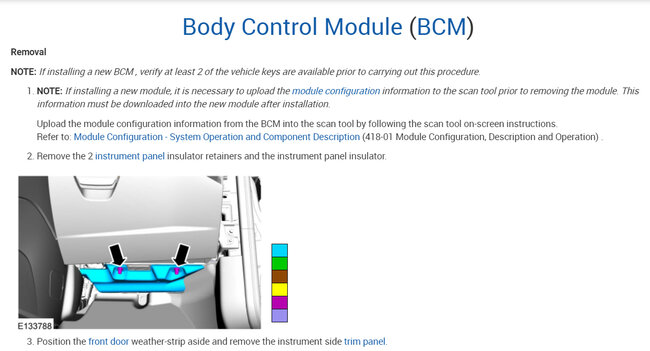

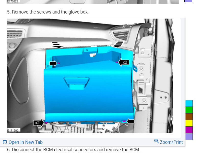

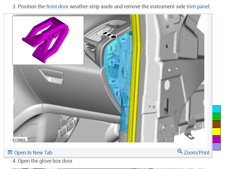

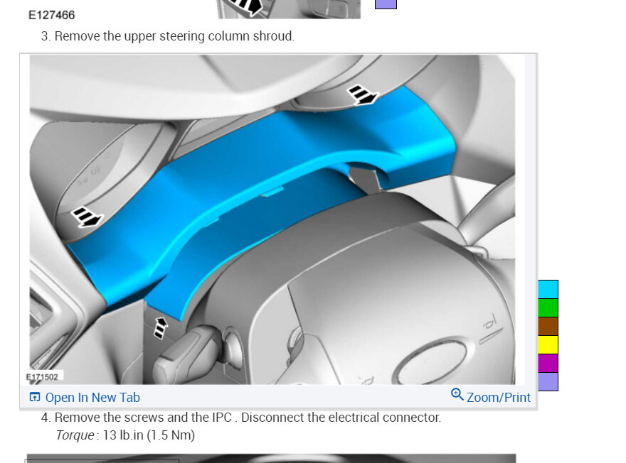

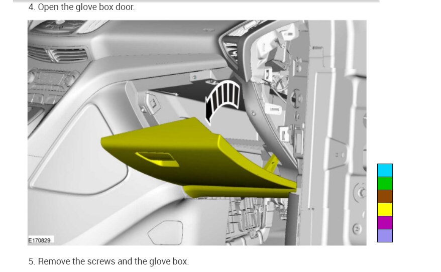

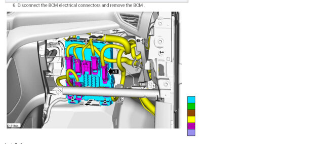

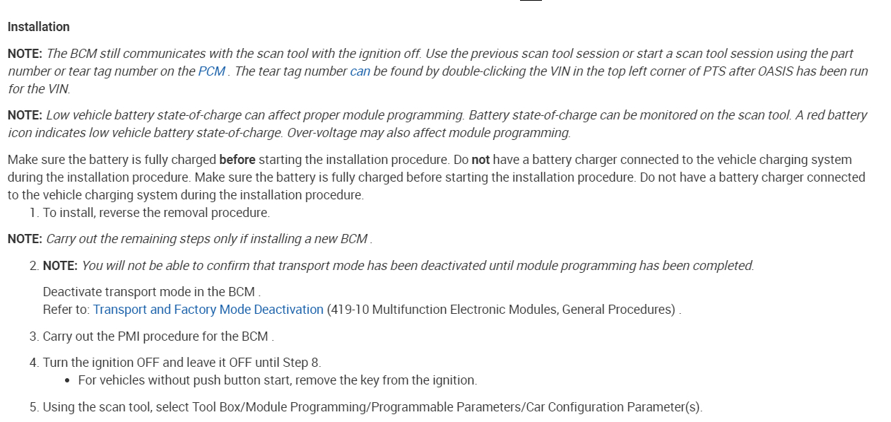

It sounds like the instrument cluster has gone out, but we need to check the fuses #78 and #69 at the fuse panel under the dash on the driver's side. Also, it could be the BCM that when out as well, we should run a CAN scan if the fuses are good to confirm the failure. You can get a CAN scanner (Controller Area Network) from Amazon.
https://youtu.be/u-4syLc-ifQ
and
Here is a list of CAN scanners starting at about $25.00 on Amazon:
https://amzn.to/3DBMlc7
here is how to check the fuses and I have included the fuse location and how to change out the cluster and BCM in case we need them. You can get a preprogrammed unit by searching Google or Ebay. Check out the images (below). Please let us know what happens.
