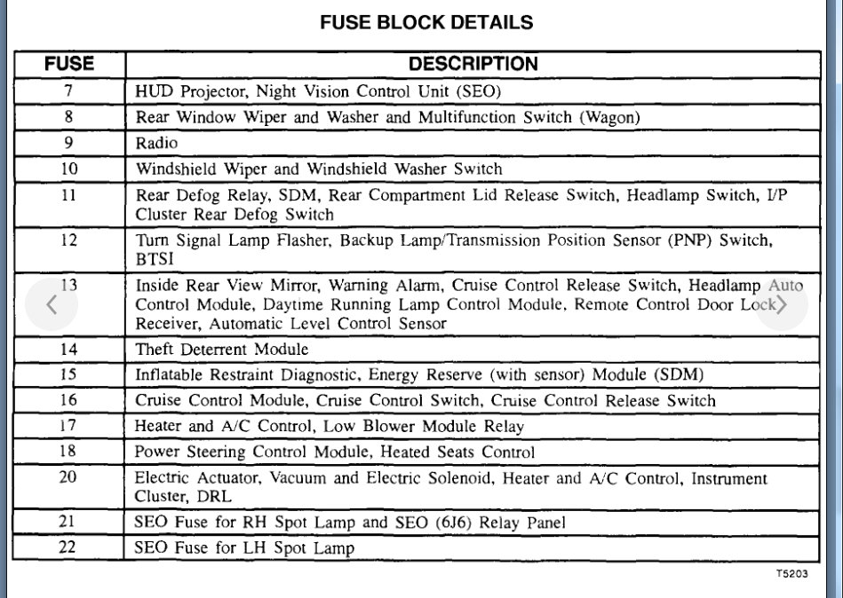

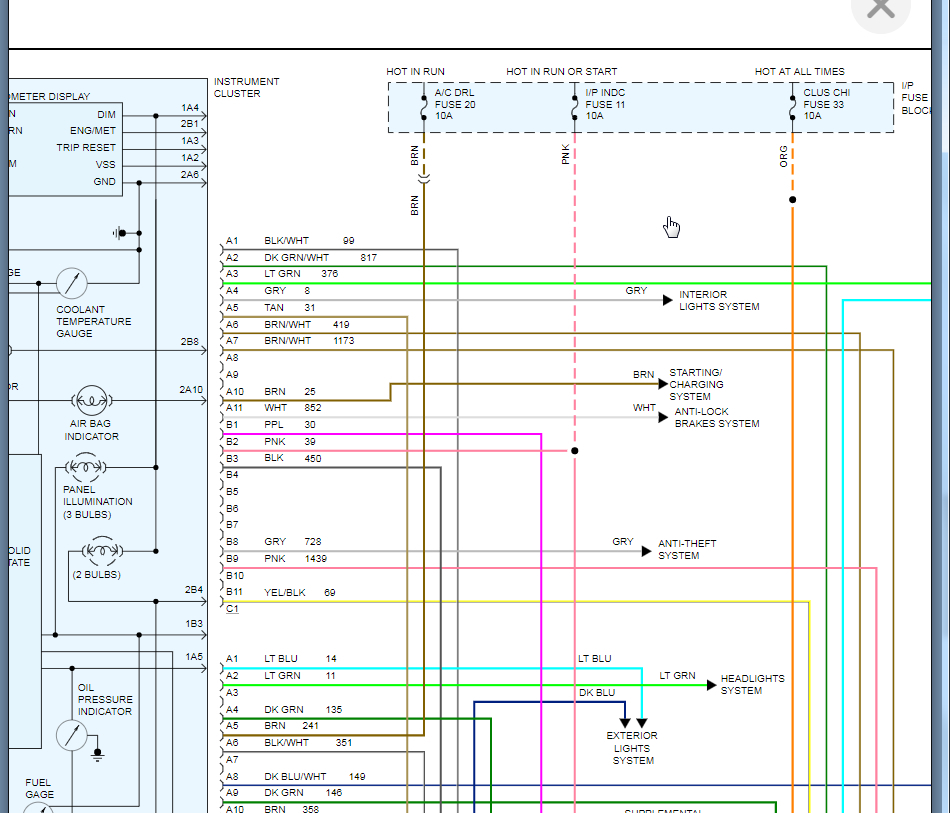

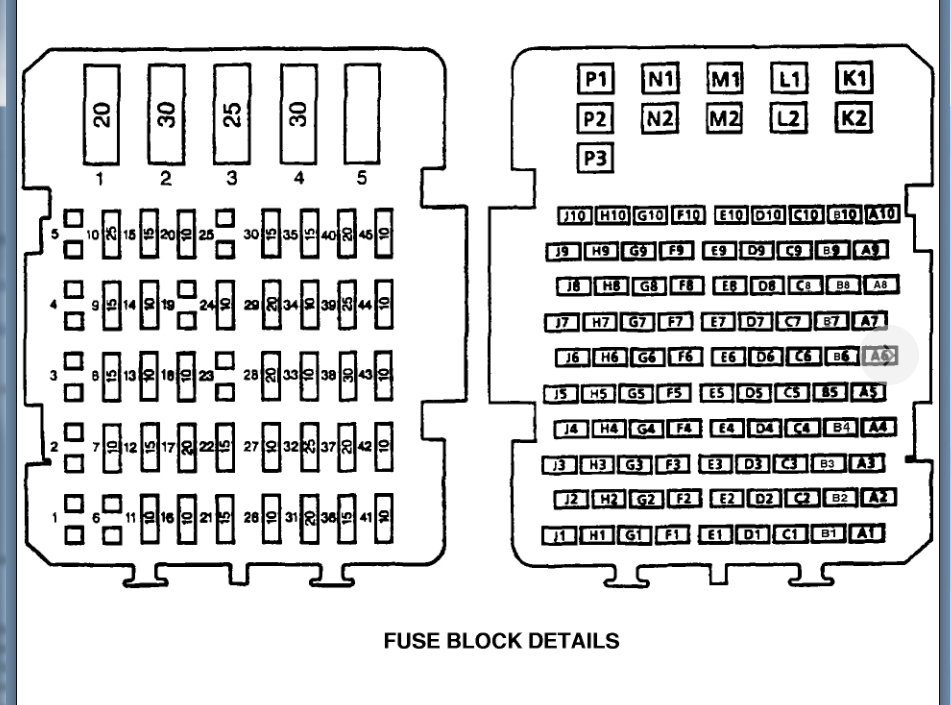

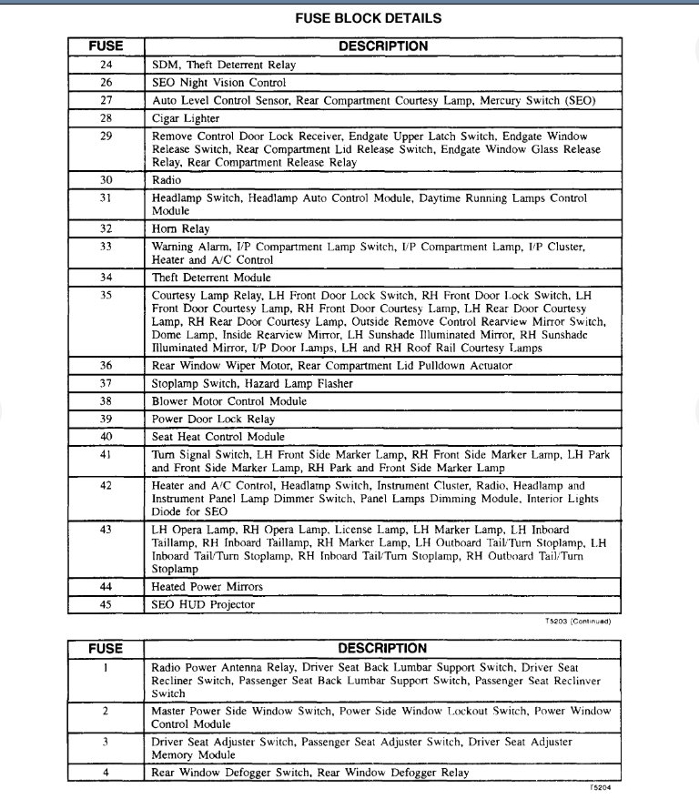

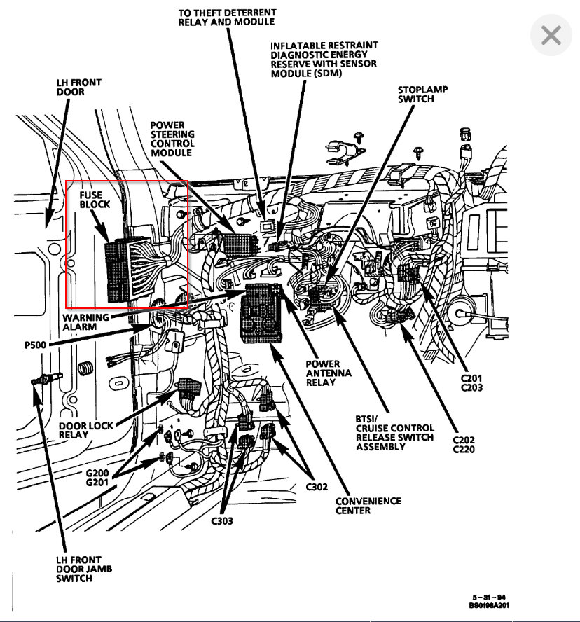

I attached the wiring diagram and location of the IP fuse block. There are no relays but there are fuses. Let me know if you have any questions but the fuses are number 11, 20, and 33.
