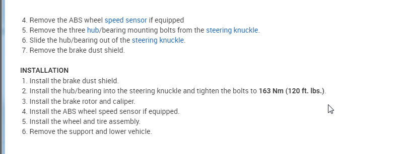

I recently changed the front brakes and rotors on my truck listed above 1500. I had a worn hub bearing so I replaced it as well. Ever since these parts have been changed, when I apply the brakes, a clunking sound comes from passenger side front. I didn't torque the hub bearing because I couldn't find the torque specs for it. I don't hear the noise unless going at real slow speed when applying brakes. If a tie rod end or ball joint or control arm bushing would be worn. It seems like I'd hear it when I run over a bump or a pothole. Which I don't. So what do you think is doing this? If you have the torque specs for brake guide pins and hub bearing, I can torque them to see if that solves the problem. Thanks for your help.
Oct 1, 2020 at 11:17 AM

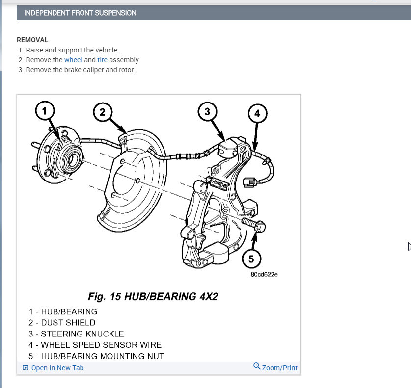

I would bet the hub is the noise. I attached the process for the 2WD. This is pretty high torque so if you didn't torque it then I would not go any further until you do.
Let us know what happens and if that does not solve it, you may need to inspect it to make sure there is no wear on it now. Also, can you get a recording of it if that doesn't fix it?

Sounds great. 120 ft lbs is pretty stout for a hub so I bet that will at least make a difference. Thanks we will wait to hear back.

I just want to make sure you gave me the correct torque specs for my truck. It's a Didge Ram 1500, quad cab, two wheel drive, 4.7 ltr engine. I just want to make sure.

I torqued everything to the specs.. i don't hear the clunking sound as loud but it's still there.. i will change hub bearing on opposite side and see if it stops. It has a slight "growl" when turning with being jacked up.

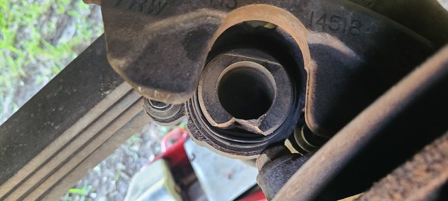

I was going to change my rear brakes and found this. One of the front calipers is almost just like it.
Oct 4, 2020 at 4:42 AM
I am not sure I understand. Was there a picture that was supposed to be attached? Sorry I am just not sure what you are referring too.

Yes, I attached a picture of one of the rear brake calipers. I'll try to send it again.
Oct 4, 2020 at 11:45 AM
SWEETIE1965
  • 180 POSTS
It finally uploaded. Well anyway, this is one of the rear brake calipers. I remember T least one front calipers is pretty much the same. I know they need to be replaced.
Oct 4, 2020 at 11:49 AM
Oh my. That surely makes sense why they are noise when applying the brakes. Great catch. Let us know how it turns out but it looks like you found it.

I can't afford to replace them all at once but I can replace two at a time. First front because 70% of stopping power comes from front brakes. Then I'll replace rear calipers.
