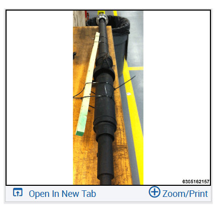

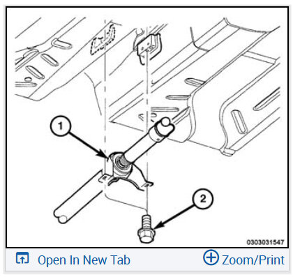

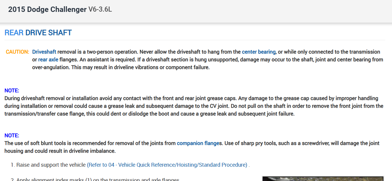

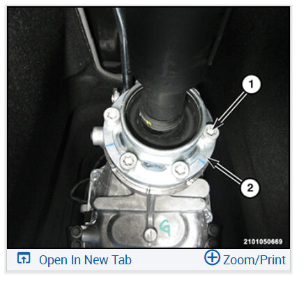

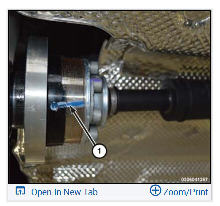

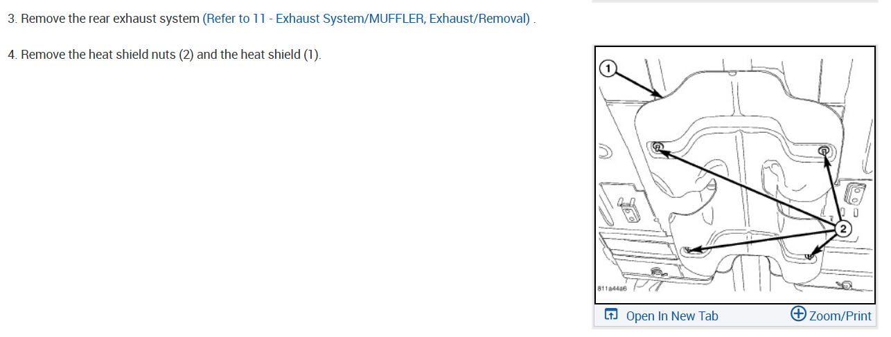

That could be. Can you upload a short video of the noise so I can hear it? I have seen the driveshaft central support go bad and it allows the driveshaft to move and cause all kinds of strange noises. Here is what I am talking about so you can check it out. Check out the images (below). Please upload pictures or videos in your response of any problems so we can see what to help you with.
