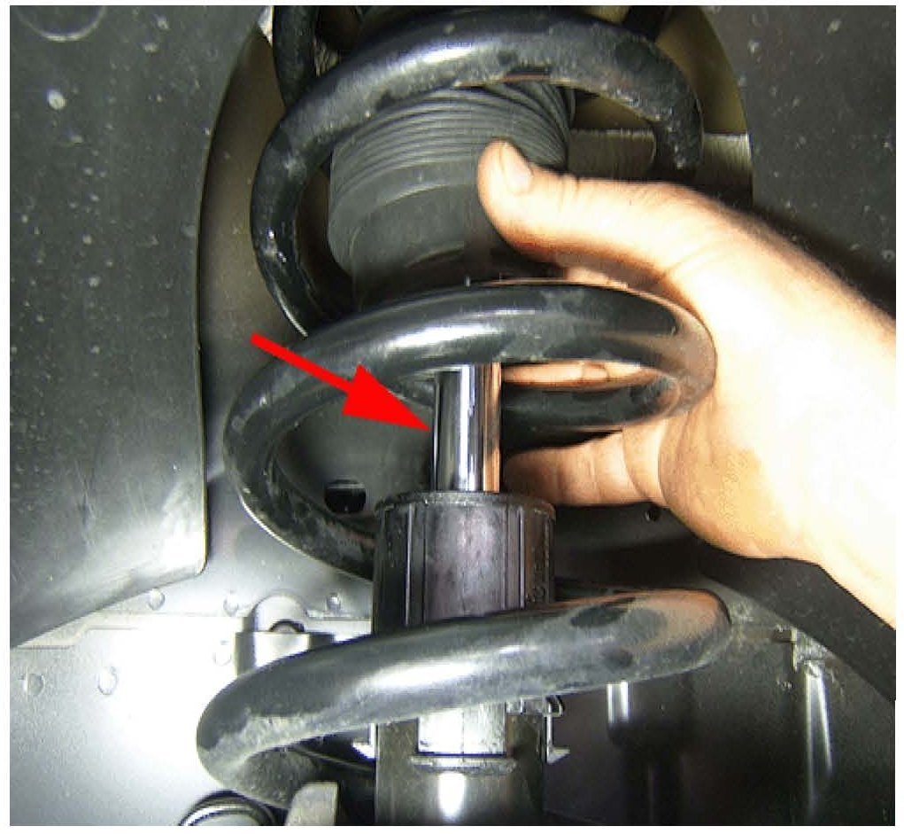

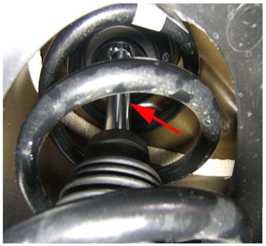

Based on your description, it could be a few things. However, is a technical service bulletin (TSB) regarding front end noise. A TSB is a notice to dealers indicating an issue that has been brought to the manufacturer's attention. It is not a recall, but rather a guide to help diagnose issues which are more likely to be the cause. I need you to read through it and determine if it mirrors your symptoms. Additionally, the TSB shows how to inspect the component and try to remedy it.
Pictures one and two correlate with the TSB.

1.Verify that the noise is from the upper strut mount area. The concern may be on both sides of the vehicle.
2.Raise and support the vehicle on a frame lift-type hoist.
3.Pull the dust shield/jounce bumper assembly out of the strut top mount cup.
4.Slide the dust shield/jounce bumper assembly down to expose the top portion of the strut shaft.
5.Apply grease, GM P/N 12345579 (in Canada, 10953481), around the circumference of the strut shaft that is exposed.
6.Unseat the bottom of the dust shield from the strut.
7.Slide the dust shield/jounce bumper assembly up to expose the bottom portion of the strut shaft.
8.Apply the grease around the circumference of the strut shaft that is exposed.
9.Slide the dust shield/jounce bumper assembly down and reattach the bottom to the strut.
10.Push the top of the dust shield/jounce bumper assembly up into the top mount cup as far as possible by hand. The assembly will fully seat once the vehicle is on the ground and the suspension is allowed to compress.

Try that. You may need struts or even have a cracked coil spring among other possible issues. However, this is a simple test and correction. See if it helps.
