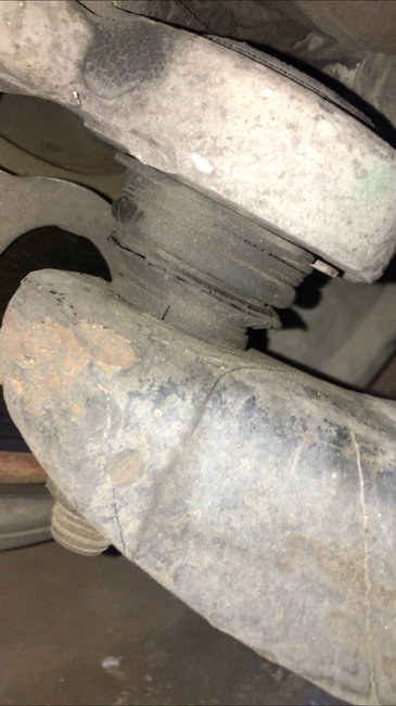

This is a video I took of the lower ball joint on the drivers side. just wanted to get your input on it. what do you think?
Jan 24, 2018 at 8:24 AM

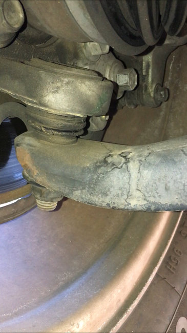

This is the passengers side lower ball joint.
Jan 24, 2018 at 8:32 AM

In the first photo, it looks like the rubber boot is split. That alone warrants a closer inspection, plus, water and dirt will get in there and grind on the mating surfaces.
What you should find is the coil spring is around the strut, and the strut is bolted to the spindle. The weight of the car transfers through the strut, spindle, wheel bearing, then wheel and tire. This means no weight goes through the lower ball joint. The joint's only job is to hold the wheel in position. As such, there are forces acting on the joint when the tire is on the ground. The car must be raised off the ground, and it must be supported by the frame so there is no stress on the lower control arm. At that point, any looseness in the ball joint will be evident when you pry it down with a pry bar or squeeze it with a large Channel Lock pliers.
The second test involves sideways movement between the ball and socket. Unless that is really bad, I need a helper for this test. The way I do it is I start by grabbing the tire and turning it left and right just a little, and with little force. You will feel any looseness in a tie rod end this way. If that is okay, I do this again, but with much more force. The goal is not to actually turn the tire or move the steering linkage more than necessary, as turning the ball joint can make a good one look sloppy, but you are using the tire as a lever, and the tie rod end is a fulcrum, to push and pull on the ball joint. The person watching has to observe if the ball is moving sideways within the socket. Even if that movement is excessive, I have found that most of the time it is hard to detect that movement by feel when you are working so hard to turn the tire. It is better to have the second person helping.
