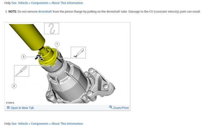

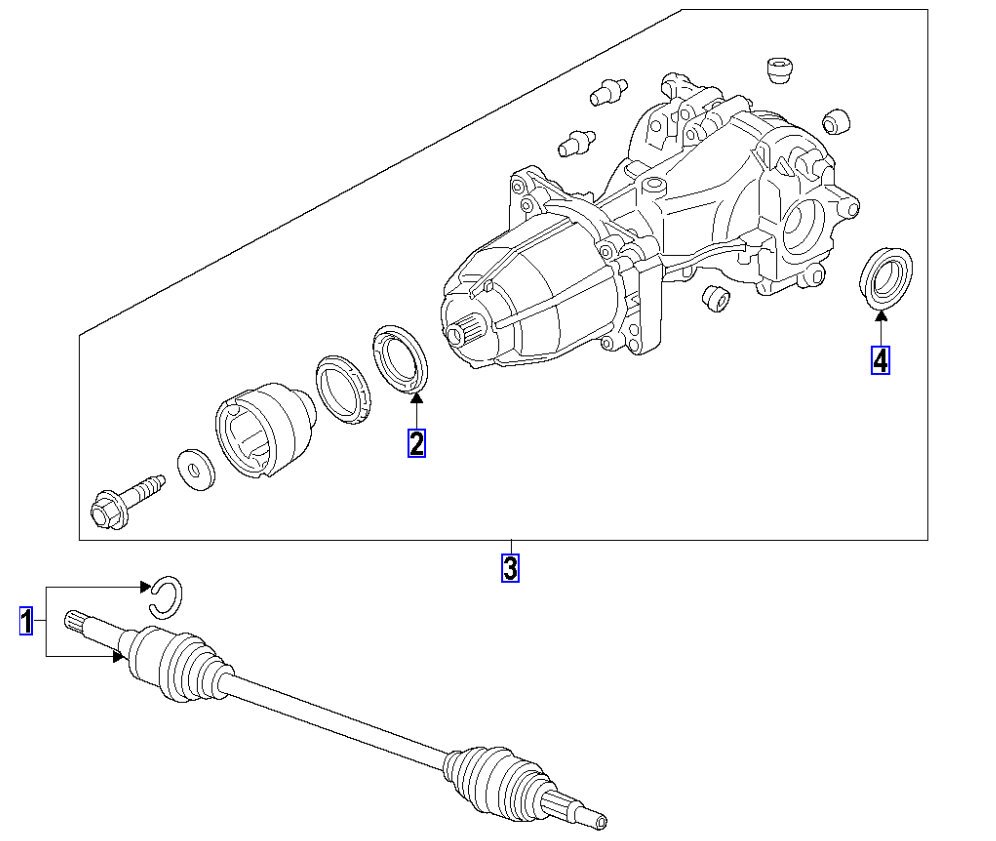

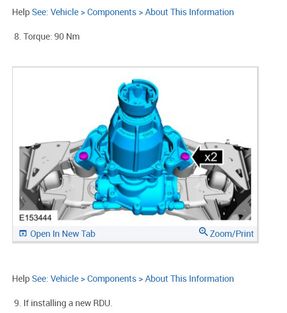

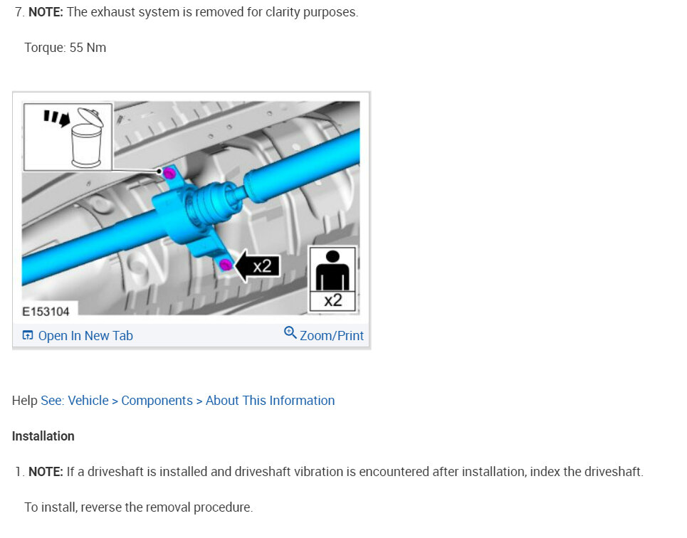

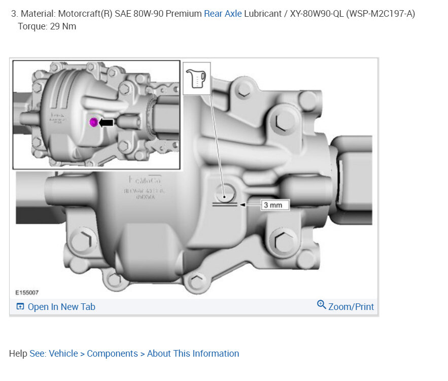

When I'm going down the road at any speed usually, I have on my cruise control and if I go to accelerate hard, say to pass somebody on the interstate, there's a real hard jerk in the rear of the car every time. It sounds just like it does if you're pulling a trailer and it gets a little slack in it and you move forward fast enough, and it just falls back into place.
Aug 8, 2023 at 11:30 AM
  • 55,433 POSTS
It sounds like you have a rear CV axle that needs to be replaced. Can you please shoot a quick video with your phone so I can hear the noise? That way I can tell for sure what's going on. You can upload it here with your response. Here is what I think it could be in the images below. I have also seen the Viscous Coupling device go out and cause this noise as well. I would do a gear oil check in the rear differential as well, please check the center support bearing as well.
