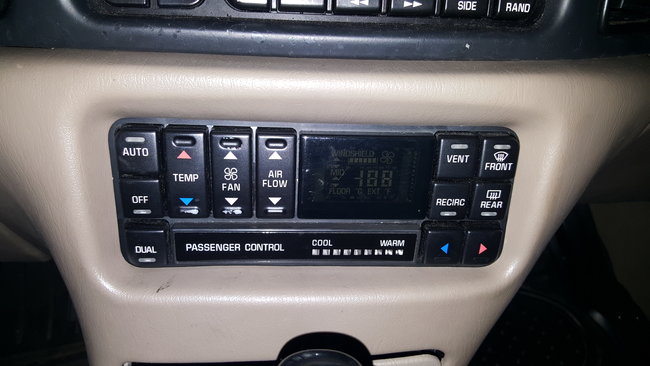

This is the climate control unit. Does this mean is a factory defect.

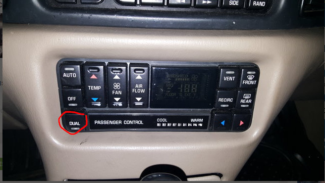

Okay. That is what I thought it was. So the larger temperature control button on the top works for both sides but then does the "Dual" button light up and the passenger side controls work? Or does the button light up and it doesn't work? Or does the button not light up at all?

the "Dual" buttons light up and work perfectly "lighting up" and shifting from cold to hot but there is no difference in temperature on either the passenger or driver's side. You feel the difference in temperature only when moving the Larger temp controls.

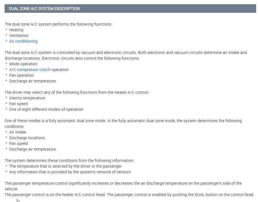

Okay,

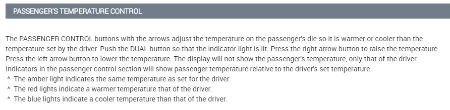

I attached the system information about this because i am wondering if we just have an actuator issue. The way it is supposed to work is then larger temp control will set the temperature. Then when you turn on the dual button and move the temperature up and down, it will adjust the passenger side from what the driver side is set too. Meaning it will not allow you to set it to a different temperature from side to side. It allows you to set one temperature and then you can pull that hotter or colder. Notice in the second attachment it says it will not show passenger temperature only driver side and when you adjust the passenger control it will adjust it relative to the driver temperature.
Maybe adjust the temperature and let it set for a little bit to see if you can notice a difference if you haven't done that already. Point is, I am not sure if you expected to see the temperature numbers change because that would be logical.

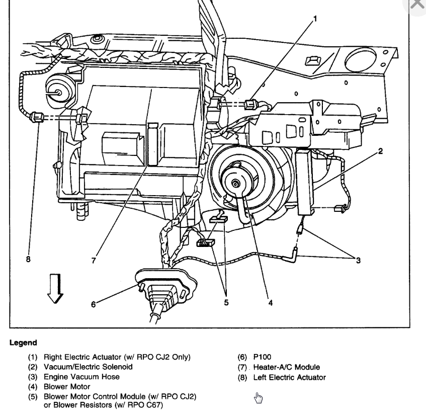

Do you think there is a third. blend door actuator? The climate control unit has been replaced with a new (used) one. The blend door actuator hasn't been replaced even though the main(largest) gear is cracked but I managed to fix it by assuming it's degree of operation after failing to fix the problem by purchasing new actuators and gear replacement kits.

I don't see one. I only see two. The only thing I can't figure out is why the passenger side seems respond with the driver side temp but not when the dual system is activated. Basically the way it should work is both actuators set according to the driver side temp and then the dual setting will pull the passenger side actuator one way or the other depending on if the dial is set cooler or warmer than what the driver side is set too.
What I would suggest is just gaining access to the passenger side actuator and then move the dial for it and see if the actuator moves at all. If not, then there has to be a wiring issue that the command is not getting to the actuator.
