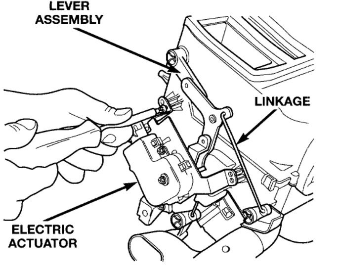

Here is a guide that will help you get the blend door actuators replaced.

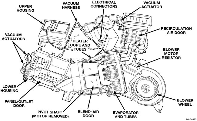

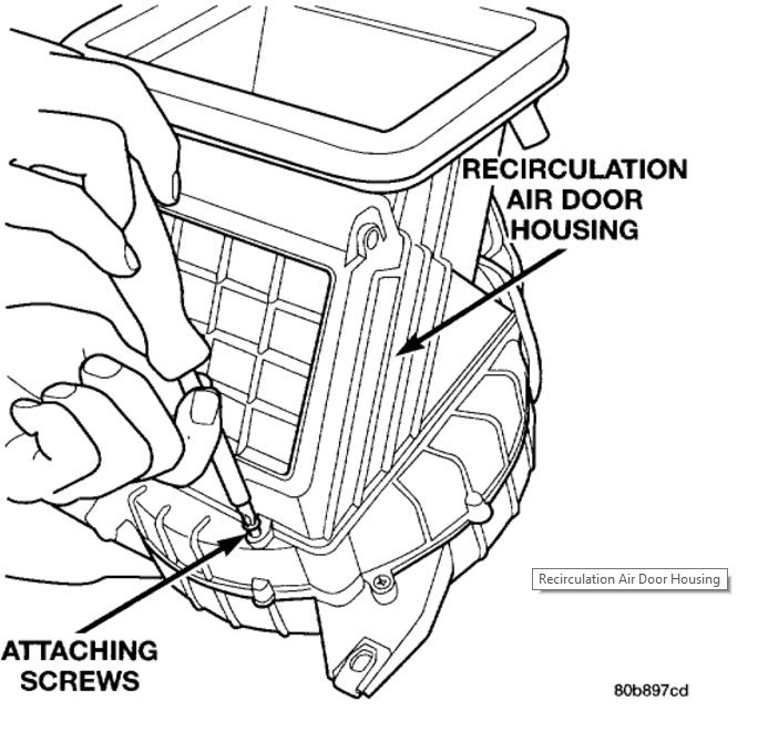

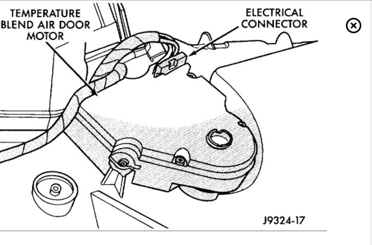

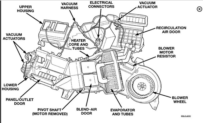

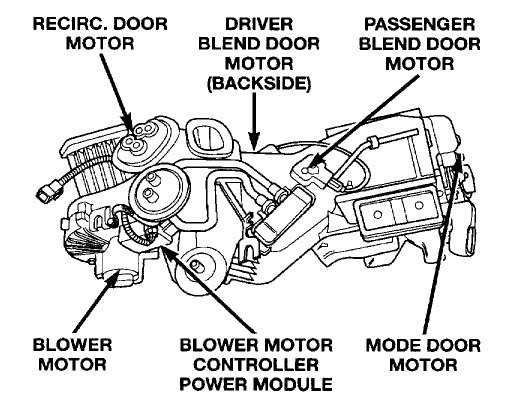

Here are some diagrams (below) to give you reference to the job on your car
Please let me know if you need anything else to get the problem fixed.
Best, Ken

Thank you. How many blend door actuators in car?
-2
Wednesday, December 9th, 2020 AT 3:44 PM (Merged)
KEN L
  • MASTER CERTIFIED MECHANIC
  • 48,363 POSTS
It looks like there is two electronic and one vacuum operated.
+1

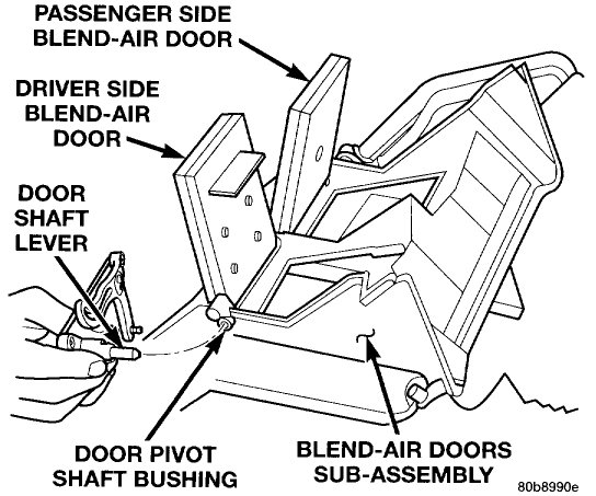

The actuator that controls the passenger side is locked or stuck. I only get cold air. After research I find out that I need to pull the dash out and the air conditioning to access the actuator.
I was wondering if I could just not use the actuator that is bad and only use the good one to control both doors?
STEVE W.
  • 13,574 POSTS
Sorry, the system does not work that way. The actuators control the doors directly and are in different locations on the HVAC box. I do know of people who have decided they do not like the electric units and have replaced them with cable controls. But that is a bit extreme.
DICKKNOWS
Thanks for responding Steve.
I decided to modify things a little different than factory. Lol
Now it is controlled by the drivers side only and I am fine with that. Glued the two doors together and cut the notches out of the rear one and removed the notch on the other shaft so it just freely turns.
Have a great new year!
