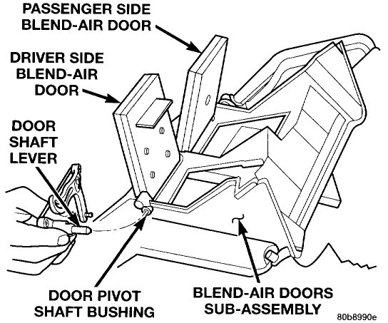

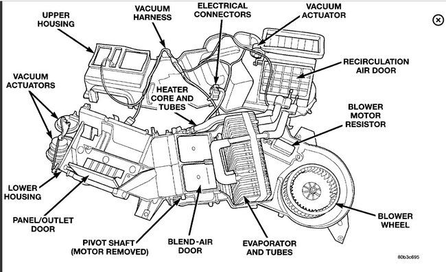

Blend door and actuator seem to be fine. But the spindle pivot is broken. Can I remove it and place a new one without having to worry about the door moving out of place?
I saw videos of people cutting the plastic and I do not want to do that.
Apr 12, 2018 at 2:39 PM
Good morning.

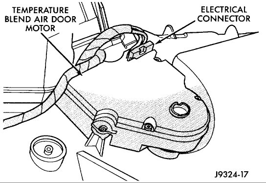

Can you identify which one you need to replace? I attached a picture for you to view.
Apr 12, 2018 at 7:03 PM
AALJALUDI
Thank you so much for the prompt reply.
Not sure if I am understanding the picture fully but the piece that is broken is the white pin that connects the actuator to the door to make it move (open/close).
Image attached is not my car but that is the part that is broken.
It is two pieces.
(Outside) that acts as a connector between actuator and door. Not broken.
(Inside) pin that holds the door and gives it movement. Broken.

That would be part two in the image the master loaded. It goes through the hole and snaps onto the plastic axle the door turns on. It can be replaced but you cannot pull it free with the case assembled. The inner part has two wide slots and inside the piece is a molded retainer collar. As it goes over the shaft it expands and snaps in place. To assemble you put it through the hole in the case, then push the doors axle in and it locks in. Cutting an access hole is about the only way unless you remove the entire HVAC carrier and open it that way.
What I do to repair them, if the owner approves, is drill some 1/8" holes at four corners, then cut between them with a vibrating cutter and remove the piece. Clean up the edges and any plastic swarf. Now repair the door driver and test it. Now to reinstall the access panel I will use four short sheet metal screws. hold the panel in place and screw in two screws diagonally, then the other two. Now use either black silicone or similar (two part stick epoxy works but is not fun to remove for the next repair) and fill the cut line and over the screws. Let it cure fully. Probably similar to the videos.

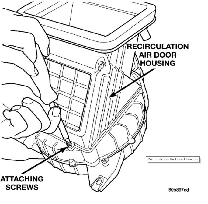

Here are the directions specific to your vehicle. The attached pictures correlate with the directions.
_______________________________________

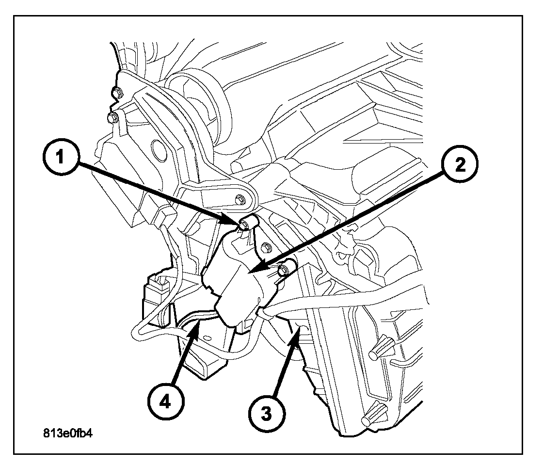

2006 Jeep Truck Grand Cherokee 4WD V6-3.7L VIN K
Single Zone/Dual Zone LH Side
Vehicle Heating and Air Conditioning Air Door Actuator / Motor Service and Repair Procedures Blend Door Actuator Single Zone/Dual Zone LH Side
SINGLE ZONE/DUAL ZONE LH SIDE
NOTE: The single zone heater - A/C system is equipped with a single blend door actuator. The dual zone system has two blend door actuators, one for the driver side blend - air door and one for the passenger side blend - air door.
REMOVAL
WARNING: ON VEHICLES EQUIPPED WITH AIRBAGS, DISABLE THE AIRBAG SYSTEM BEFORE ATTEMPTING ANY STEERING WHEEL, STEERING COLUMN, OR INSTRUMENT PANEL COMPONENT DIAGNOSIS OR SERVICE. DISCONNECT AND ISOLATE THE NEGATIVE BATTERY (GROUND) CABLE, THEN WAIT TWO MINUTES FOR THE AIRBAG SYSTEM CAPACITOR TO DISCHARGE BEFORE PERFORMING FURTHER DIAGNOSIS OR SERVICE. THIS IS THE ONLY SURE WAY TO DISABLE THE AIRBAG SYSTEM. FAILURE TO TAKE THE PROPER PRECAUTIONS COULD RESULT IN ACCIDENTAL AIRBAG DEPLOYMENT AND POSSIBLE PERSONAL INJURY OR DEATH. See: Air Bag(s) Arming and Disarming > Service and Repair
pic 1
1. Disconnect and isolate the negative battery cable. See: Battery Cable > Service and Repair
2. On LHD models, remove the instrument panel silencer from the driver side of the instrument panel.
3. On RHD models, remove the glove box from the instrument panel.

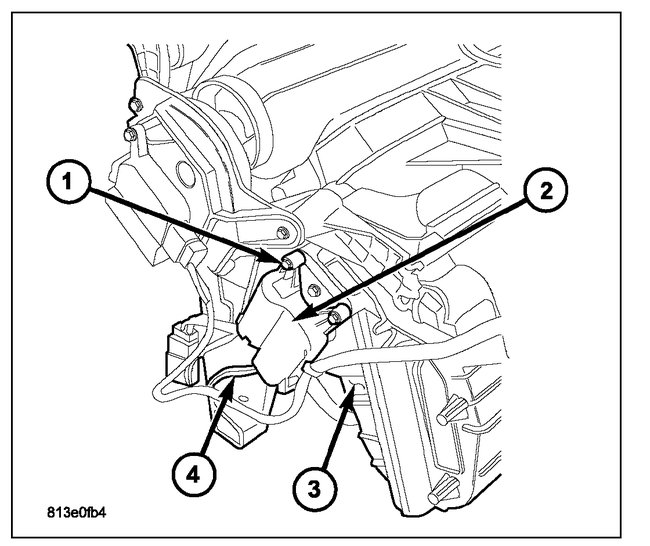

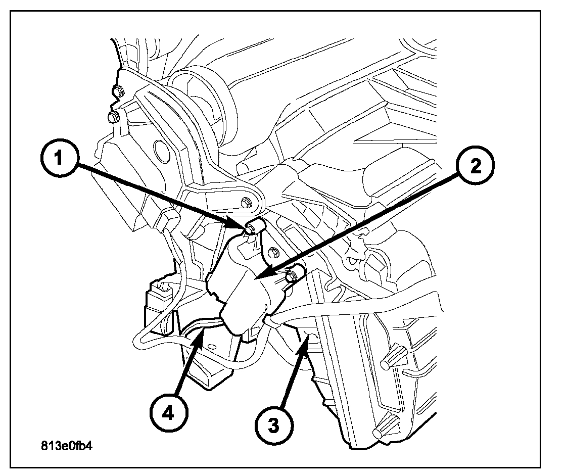

4. Remove the three screws (1) that secure the blend door actuator (2) to the left side of the HVAC air distribution housing (3).
5. Remove the blend door actuator from the air distribution housing and disconnect the HVAC wire harness connector (4) from the actuator.
6. Remove the blend door actuator from the vehicle.
INSTALLATION

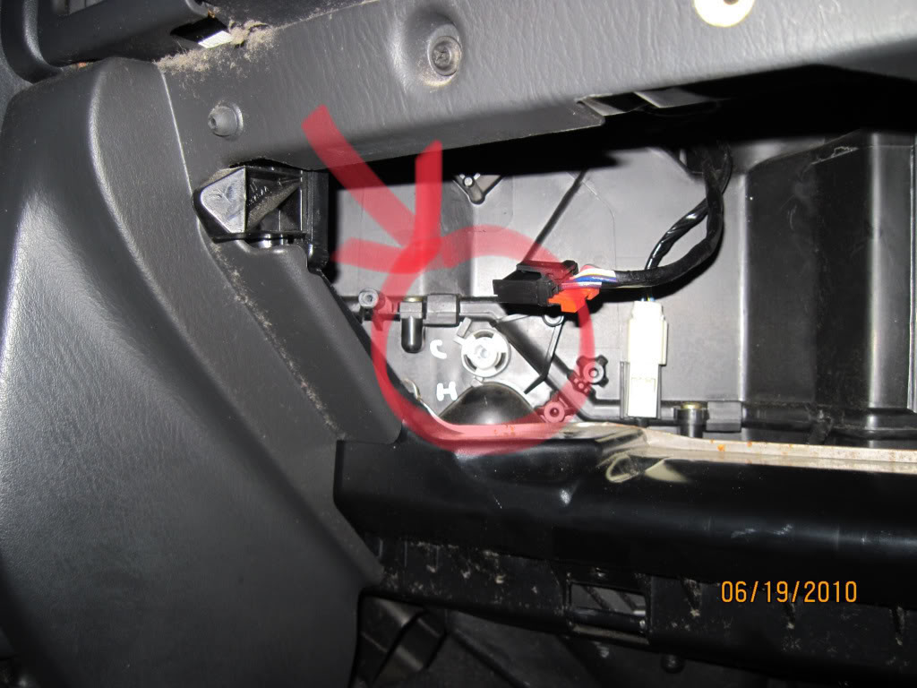

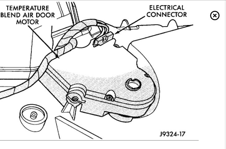

pic 2
1. Position the blend door actuator (1) into the vehicle.
2. Install the blend door actuator onto the left side of the HVAC air distribution housing (2). If necessary, rotate the actuator slightly to align the splines on the actuator output shaft (3) with those on the blend door cam (4).

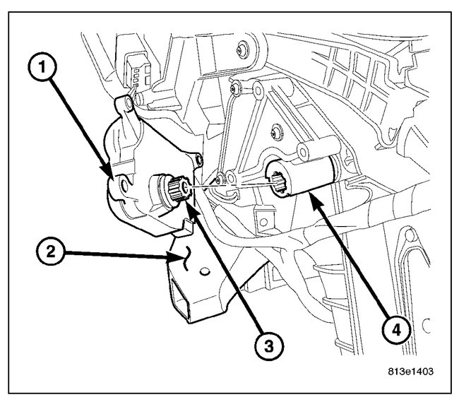

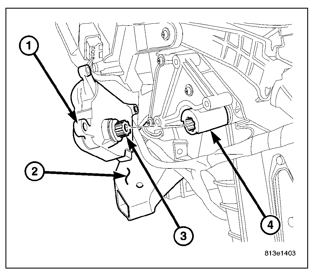

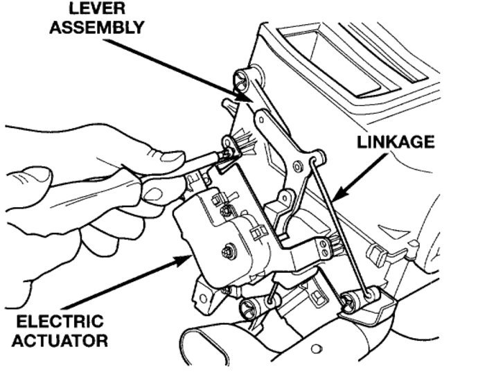

pic 3
3. Install the screws (1) that secure the blend door actuator (2) to the left side of the air distribution housing (3). Tighten the screws to 2 N.m (17 in. lbs.).
4. Connect the HVAC wire harness connector (4) to the blend door actuator.
5. On LHD models, install the instrument panel silencer onto the driver side of the instrument panel.
6. On RHD models, install the glove box into the instrument panel.
7. Reconnect the negative battery cable.

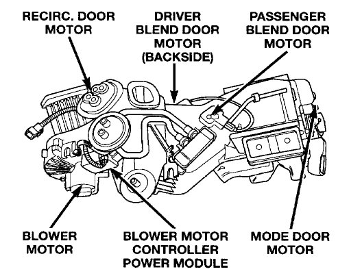

Quick question, how many blend door actuators are in my vehicle I know there is one located on passenger side, where is the other (s) located. (I think there is only two) Since the dash will have to be pulled out, your other guy said to replace the evaporator and heater core because of the age of the car, which I am going to do.
Second question: I know it will take about five hours (from quote) to replace blend door, how many hours will it add to replace the evaporator and heater core and the other blend door actuator ( Will it be seven hour or the same, five?)
Dec 9, 2020 at 7:44 AM (Merged)
  • 55,433 POSTS
The heater core job and evaporator will take 6 hours according to the manual. You will need to do the a/c vacuum down and recharge, here is a guide for that.
and
For the heater core
https://www.2carpros.com/articles/replace-heater-core

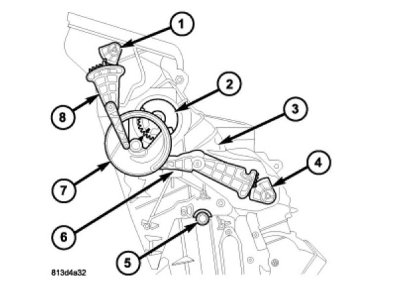

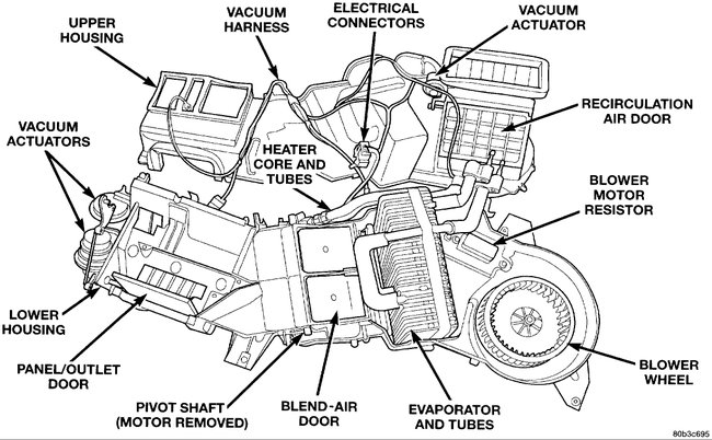

Here is a guide that will help you get the blend door actuators replaced.
Here are some diagrams (below) to give you reference to the job on your car
Please let me know if you need anything else to get the problem fixed.
Best, Ken
TERRIE YOUNG
  • 6 POSTS
Thank you....how many blend door actuators in car?
  • 55,433 POSTS
It looks like there is two electronic and one vacuum operated.
