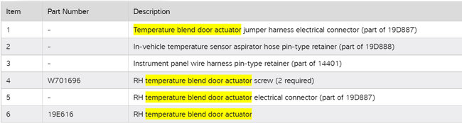

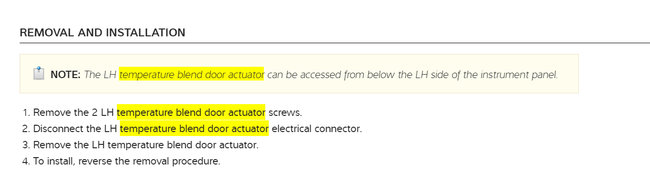

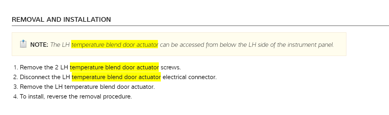

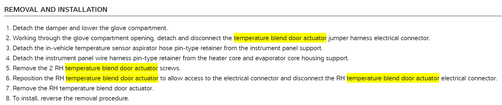

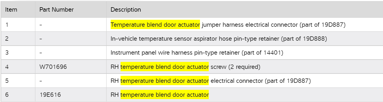

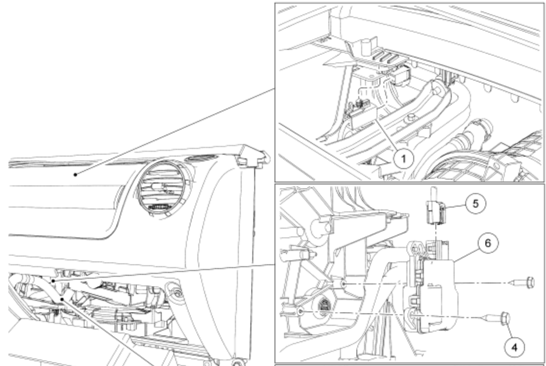

Hello, the actuator you were at is the correct one, under the right side (pass side) dash.

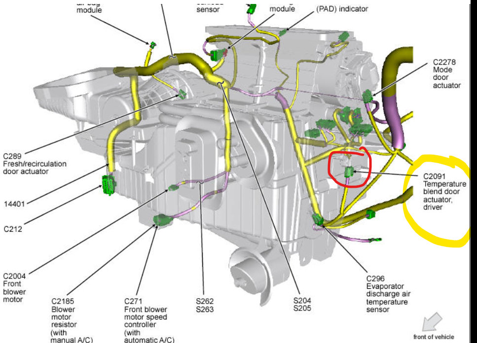

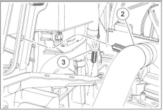

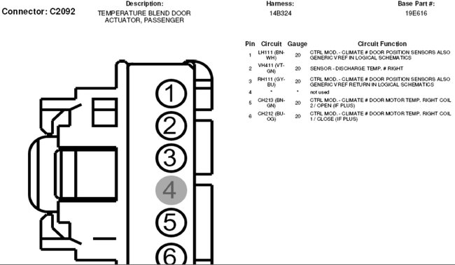

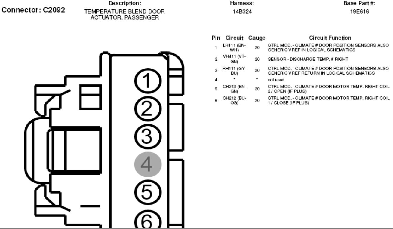

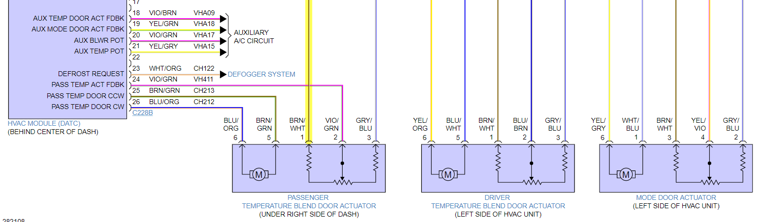

In the diagram is the wire coloring to id the correct actuator. The highlighted wire (brown/white wire) is the 5-volt reference feed. The grey/blue wire is the ground, and the violet/green wire is the door position signal wire going to the HVAC module. The two wires blue/orange and brown/green wires are the two wires that feed voltage to either side of the motor depending on what direction it needs to go. I will keep updating this with information as needed. The parts list numbers goes with pic 3 and 4.

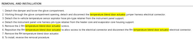

I don't see any reprogramming procedures, it only states to set the actuator position to the same as the failed component that came out.

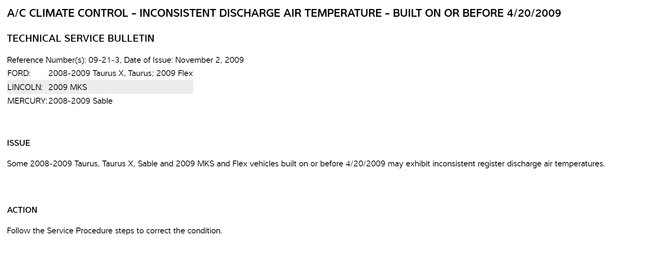

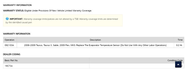

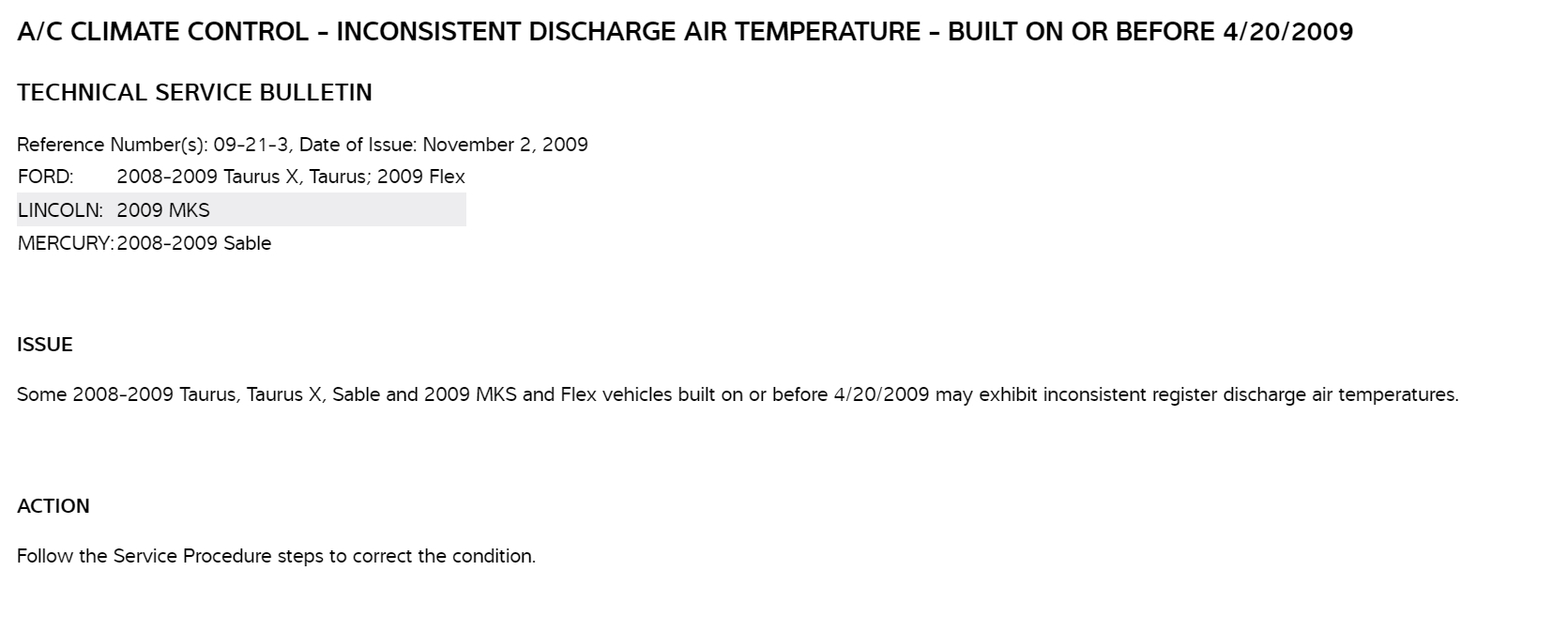

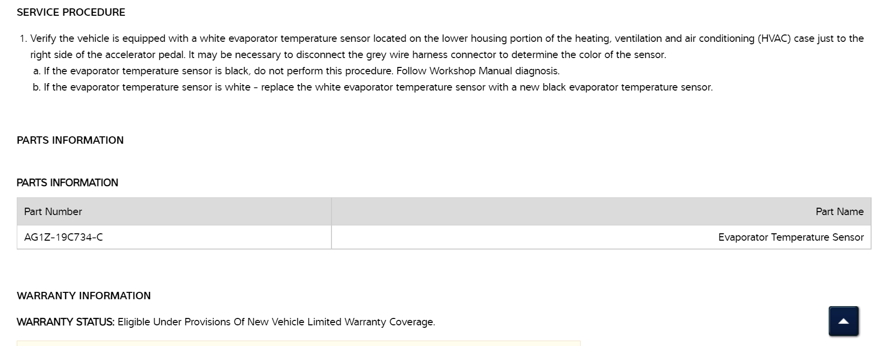

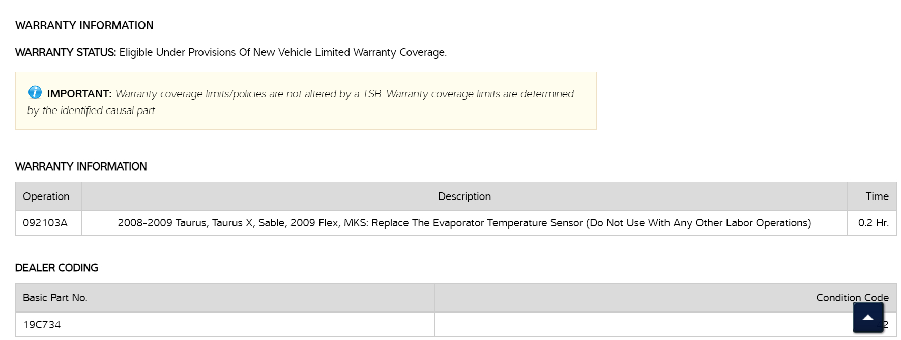

There is a Technical Service Bulletin on this HVAC system. I will post that below,
I can walk you through testing the position sensor if you have a multimeter. The motor section is just the two wires that have 12-volts applied to either side. The other three wires are the position sensor.

I took the actuator out and re-installed it and it worked this time! I think I may have not had the wire clipped in tight the first time.

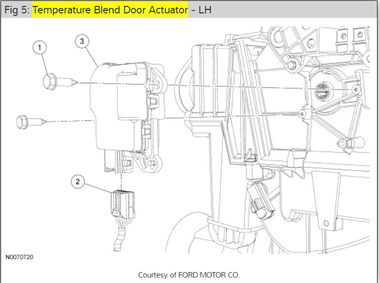

Glad to hear that worked for you, those are Blend doors, so they mix the incoming cold air with hot air etc. There is a in-vehicle temperature sensor in the middle of the dash, but pretty much that's it, it doesn't look like a common failure on these so I wouldn't worry too much about it until it actually fails, but yes it will be the same symptoms, you'll try to get either hot or cold out of it and it will only produce one or the other. This one is located on the driver side up under the dash, you can see in the diagram, pretty much the same procedure. It may be a different part number.
