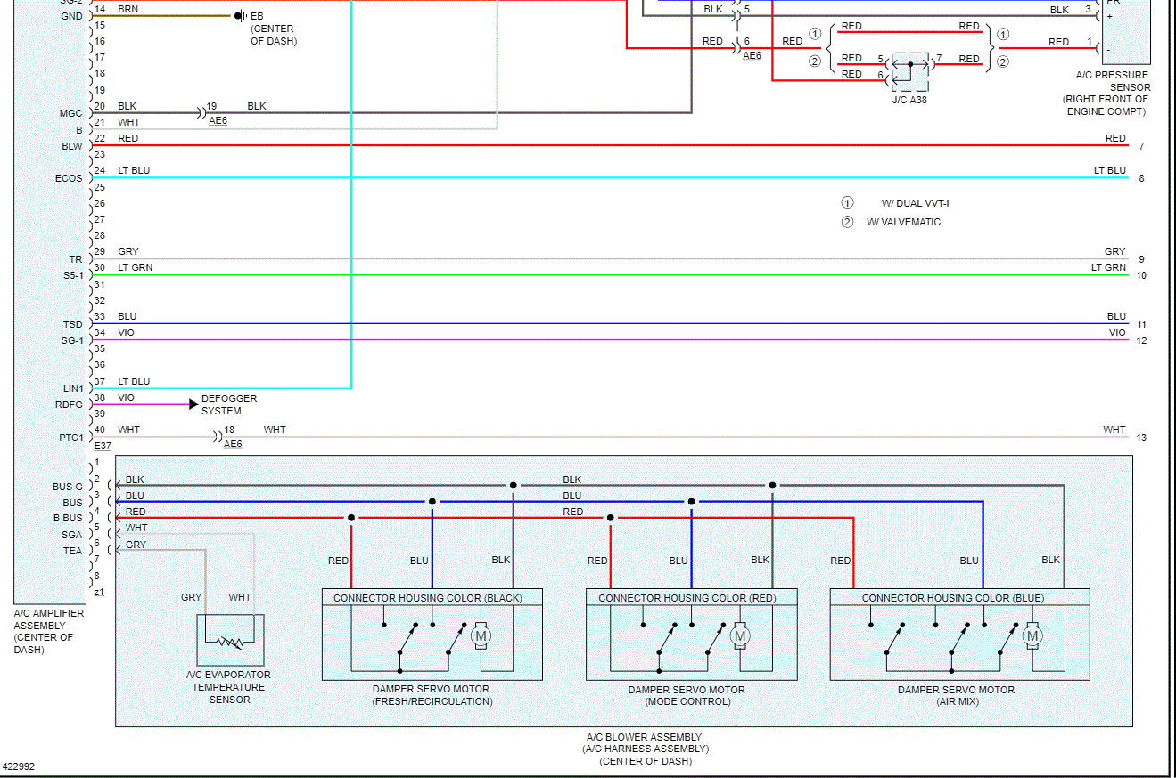

hi,

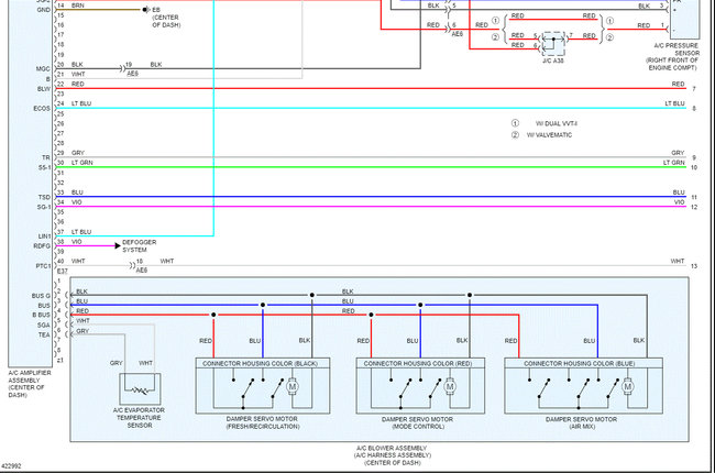

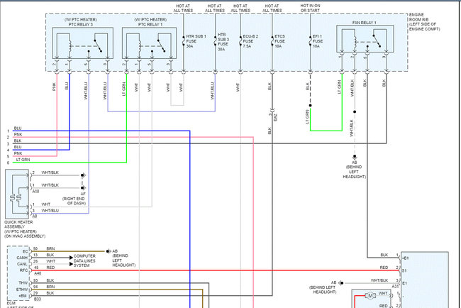

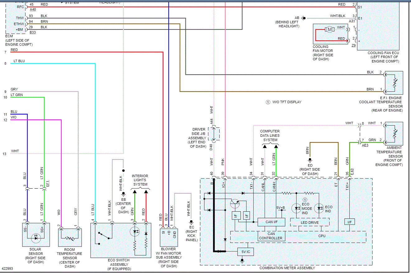

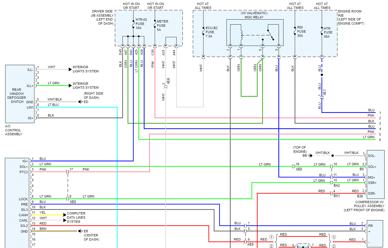

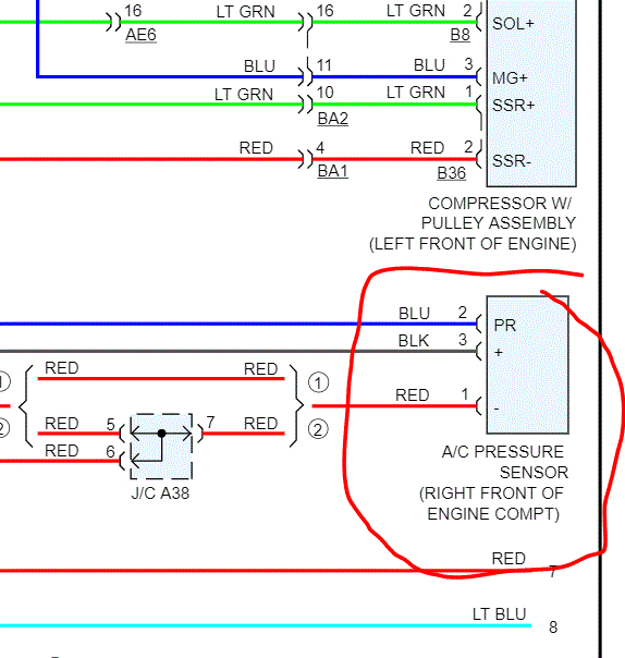

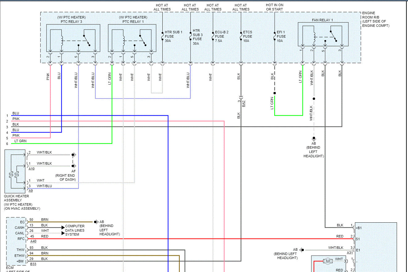

The first 4 pictures below show the wiring schematic for the HVAC. I'm adding all of them in case you need them.

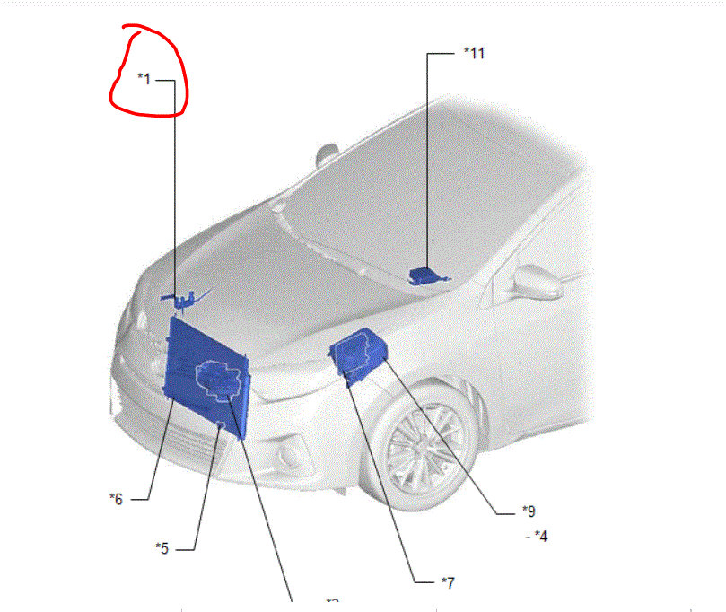

Next, have you checked the low pressure switch? (see pic 5) Are you getting power to the compressor?
Here is a link you may find helpful as well:
Let me know what the static pressure reading is and the outside temp when checked.

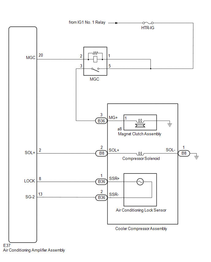

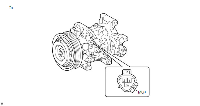

Okay. The static pressure sounds good. As far as where to check for power, I am going to provide a diagnostic flow chart. The attached pics correlate with the directions. Also, it explains what, how, and the specs for checking. The directions will refer to an MGC relay. That is basically the compressor relay which is powered by the ignition 1 relay in the under hood fuse/relay box.
2014 Toyota Corolla L4-1.8L (2ZR-FAE)
Air Conditioning System (Automatic Air Conditioning System) - Air Conditioning Compressor Magnetic Clutch Circuit [08/2013 - ]
DESCRIPTION
When the air conditioning amplifier assembly is turned on, a magnet clutch on signal is sent from the MGC terminal of the air conditioning amplifier assembly. Then, the MGC relay turns on to operate the magnet clutch assembly.
WIRING DIAGRAM
pic 1
CAUTION / NOTICE / HINT
NOTICE:
ECM malfunctions can affect the storage of this DTC. Therefore, check all EFI system DTCs and confirm that the system is normal before performing the following inspection.
Click here [ 2ZR-FAE (ENGINE CONTROL): SFI SYSTEM: DTC CHECK / CLEAR ]
Inspect the fuses for circuits related to this system before performing the following procedure.
PROCEDURE

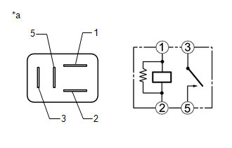

1. INSPECT MGC RELAY
Remove the MGC relay.
Measure the resistance according to the value(s) in the table below.
Standard Resistance:
Tester Connection Condition Specified Condition
3 - 5 Battery voltage not applied between terminals 1 and 2 10 or higher
3 - 5 Battery voltage applied between terminals 1 and 2 Below 1
pic 2
a Component without harness connected
(MGC Relay)
Result:
Proceed to
OK
NG
NG -- REPLACE MGC RELAY
OK -- Continue to next step.
2. CHECK HARNESS AND CONNECTOR (MGC RELAY - POWER SOURCE)
Measure the voltage according to the value(s) in the table below.
Standard Voltage:
Relay terminal 5 - Body ground Ignition switch off Below 1 V
Relay terminal 5 - Body ground Ignition switch ON 11 to 14 V
Relay terminal 1 - Body ground Ignition switch off Below 1 V
Relay terminal 1 - Body ground Ignition switch ON 11 to 14 V
Result:
Proceed to
OK
NG
NG -- REPAIR OR REPLACE HARNESS OR CONNECTOR
3. CHECK HARNESS AND CONNECTOR (MGC RELAY - COOLER COMPRESSOR ASSEMBLY)
Disconnect the B36 cooler compressor assembly connector.
Relay terminal 3 - B36-3 (MG+) Always Below 1
Relay terminal 3 - Body ground Always 10 k or higher
Result:
Proceed to
OK
NG
4. CHECK HARNESS AND CONNECTOR (MGC RELAY - AIR CONDITIONING AMPLIFIER ASSEMBLY)
Disconnect the E37 air conditioning amplifier assembly connector.
Relay terminal 2 - E37-20 (MGC) Always Below 1
Relay terminal 2 - Body ground Always 10 k or higher
Result:
Proceed to
OK
NG
5. CHECK MAGNET CLUTCH ASSEMBLY
pic 3
(Cooler Compressor Assembly) - -
3 (MG+) - Body ground 20°C (68°F) 3.8 to 4.2
Connect a positive (+) lead from the battery to terminal 3 (MG+) and check that the following occurs: 1) the magnet clutch assembly operating sound can be heard, and 2) the magnet clutch hub and rotor lock.
OK:
1) The magnet clutch assembly operating sound can be heard, and 2) the magnet clutch hub and rotor lock.
Result:
Proceed to
OK
NG
OK -- PROCEED TO NEXT SUSPECTED AREA SHOWN IN PROBLEM SYMPTOMS TABLE [ HEATING / AIR CONDITIONING: AIR CONDITIONING SYSTEM(for Automatic Air Conditioning System): PROBLEM SYMPTOMS TABLE ]
NG -- REPLACE MAGNET CLUTCH ASSEMBLY [ HEATING / AIR CONDITIONING: COMPRESSOR(for 2ZR-FAE): DISASSEMBLY ]

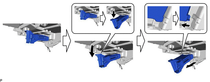

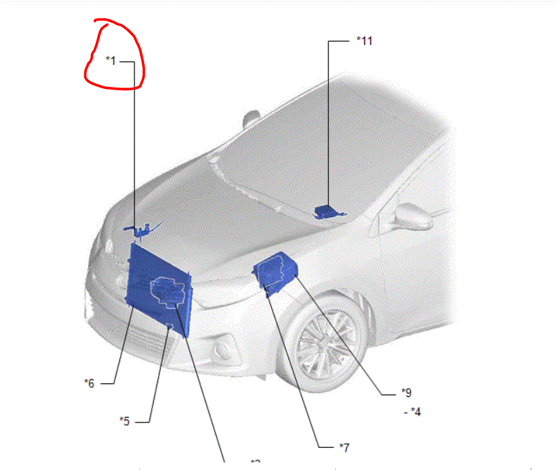

If you look at pic 4, it shows the location of the AC pressure sensor.
Let me know if this helps.

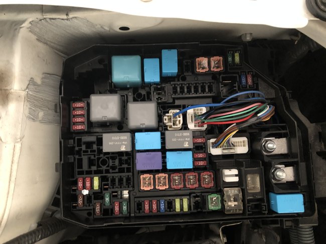

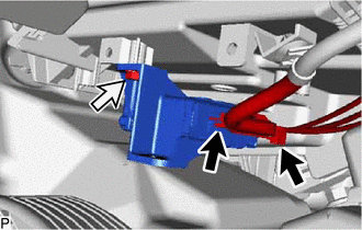

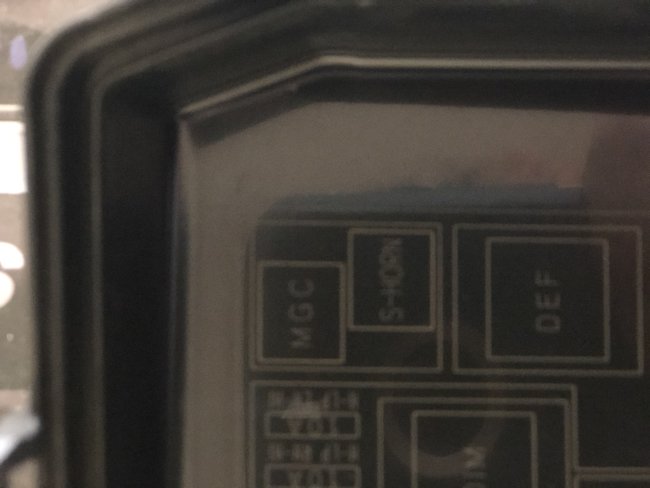

Okay not seeing an MGC relay cover for fuse box shows it nothing in that spot. See attached pictures.
Mar 28, 2020 at 12:10 AM
  • 110,241 POSTS

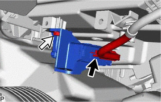

That's interesting. Take a look at the two pics I attached. That's where it should be.

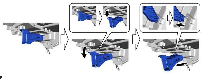

The only other thing I can think to check would be what is called an AC amplifier. This is part of the can bus system signal to the compressor as well. That should have set a trouble code. It would require a scanner that can communicate with the can bus system on the vehicle to determine if there is a signal from the amplifier on the can bus line.

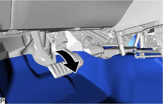

The amplifier is located under the dash. Here are the removal directions so you can locate it. Note these directions are for either manual or automatic systems. Both are included.
I separated them with a line.
2014 Toyota Corolla L4-1.8L (2ZR-FE)
Air Conditioning Amplifier - Removal [08/2013 - ]
Vehicle Heating and Air Conditioning Relays and Modules - HVAC Control Module HVAC Service and Repair Removal and Replacement Air Conditioning Amplifier - Removal [08/2013 - ]
AIR CONDITIONING AMPLIFIER - REMOVAL [08/2013 - ]
HEATING / AIR CONDITIONING: AIR CONDITIONING AMPLIFIER: REMOVAL; 2014 - 2019 MY Corolla [08/2013 - ]
PROCEDURE
REMOVE FRONT NO. 1 CONSOLE BOX INSERT
Click here [ INTERIOR PANELS / TRIM: FRONT CONSOLE BOX: REMOVAL+ ] [ INTERIOR PANELS / TRIM: FRONT CONSOLE BOX: REMOVAL+ ]
REMOVE AIR CONDITIONING AMPLIFIER ASSEMBLY (for Manual Air Conditioning System)
Turn back the front floor carpet assembly as shown in the illustration.
pic 3
Disconnect the connector.
pic 4
Remove the screw.
Remove the air conditioning amplifier assembly as shown in the illustration.
pic 5
_______________________________________________________________
REMOVE AIR CONDITIONING AMPLIFIER ASSEMBLY (for Automatic Air Conditioning System)
pic 6
Disconnect the 2 connectors.
pic 7
Remove the screw.
pic 8
Can you let me know what the production date of the vehicle is? It should be on a label either on the door or door frame. Also, is it automatic AC or manual? The vehicle may have been made late enough in the model year that there was a change. I will have to research that for you. Let me know if you locate the amplifier and if everything appears okay with it.

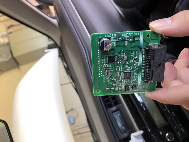

Manufacture date is 04/14 located amplifier easy to remove everything appears okay with it..Do I need to take the cover off of it? Diagram shows a MGC relay where is it located?
Mar 29, 2020 at 12:35 AM
LILLY2016
  • 7 POSTS
See picture of amplifier no dark or burn spots that I notice.
Mar 29, 2020 at 12:40 AM
  • 110,241 POSTS
It does look fine. Tell me. do you have automatic AC or manual? I ask because the MGC relay is identified in both systems where I indicated. However, when I look through schematics, it takes me to the amplifier in place of the MGC. Ugh!

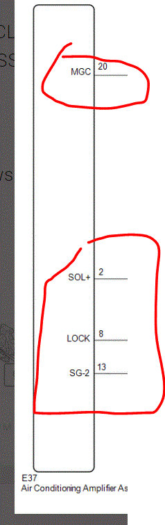

Are there 4 wires that go to the amplifier? If so, I need you to check for power at the (aledged) MGC wire shown in the attached pic. I am so sorry. The schematics seem to contradict themselves. If there is power to that wire, there should be power to the compressor clutch. You said there isn't, so if there is power at the amp and not the clutch, there has to be a break in the wire.
