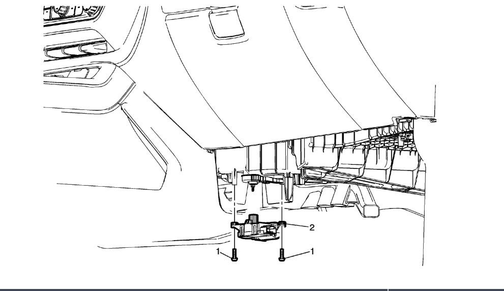

Driver side ac lukewarm not cold like passenger side actuator problem? Or something else?
Apr 30, 2021 at 4:44 AM (Merged)
  • 110,244 POSTS
Welcome to 2CarPros.
If you have dual climate control, it sounds like the blend air door actuator isn't working. The actuator is located under the dash on the HVAC system.
Here is a link that explains in general how to replace one:
What I suggest is to confirm that the actuator isn't operating and replace it if it isn't.
Let me know if I can help. If you need specifics, let me know if the system is an automatic or manual climate control.

The one under the dash on the passenger side controls the passenger side drivers side isn't working.
  • 110,244 POSTS
Welcome back:

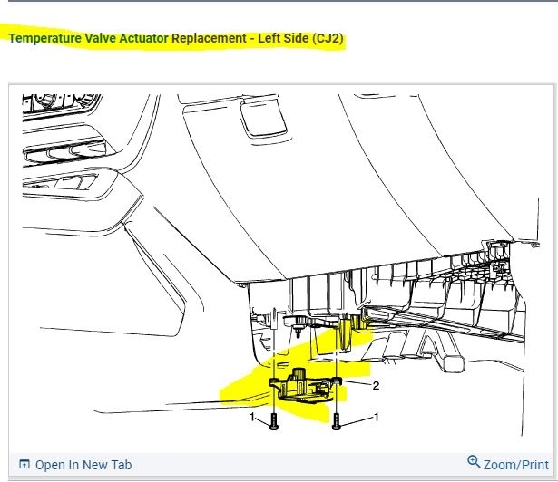

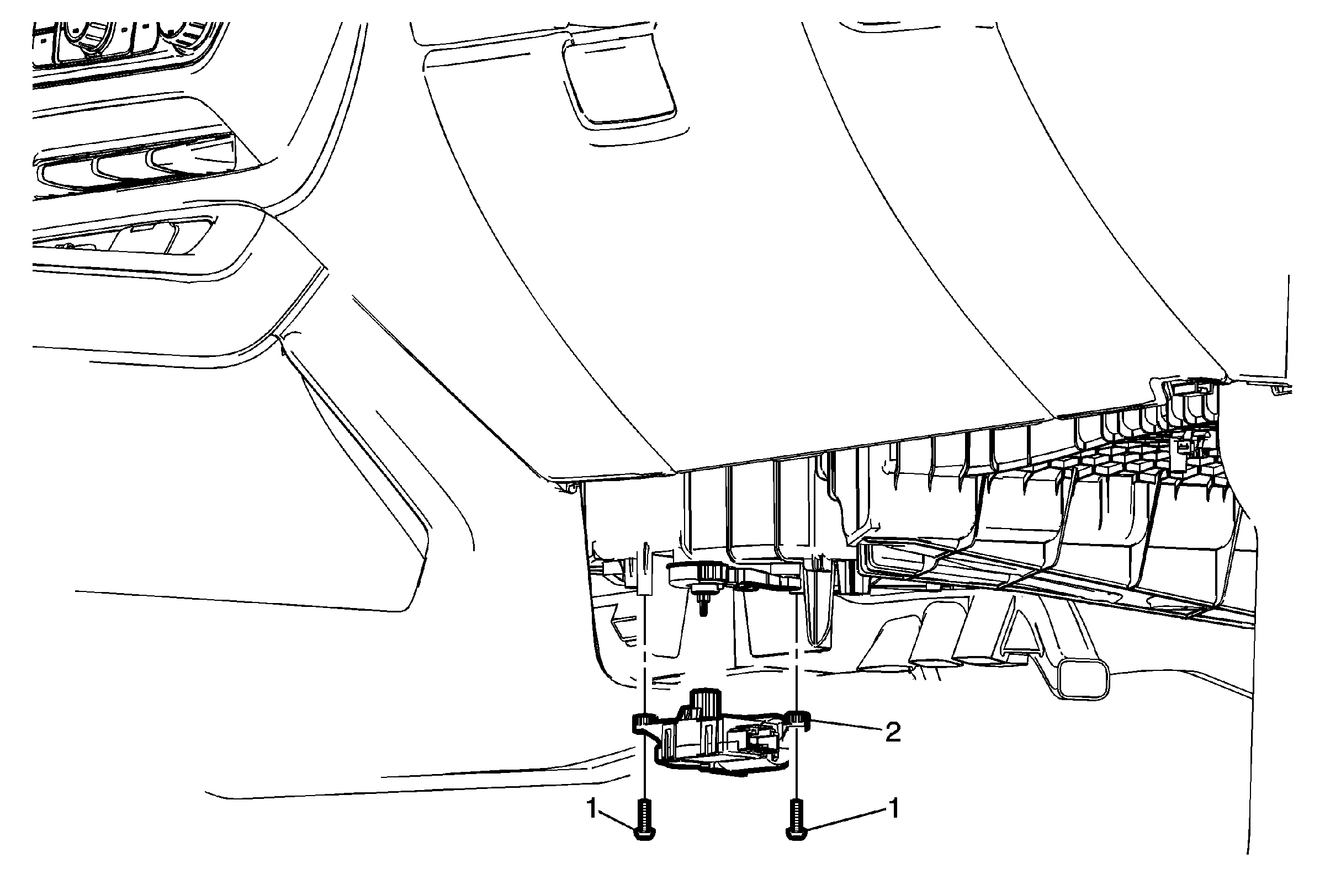

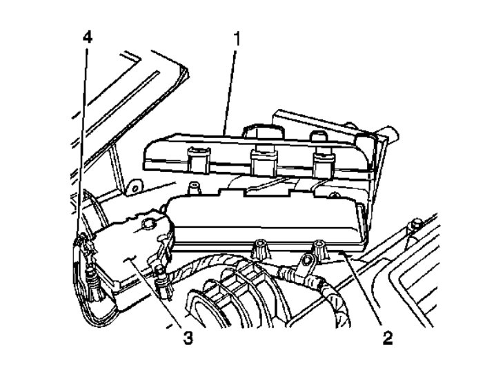

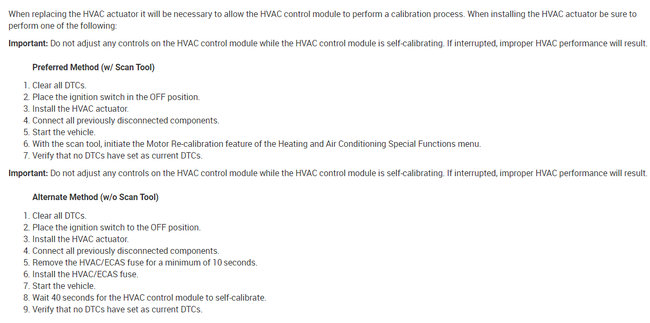

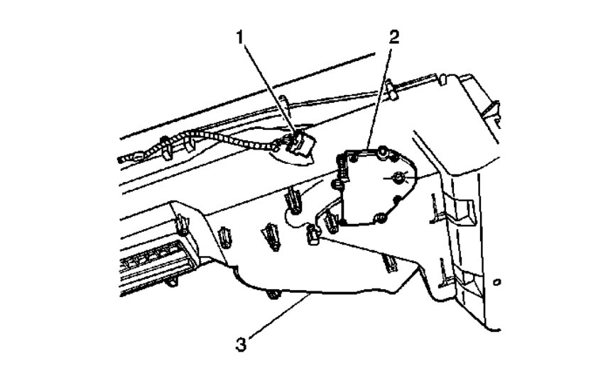

According to Alldata, with automatic climate control, the left side actuator is located just to the left of the glove box. The directions provide are in pics 2 and 3. In pic 1, I highlighted what I am seeing.

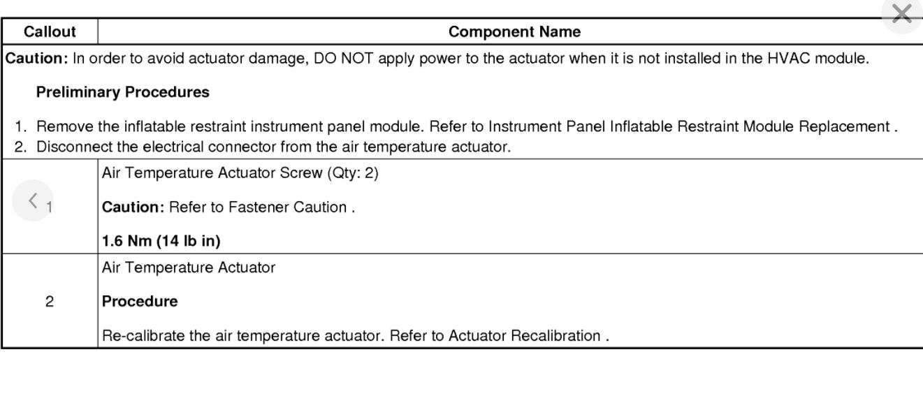

The last thing in in pic 3 indicates calibration. I looked up the process for you and found this for doing it without a scanner.
Alternate Method (without Scan Tool)
Note: Do not adjust any controls on the HVAC control module while the HVAC control module is self-calibrating. If interrupted, improper HVAC performance will result.
1. Clear all DTCs.
2. Place the ignition switch to the OFF position.
3. Install the HVAC actuator.
4. Connect all previously disconnected components.
5. Remove the HVAC control module fuse for a minimum of 10 s.
6. Install the HVAC control module fuse.
7. Start the vehicle.
8. Wait 40 s for the HVAC control module to self-calibrate.
9. Operate system and verify that no DTCs have set as current DTCs.

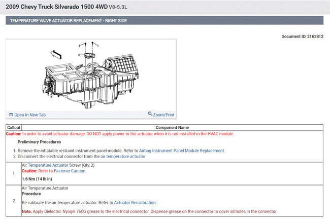

Good evening,

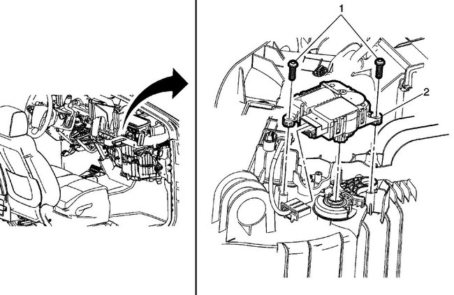

I attached a picture of the actuator and the procedure for you to follow with diagrams below .

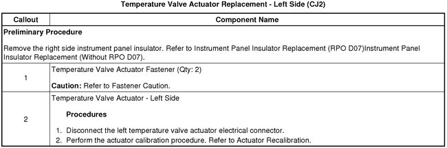

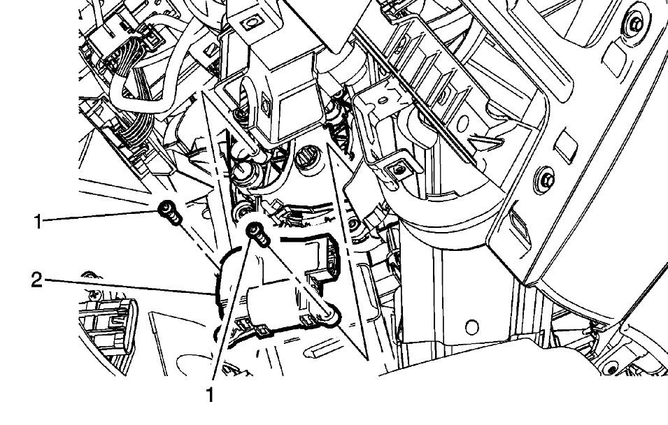

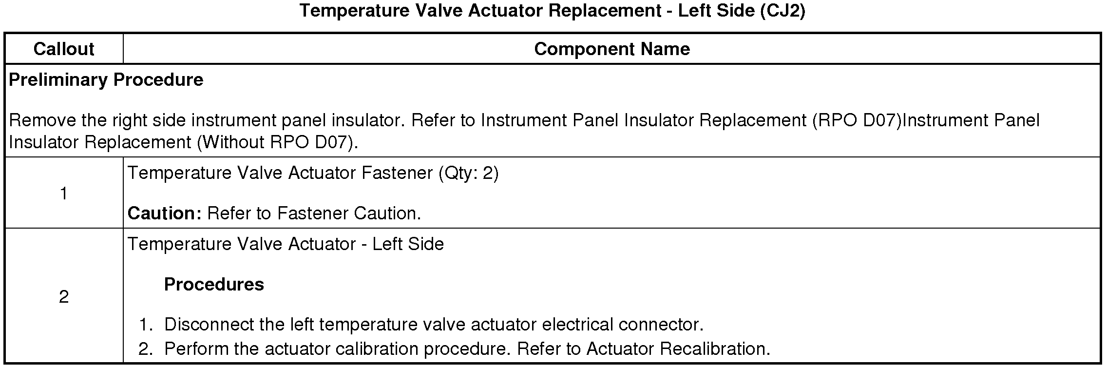

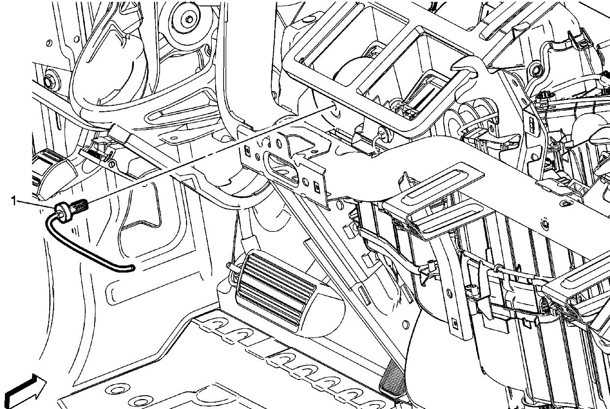

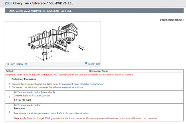

I attached directions for replacement of the actuator specific to the left side. The attached pictures correlate with the directions. First, here is a link that explains the process in general:
Here are the specifics:
TEMPERATURE VALVE ACTUATOR REPLACEMENT - LEFT SIDE (CJ2)
Temperature Valve Actuator Replacement - Left Side (CJ2)
pic 1
pic 2
Let me know if this helps.

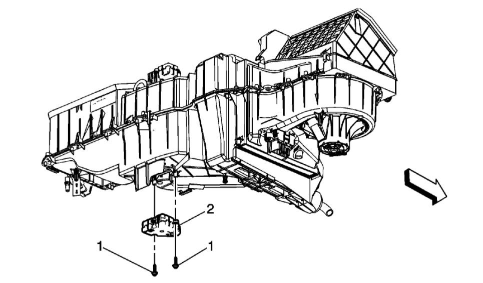

This truck is the 1500 model. After replacement of a drained battery, the driver side AC circulates between warm, cool, and cold approximately every ninety seconds while the passenger side works properly. Based upon research, it seems that this is a common issue and that a fix may be to. 1) initiate a re-calibration using a scan tool. 2) perform some steps that require removing a fuse, adjusting the temperature, shutting the truck off, etc. I have done each of the recommended procedures, however I am still experiencing the same issue. We also tested the A/C unit for leaks by draining the Freon, measuring the capacity, then replacing it back into the system. The Freon level was at proper lbs therefore proving no leaks in the AC system. Any idea's of what may need to be replaced to resolved this issue or other steps to try to rectify the issue?
Apr 30, 2021 at 4:46 AM (Merged)

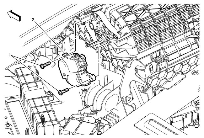

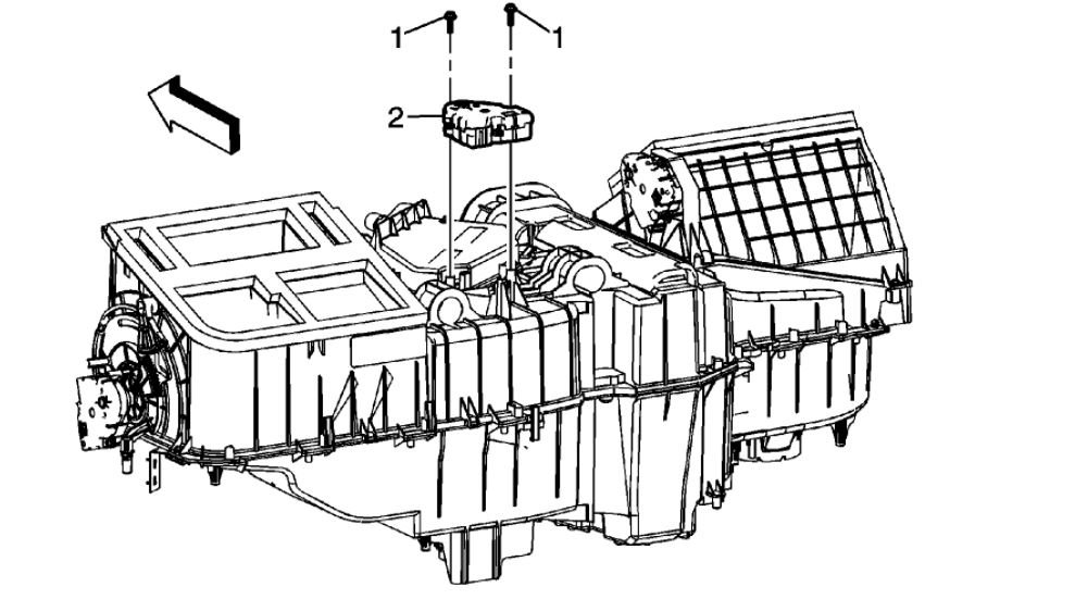

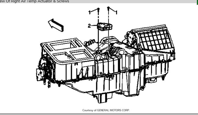

Okay, there are four actuators. the one you need is on top of the heater case. I attached a picture for you to view. To access it you need to remove the passenger side airbag. it will be visible when that is removed. Make sure you disconnect the battery before this repair.

The drivers side is an easy replacement. I sent you the procedure for the passenger side. Sorry about that.
Nothing to remove but the cover under the left side of the dash. That is held by a couple of screws. the blend door actuator is right there. the correct picture attached.

After I get it in, do I need to perform a re-calibration? If so, in the steps that you provided way up top, I do not have a HVAC/ECAS fuse. See attached.
Thanks a million again,
Gary

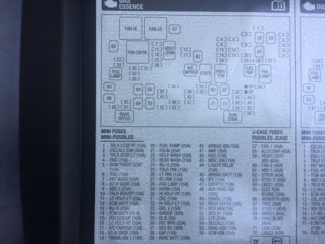

Yes, the calibration.
Fuse 39 as marked AC.

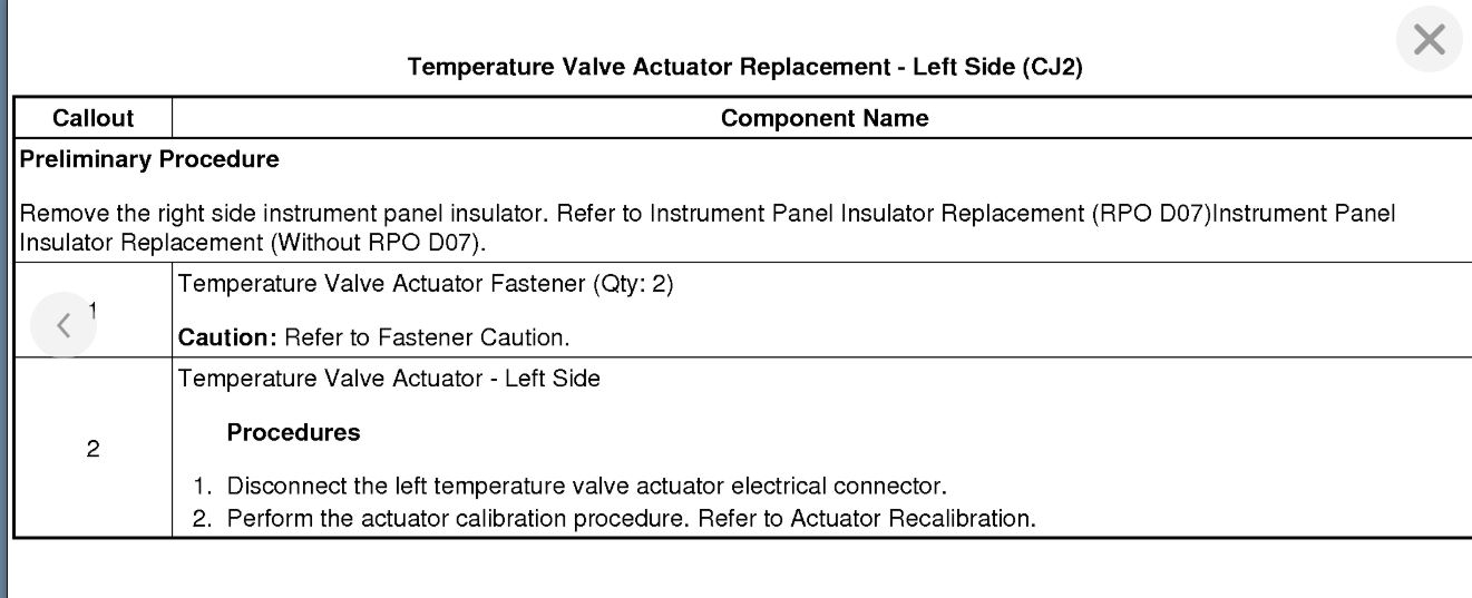

It will be located under the dash on the HVAC box. It's actually easy to replace.
To get you started, here is a link that shows in general how it is done. You can use this to help guide you.

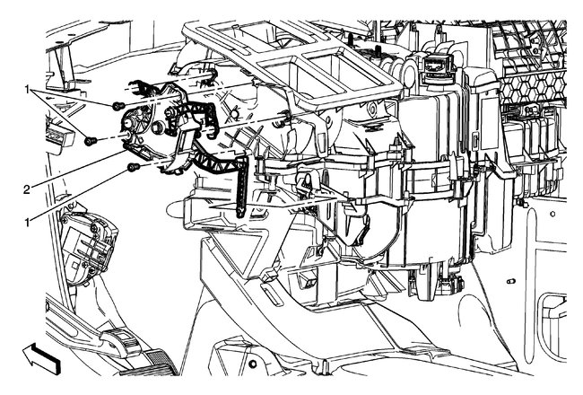

If you look at the picture attached below, it shows the directions/picture specific to your vehicle for replacement.
See pic below.

Yes, there is one for the right side as well. It is more difficult to replace. I attached the directions below for replacing it. (pic 1)
Also, pic 2 shows the recalibration procedure when you replace it. I forgot to add it the first time. Note: The recalibration shows doing it with a scan tool and without the scanner.

The left door is under the dash by the center. you need to remove the console if you have one.
The right door is on top of the heater case. the entire dash has to be removed to access this one.
