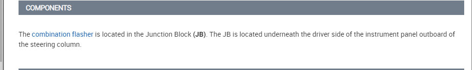

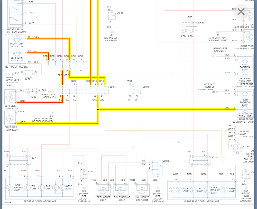

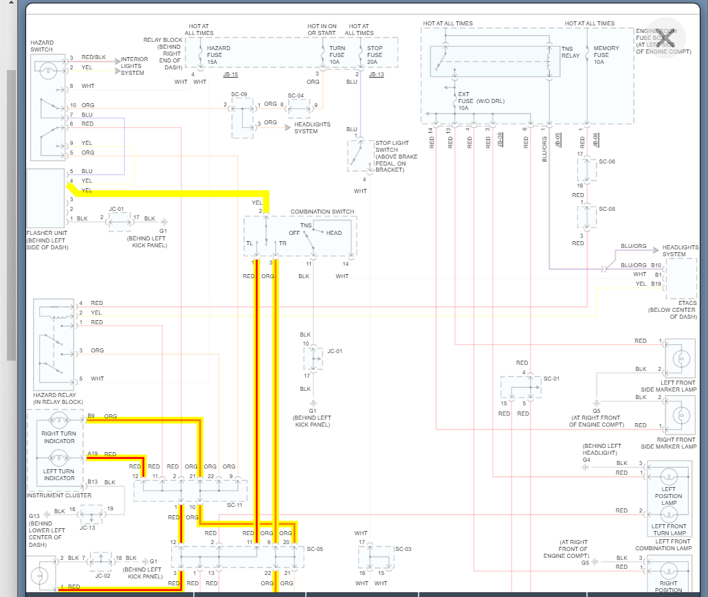

The relay for this is on the left side of the dash.
However, I am attaching the wiring diagram which will show that the relay would be the likely cause if the indicators and the turn signals are not working.
So, take a look at this info below and let me know if you have questions.
Thanks
