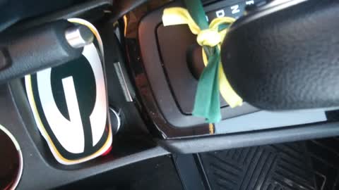

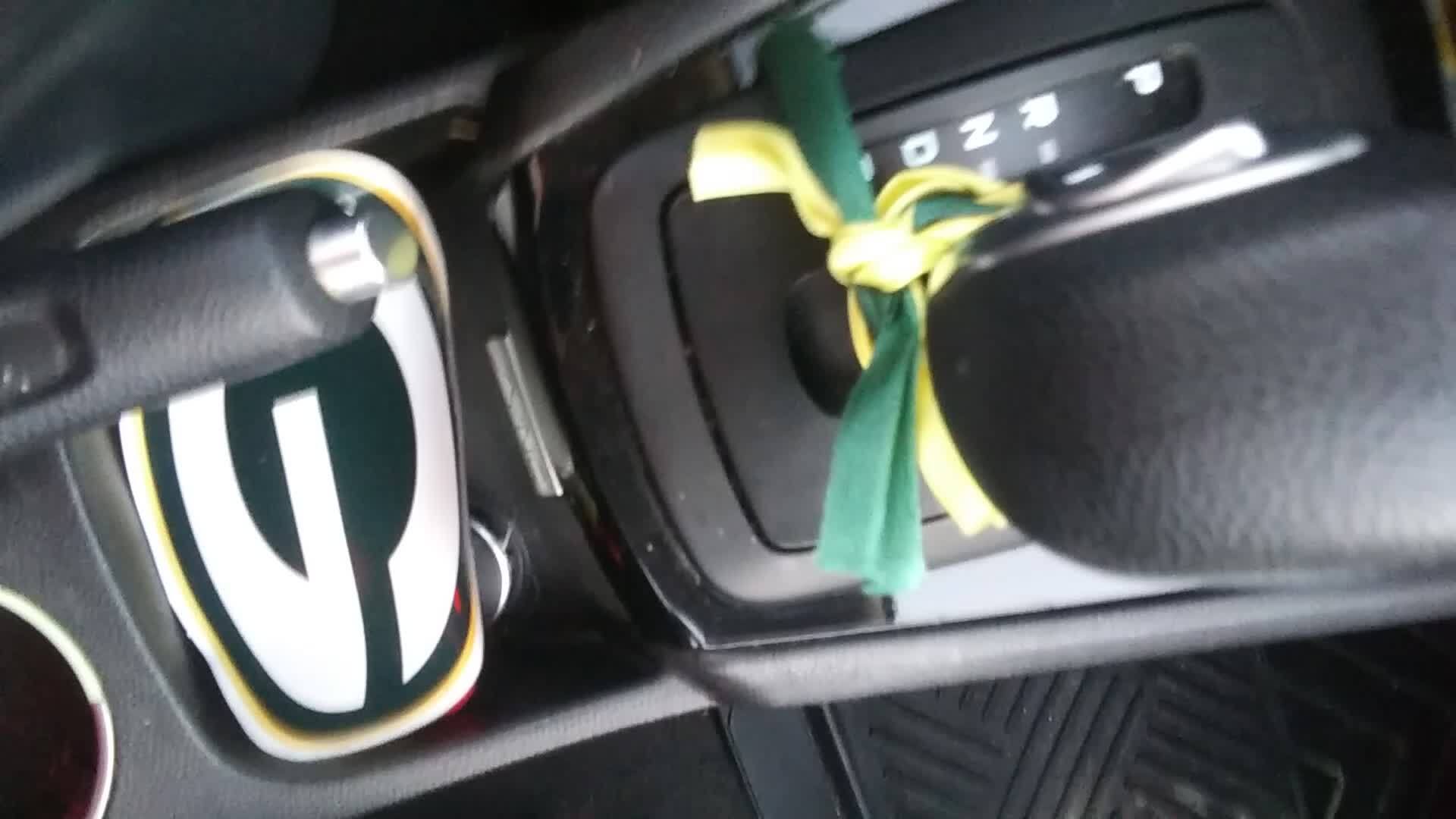

I have a video. Not sure if you can hear anything or not. It is very faint, but figured I'd give it a shot. Also, the car has 91,000 miles.
I really appreciate this.

Video attached.

Thank you for the video. I could hear the noise. It sounds like a heat shield is loose for the exhaust manifold or exhaust system, with the engine cold use a rubber mallet to hit the exhaust system to see if you can duplicate the noise.

I'll let you know what i find. I am surprised you can hear it. Most people cannot because it is so very faint.
