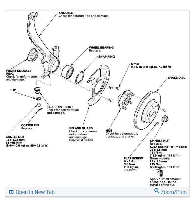

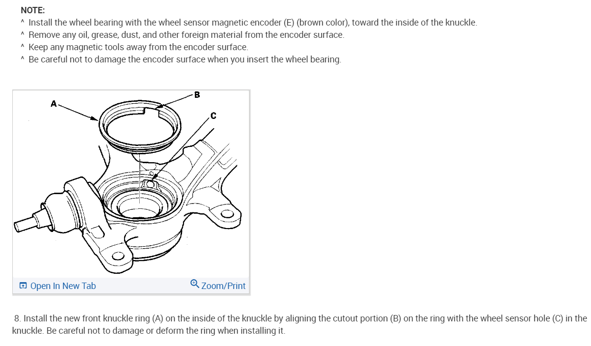

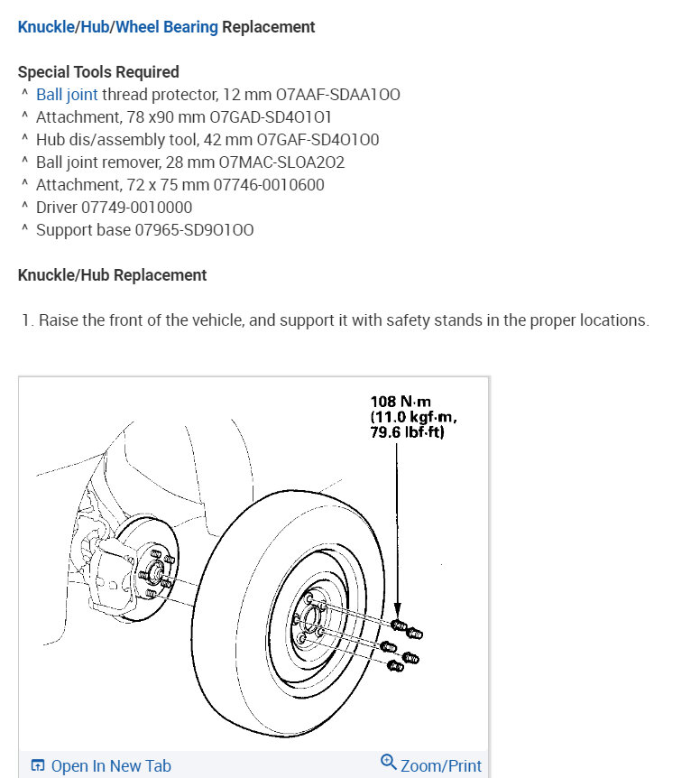

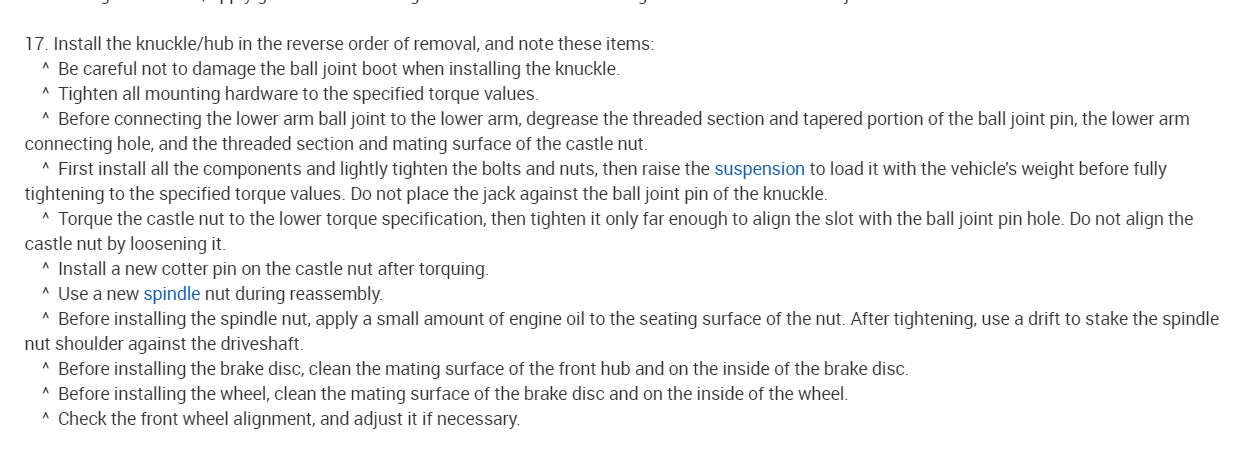

I have the car listed above ex shy of 400,000 miles, that I'm fixing, and I can't for the life of me figure out where the clicking and clunking sound is coming from when I make left turns and when I brake. I have changed the inner and outer tie rods, brakes, lower ball joint, and cv axle on the passenger side for all OEM. The sound will not go away. Lower control arms are brand new also, they have about 2k miles on them. I keep hearing the sound when turning left at low speeds and breaking. Any idea what it can be? Someone has said maybe the wheel bearing or steering rack not sure if those are viable options
Jun 15, 2023 at 7:48 PM
  • 54,840 POSTS

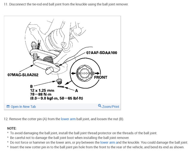

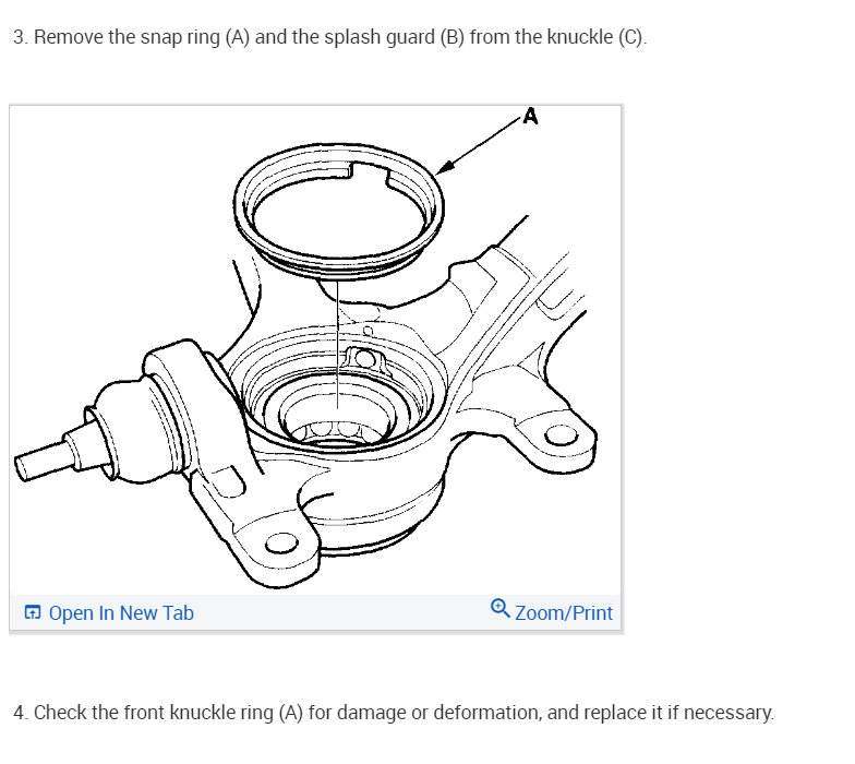

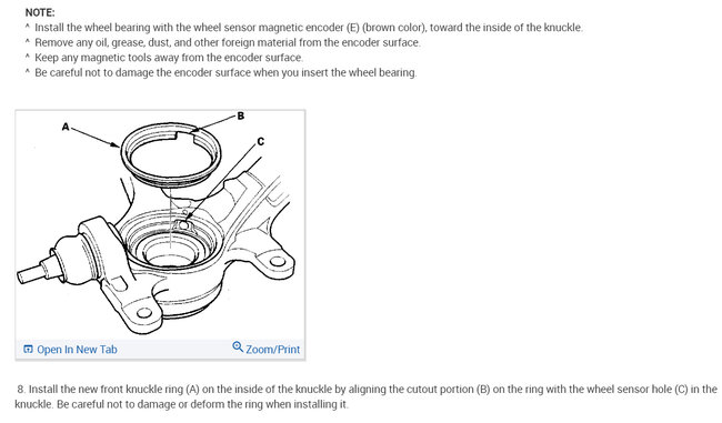

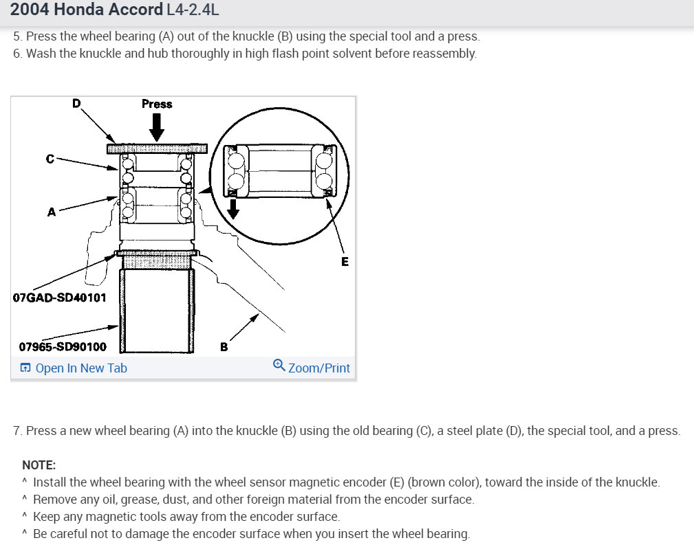

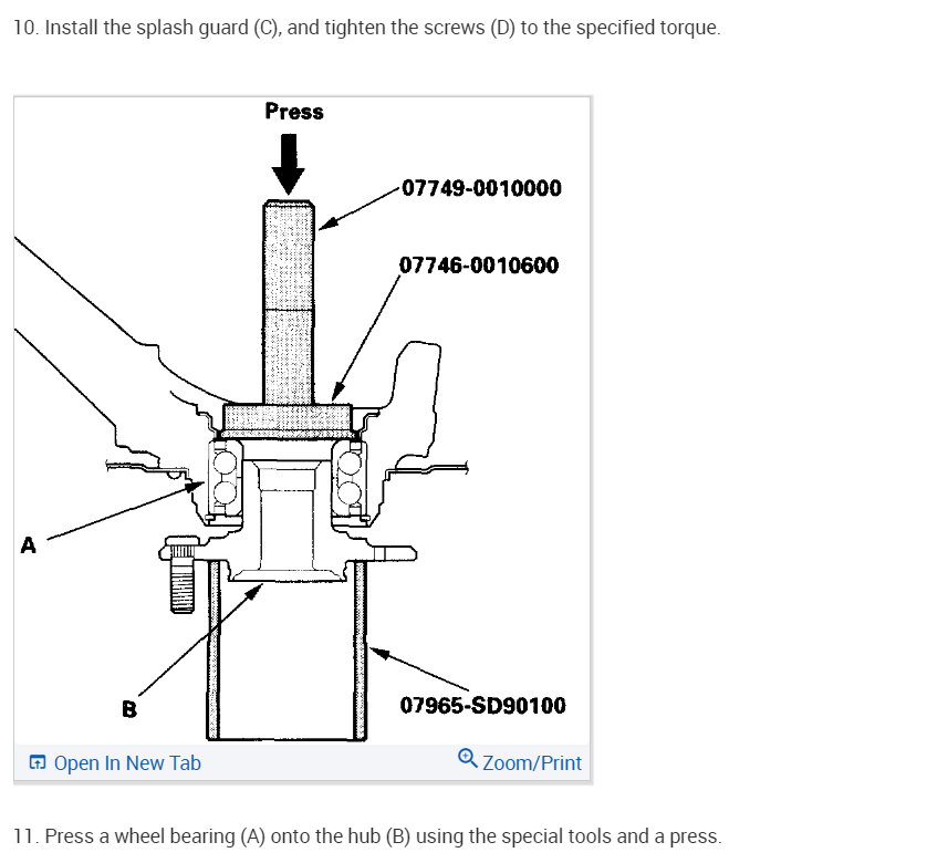

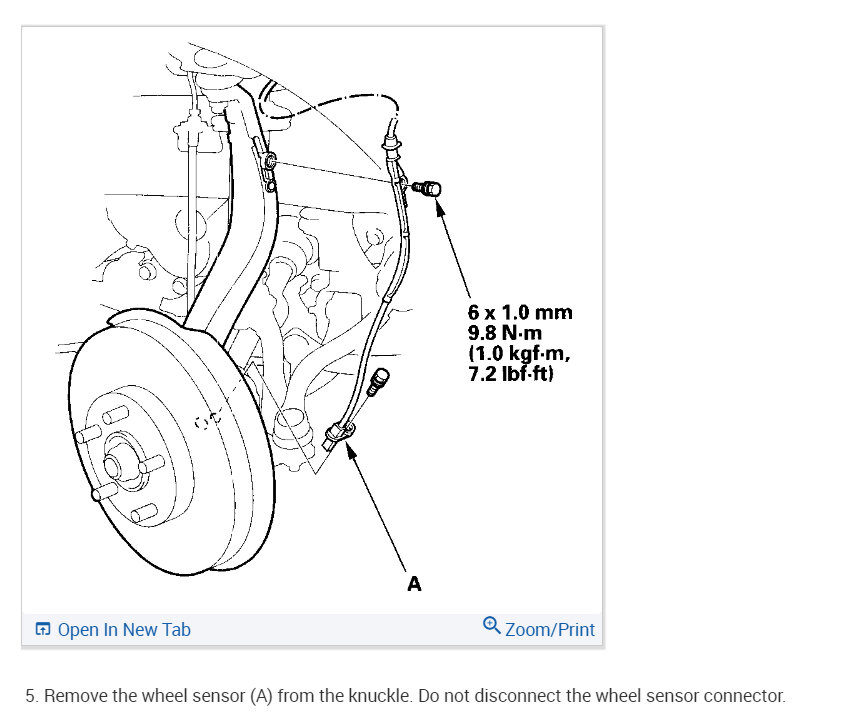

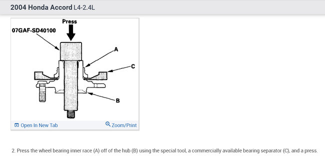

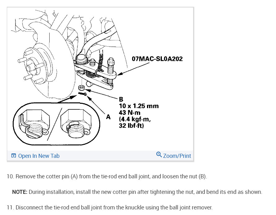

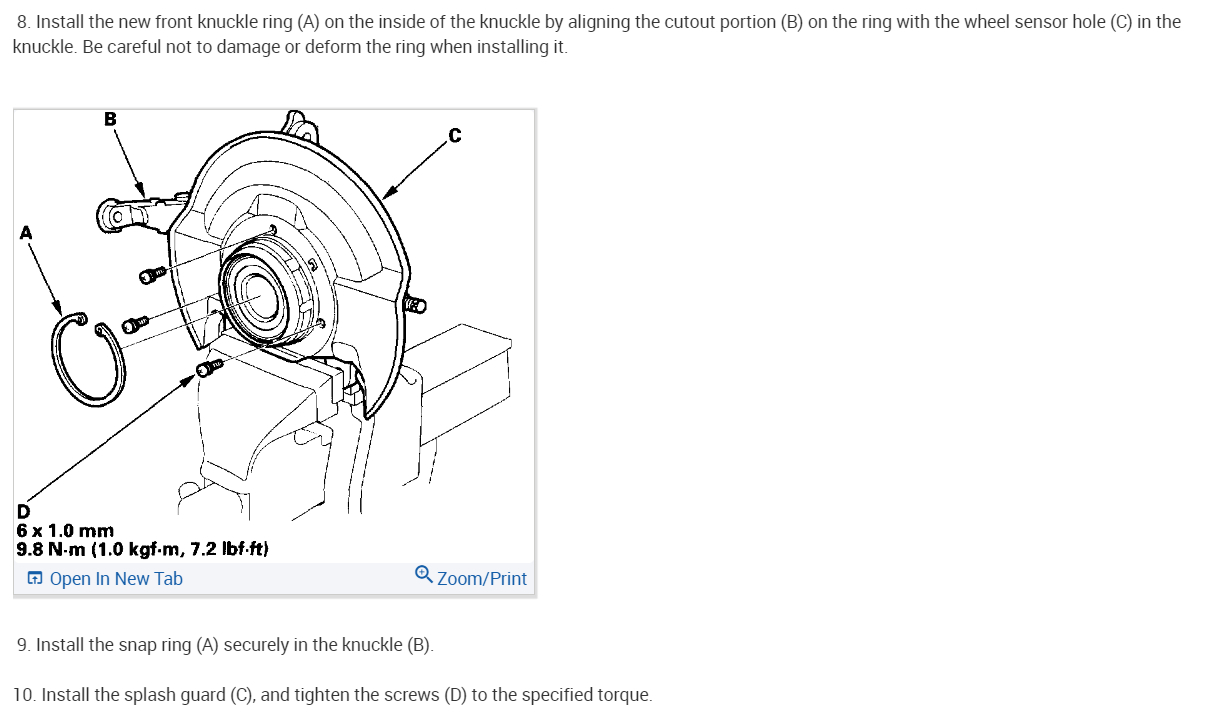

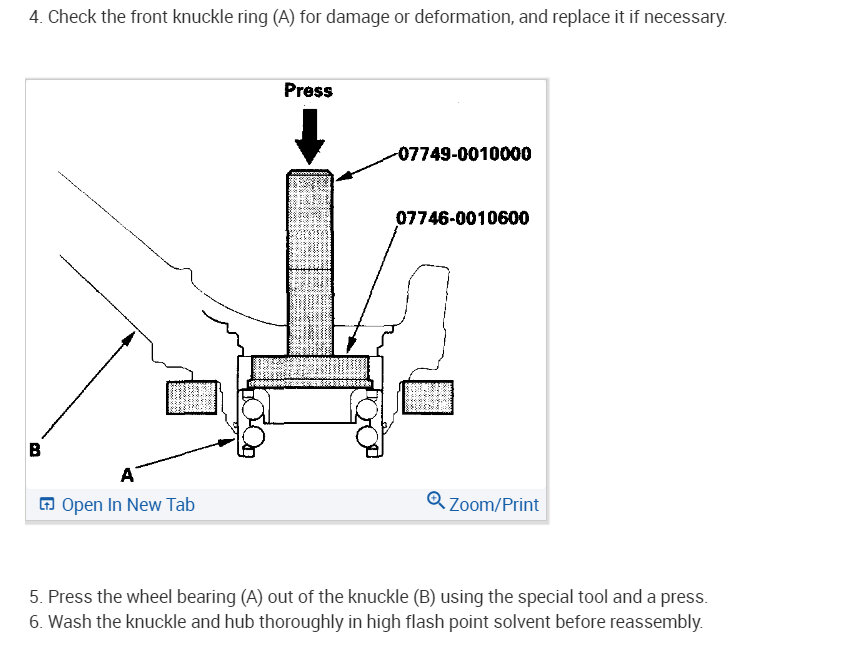

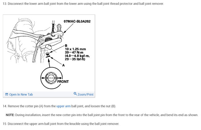

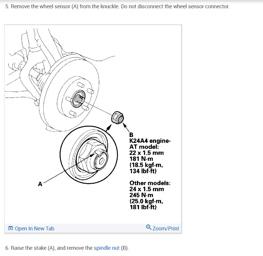

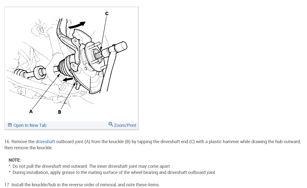

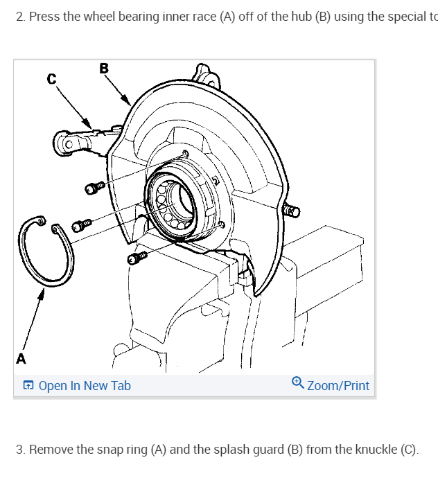

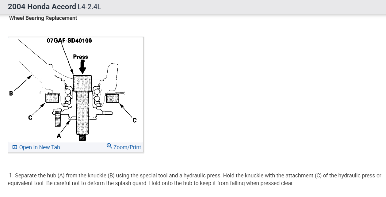

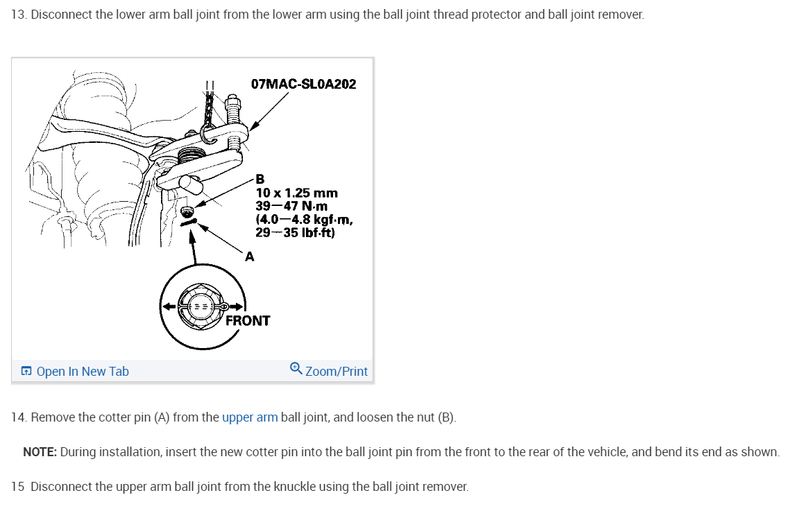

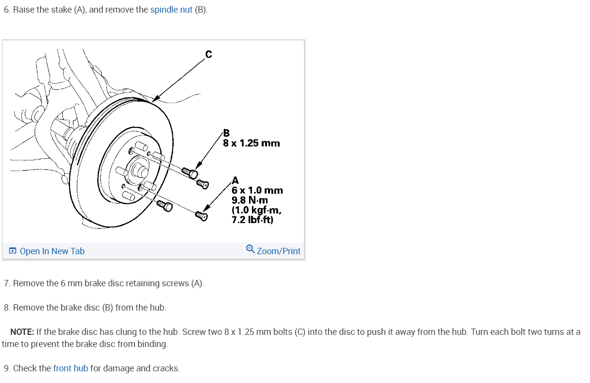

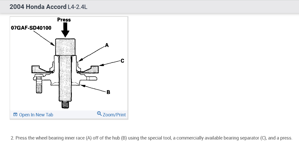

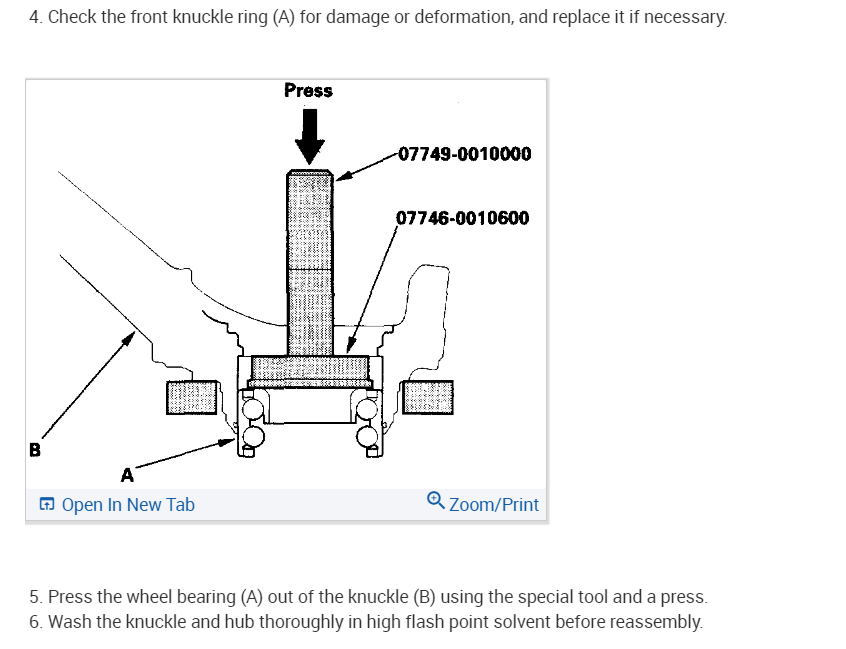

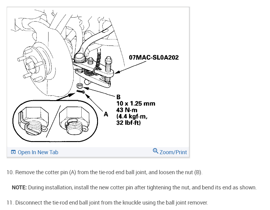

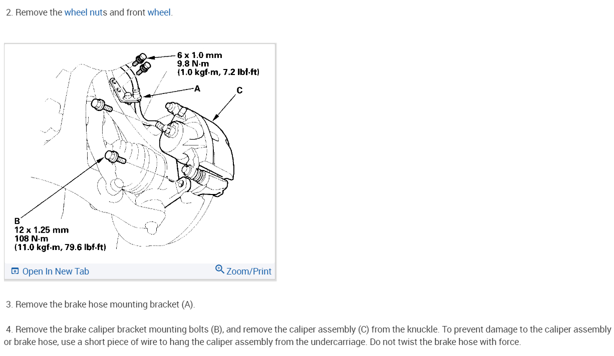

Yep, it sounds like the bearing hub needs to be replaced here are the instruction on how to do so, but to be sure can you please shoot a quick video with your phone so I can hear the noise? That way I can tell for sure what's going on. You can upload it here with your response.
This guide may help as well:
https://www.2carpros.com/articles/clicking-sound
This video will show you how to use the press:
https://youtu.be/_FzmmBoa4Tg

Thank you so much you were right. I just fixed it the sound is gone.
