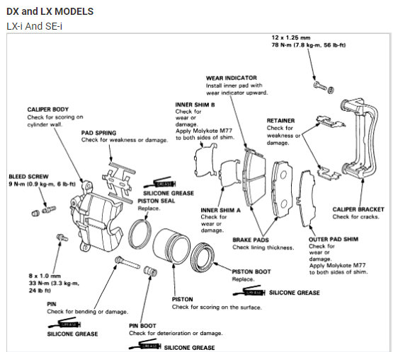

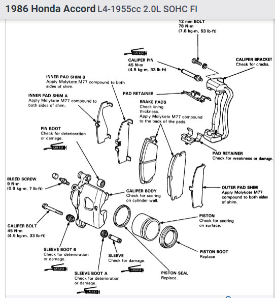

I park my car in a garage overnight. When starting it up in the morning, I back down an inclined driveway (about 30 degrees) and once I reach the level street and put the car into drive and straighten out the car, the brakes grind?

the brake noise your hearing could be that you need new front brakes. This video shows the job being done on a similar car but the process is the same.

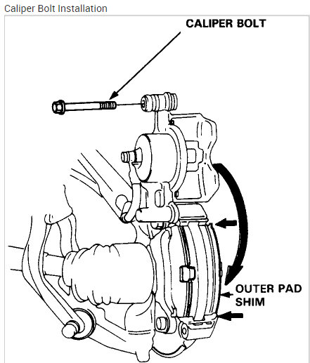

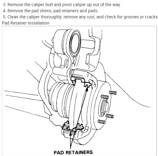

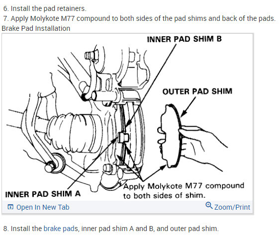

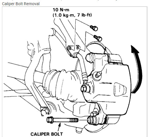

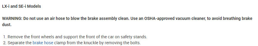

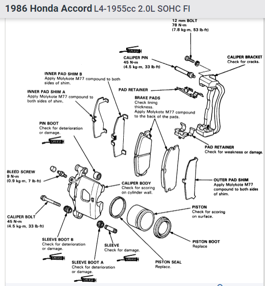

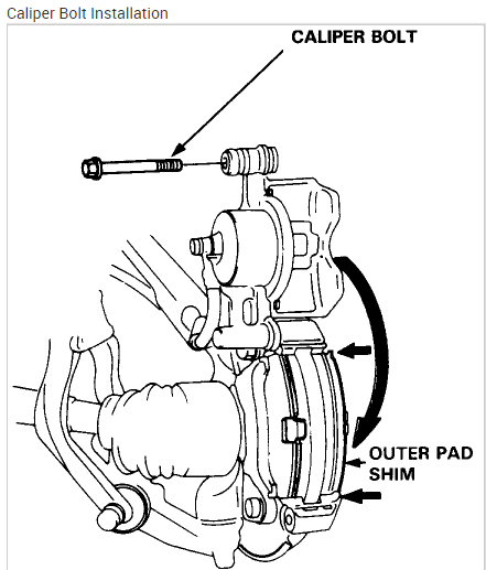

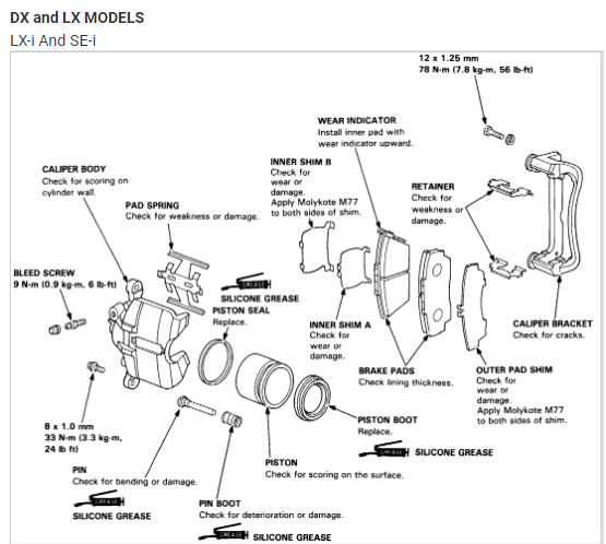

Here is the information you requested. This is a tutorial showing step by step what is involved on how to inspect and change front brake pads and brake rotors:
I've attached picture steps below on how to change the front brake pads and rotors on your car. Hope this helps and thanks for using 2CarPros.
