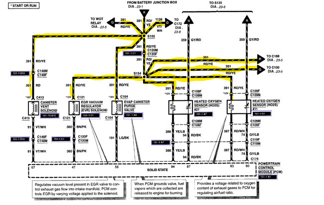

The truck had a check engine code for EVAP leak and I replaced the gas cap and purge valve. When I cleared the code it threw 12 codes would there be a reason for that? Some of the codes I can remember off the top of my head were camshaft, o2 sensors, EVAP purge valve, evap leak, torque converter, solenoid a, and shift solenoid.

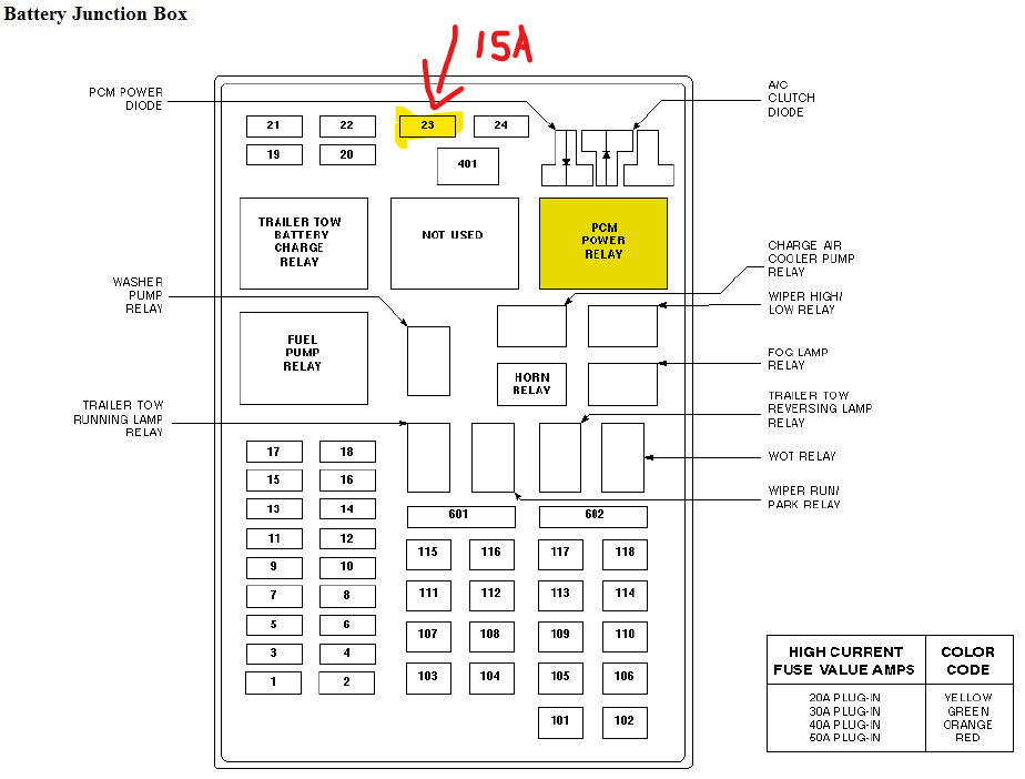

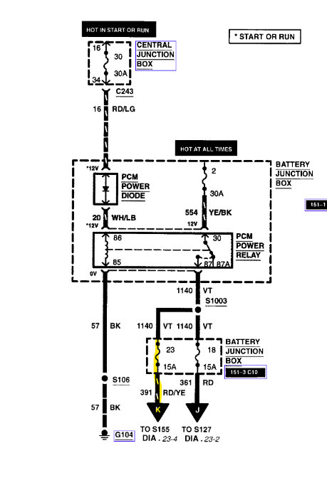

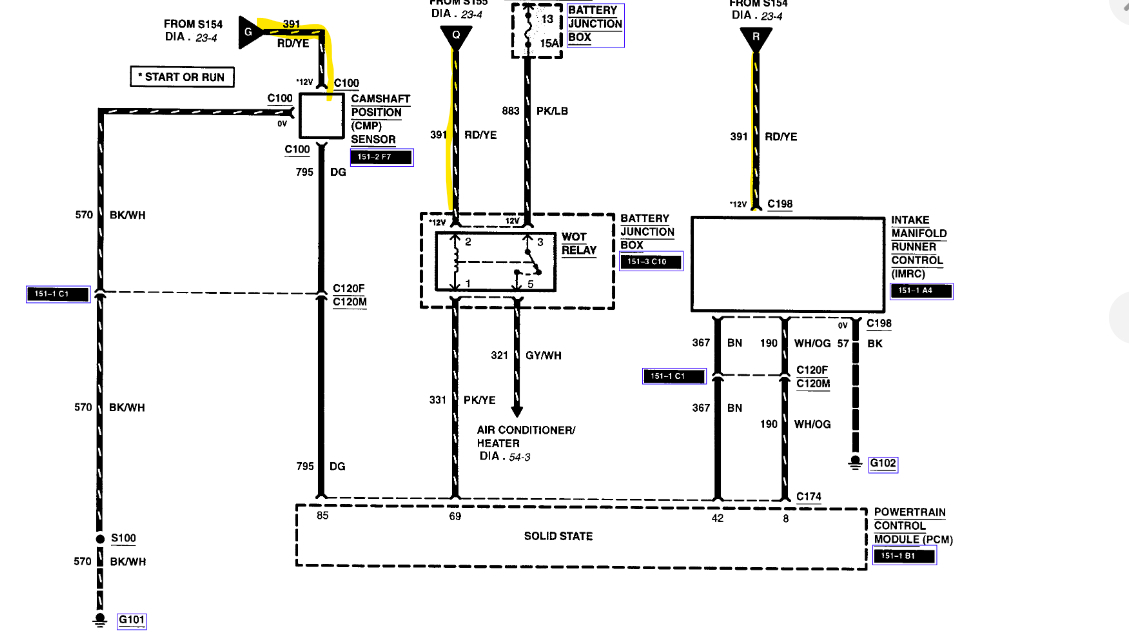

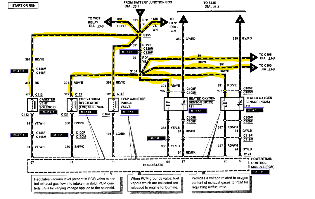

All of the codes that you received have one thing in common, fuse number twenty-three in the engine compartment fuse box. More than likely it will be blown and on more than a handful of occasions I have found the wire harness rubbing against the EGR pipe on the passenger side causing a ground short of this circuit. Another common cause is the cam sensor/synchronizer failure causing a ground short also. The bushings in the synchronizer give out and will give you the tell tale "chirp" which will lead to the sensor being impacted by the synchronizer. Last but not least, general wire rubs through at the oxygen sensor harness against the exhaust, a good visual inspection is usually the quickest way to check this. I've attached some wire diagrams of this circuit and the fuse that powers it, also the fuse location.

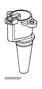

could you tell me which coil system you have ?? 8 plug leads running back to 2 coil packs ... or 8 coil on plug system ... if it's COP (coil on plug) .. try replacing #1 coil this is a coil on plug
https://images.2carpros.com/forum/automotive_pictures/266999_cop_1.jpg
