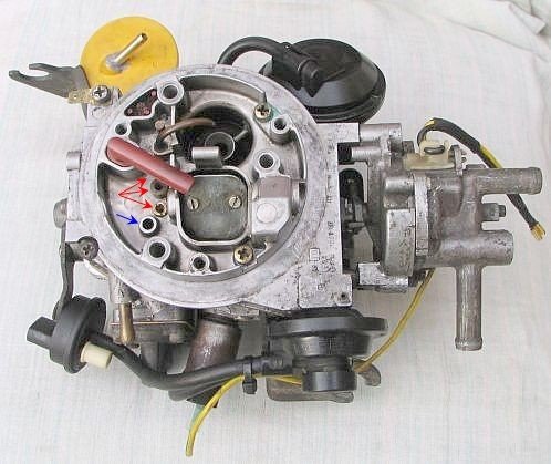

Hi,again.
I have 2E3 pierburg carburetor and i would like to add another question about the cleaning.Besides just spraying the carburetor cleaner (as the instruction says) on the top of the carburetor when it cold and inside the throat while the engine is running.
is it a bad idea to spray the carburetor cleaner inside the 3 jets as you may see at my attached photo with 3 red arrows?(the idling jet/air corrector jet primary venturi/air corrector jet secondary venturi).
I guess it is a bad idea,since,i think it will contaminate the fuel inside the carburetor or will clog something else,but i am not sure.
If not,can i screw out the three jets,clean it with the carburetor cleaner and screw it back?
Refer to my blue arrow at my photo,is it normal that i can see through that hole the fuel inside the carburetor?is this hole intended for visual inspection of the fuel level or something?
Thanks.
May 19, 2020 at 7:55 PM
You can spray it through those ports with carburetor cleaner. It will clear the ports of any debris unless there is something hard in the port.
Is there any issue that you have removed it for cleaning?
May 19, 2020 at 8:33 PM
XCHCUI
  • 91 POSTS
No,i didn't remove the carburetor. i took this photo from the web,it is the same as mine.
So,when i asked about spraying the carburetor cleaner into those ports,i meant doing that while the carburetor is not dismantle.
Isn't there a problem that this spraying action will contaminates the fuel with debris that will fall inside the fuel chamber and cause issue/clog something?after all the other side of those ports are immersed in the fuel chamber which provides fuel for all the system.
May 19, 2020 at 9:45 PM
Okay, makes sense.
Yes, you can spray into those ports. Do not do it with the engine running. It may spit back at you and you do not want to run the risk of a fire.
May 19, 2020 at 10:10 PM

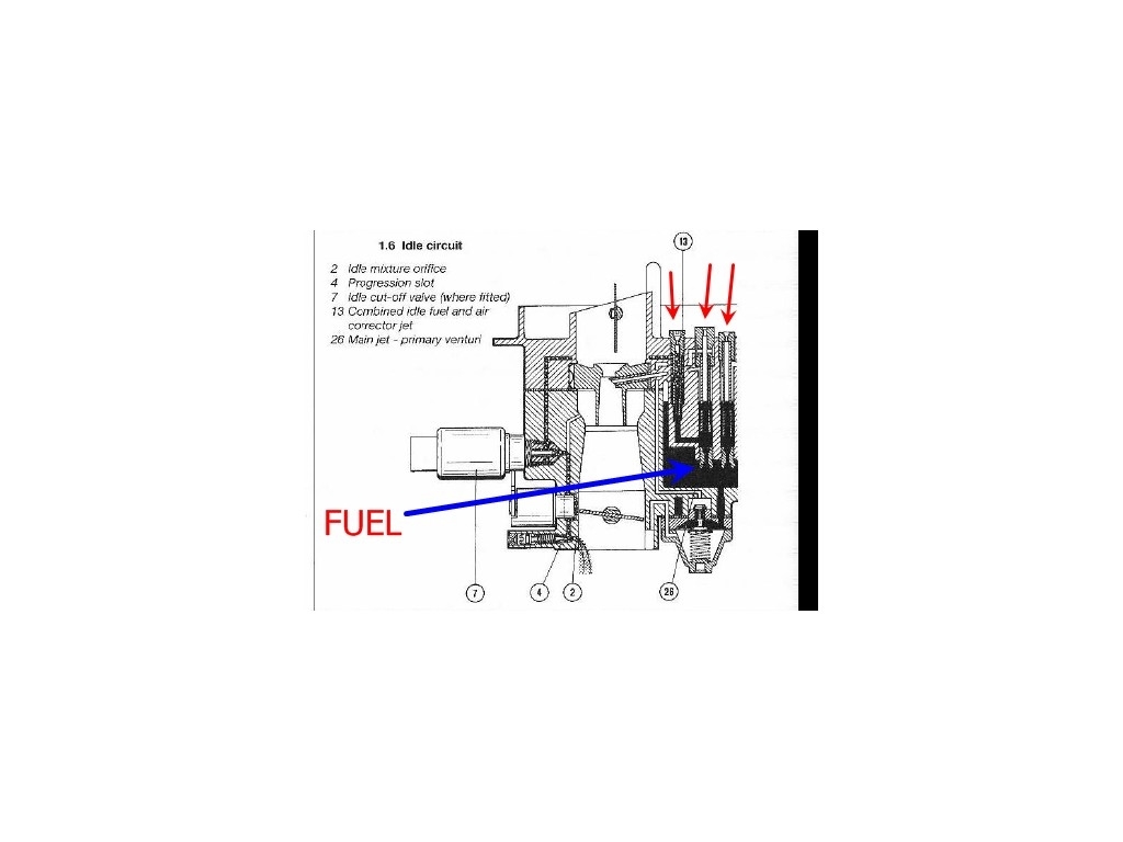

I understand that i can,but may you give some explanation to support your advice? May you please explain what will happen to all the dirt and the debris that will fall into the fuel chamber(together with the cleaner itself)while i will spray the carburetor cleaner inside those ports (see attached photo)?
May 20, 2020 at 1:36 AM
XCHCUI
  • 91 POSTS
I would like to verify if i understand your answer,since i want to be careful and don't do any stupid damage. Is there any risk that the dirt/debris that will be collected at the bottom of the bowl will eventually flow through the carburetor passages and clog something?(as you may see in my last photo,the fuel flows from this bowl to every point in the carburetor)or i don't need to worry,the dirt/debris will stay in the bottom of the bowel and they don't have any chance to move from there and clog something?
May 20, 2020 at 3:07 AM
There is always a chance that the dirt can go or get sucked out and into the motor but under normal driving conditions, it is doubtful.
When it does happen is when you run out of fuel. At that point, everything on the bottom of the bowl will be drawn into the engine.
There will always be a certain amount of dirt in the bowl just from the gas itself.
May 20, 2020 at 3:14 AM

As i mentioned before,will it be more efficient to screw out
the three jets and clean them outside or i better not do that since trying to screw them out may cause problems?
May 20, 2020 at 11:25 PM
Yes, remove them and clean them out.
Use 2+2 carburetor cleaner or Brake Kleen. Both are good products.

Thanks,Roy.I guess i better remove them for cleaning.
Do you have any highlights or warning about removing and returning the jets?for example:when i screw back the jets,does it matter how much i screw them in?is there any spec that i need to be aware of?
May 21, 2020 at 9:44 PM
No, there is no spec for them at all. Make sure they are tight when you install them.
Clean them up and install and not use anything on the threads.
May 21, 2020 at 9:55 PM
