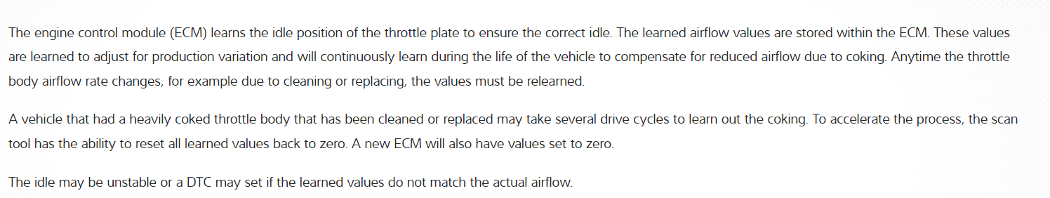

When I started car the idle is rough and got a message across the instrument panel stating Engine Power Reduced.

Hello, the vehicle is going into what is called "Limp Mode" or Reduced Power mode because the engine computer (ECM) is detecting a fault, and it's commanding the TAC (throttle Actuator Control system) to only allow the engine to get up to a certain set speed, this is depending on the fault detected. You will have to have the engine computer scanned for diagnostic trouble codes. Your local parts store can most likely scan the vehicle for free. They will give you a code, usually it will be "P" followed by 4 numbers. Did this happen after you cleaned the throttle body? Did you force the throttle plates open by hand?
Also did you spray any solvents into the throttle body area? And/or was the intake Air boot put back on properly, there's no loose hose clamps or anything like that?

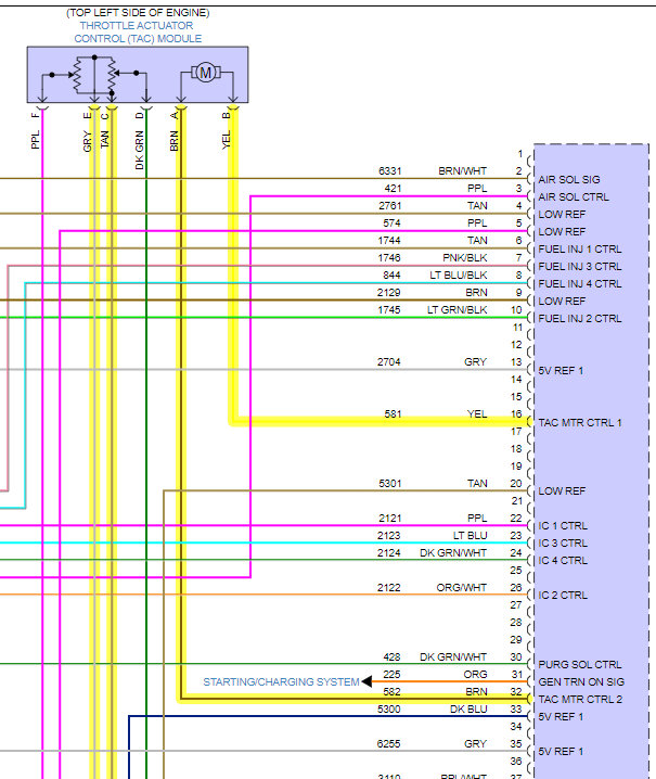

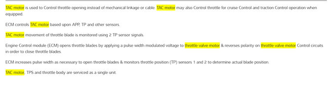

Is the check engine light on or been on since doing this? The ECM is in reduced power mode for a reason. You should have the ECM scanned for codes to see what's causing the issue. How did you remove the throttle plate? These systems are drive by wire systems. the ECM takes inputs from the sensor on the gas pedal (APP sensor, accelerator pedal position sensor) and uses those inputs for the fuel injectors pulse width and also moving the throttle plates. The throttle plates are controlled by a motor that is pulse width modulated and reverses the motor voltage to move the throttle plates in either direction. I'm posting the wiring diagram below to check the circuits, but since this happened while cleaning the throttle body, either some of the cleaner got into the throttle motor, or something happened to the motor while you were moving the plates around.
You can take the air boot back off, and with the key in the on position, engine not running, you should be able to see the throttle plates move with the gas pedal. But I don't think you're going to see that.

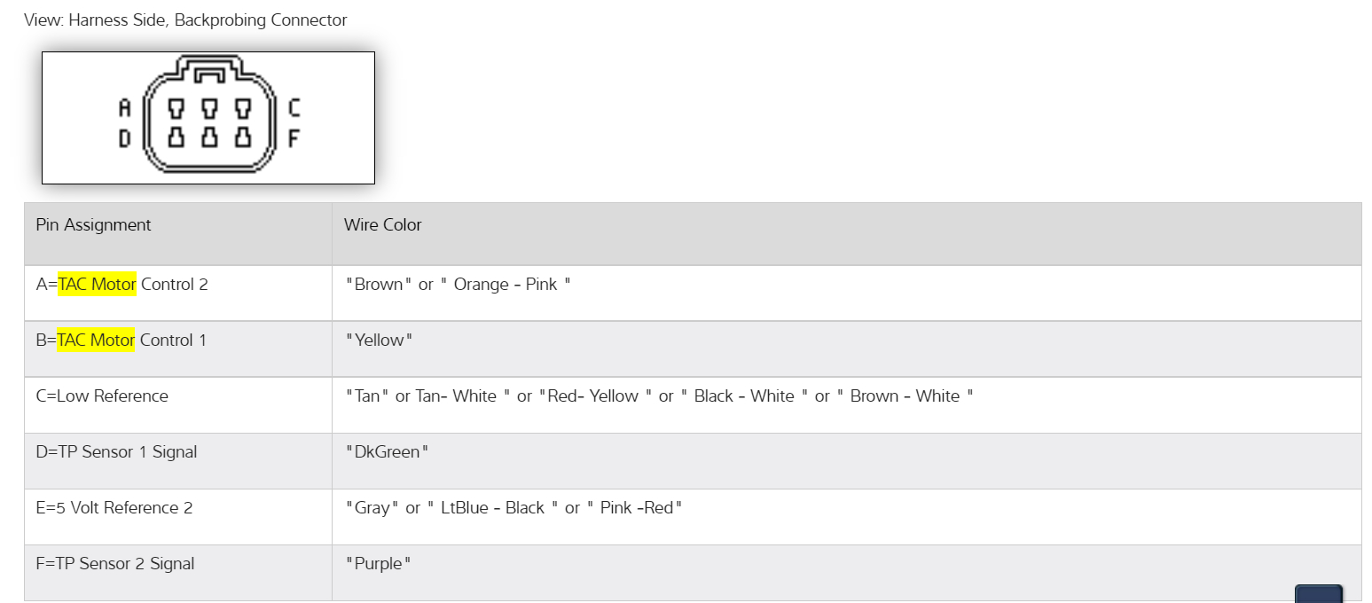

Checking the voltage to the throttle body is fairly easy, If you have a multimeter, you can back probe the connector at the throttle body. The grey wire is the 5-volt Reference feed wire, The purple and Dark Green wires are the Potentiometer signal wires going back to the ECM telling it how far open the throttle plates are. The Tan wire is the Ground. The brown and yellow wires control the motor for the throttle plates.
But get it scanned for codes, if there are no wiring issues or/and plates are not binding for some reason. You may have to replace the throttle body. AutoZone will scan the ECM for codes for free. Let us know what the code is, and we can give the code setting criteria and what exactly may have happened.

The code was P0507.

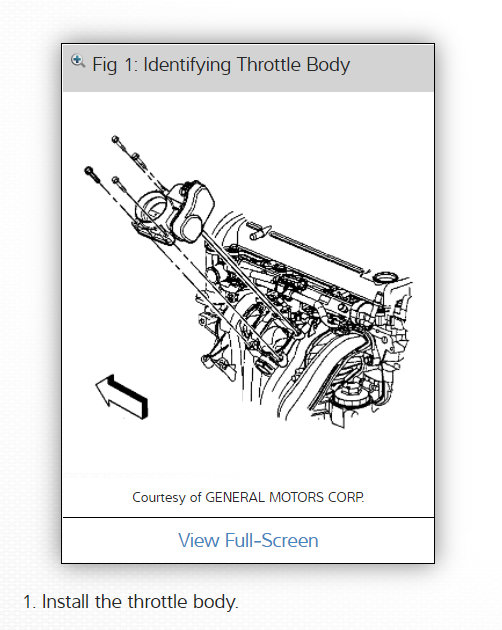

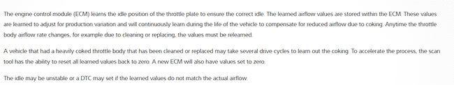

Okay, so p0507 is actually for "Idle speed 200 RPMs greater than desired idle speed". That could actually just be that the throttle plates are not closed enough. And allowing extra air threw, hence the high idle. It's not really that much higher really. You said you removed the throttle plate itself? Just the plate? Is it binding up or something due to not being installed correctly? Even the Throttle Position Sensor on the throttle body could be off by just a little bit. Is it adjustable on this throttle body?

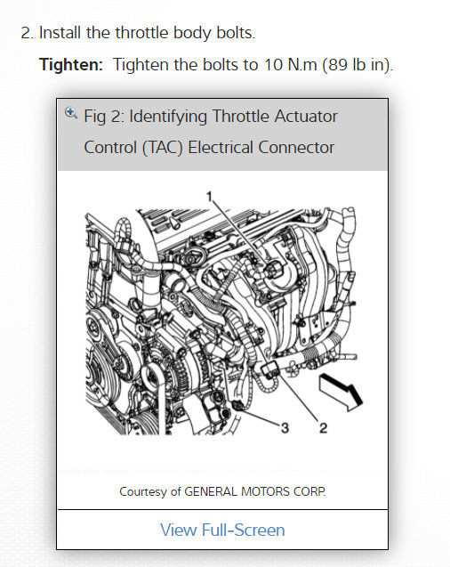

If you decide to just change out the throttle body, there is a relearn procedure you're supposed to do with a scan tool, key on engine off. But you might be able to get away with just changing it out and erasing the codes. The idle relearn will take a few drive cycles for the ECM to relearn where the idle should be. So, it will just take longer without a scan tool, or it might just work out okay. Below are the torque specs too.

The plate hast to be put back in the right position or it will scrape the throttle body therefore giving you that code just went through it myself works fine no relearning no code scanner involved. I did not buy a new one, did not take it to a shop, pretty easy to do, but your conversation really helped me figure it out. thanks
