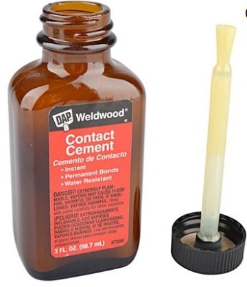

We will use contact cement. See my pic below. I get this a Wal-Mart in the hardware section, usually hidden on the bottom right side of the shelf. Hardware stores have it too. It's yellowish in color and somewhat stringy.
Ever so sparingly coat the valve cover's gasket surface and the top gasket surface of the new gasket with contact cement.
Orient the gasket before you apply it, as you don't want to apply it to the wrong side.
These glued surfaces will stuck to each other soon. the glue doesn't have to be thick, just completely wet the surfaces.
Wait a good 12-15 minutes then carefully stick them together. They should bond instantly so place them on there perfectly with the holes lining up.
Use your fingers to mash them together well.
Now we have a well sealed gasket to valve cover that will not move or suck under.

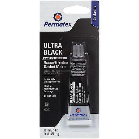

Last part. This is where using silicone comes in.
Coat the bottom of the gasket with maybe 1/16th of an inch of silicone.
Carefully place it on the head lining up the bolt holes so that it doesn't scoot around and wipe off the thin silicone you just put on!

So the silicone is this the silicone that you would install a window in your house with or rtv silicone, the black stuff?
Nov 17, 2019 at 11:33 AM
CJ MEDEVAC
  • 11,004 POSTS
This or something really similar, the plain black stuff in a tube is fine too. This oil resistant type was not around back during the dinosaur years!
