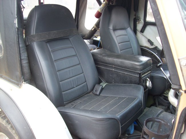

First, I gotta fix my driver seat, inner frame broke so it leans back & to the right. I'm not super tall so it makes it hard to depress the clutch fully. I'd replace but they're the factory seats and don't wanna lose them.

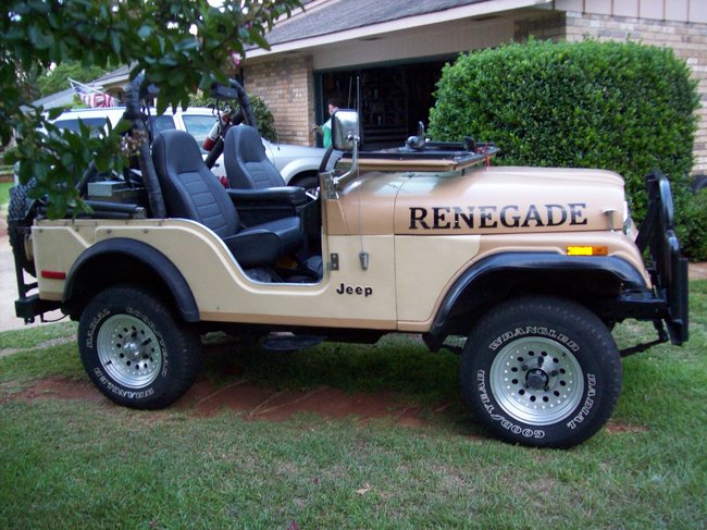

I've had a set of Bestop seats for several years sitting in my man cave, my buddy came over a few weeks ago and helped me put them in.
The ones we took out were "Steel Horse" which I installed back in 1991 when I got this CJ-5. I think there is a tear or two (or not) in them but that's all been covered up with nice vinyl seat covers. I'm thinking I got the covers just to protect the seats. It's tough when you can't remember stuff like you used to.
These Bestops are a little wider at the bottom and don't wedge my butt with the side pieces as the others did.
A picture from around 2010 of the old ones without the covers at the bottom.

As far as the seats, only my driver seat is having an issue and it leans back a little more than it should, and more on the right than the left. Passenger seat is fine.

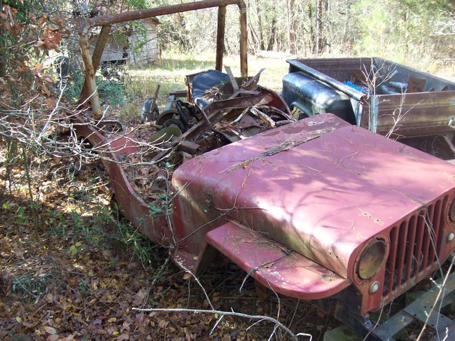

'Course, my buddy and I might have enough stuff out in the woods to do it ourselves. The ole red one might qualify all by itself.

Overall the seats look good, only the seat back leans for the driver. I've got a welder buddy, might see what we're can figure out before I order some

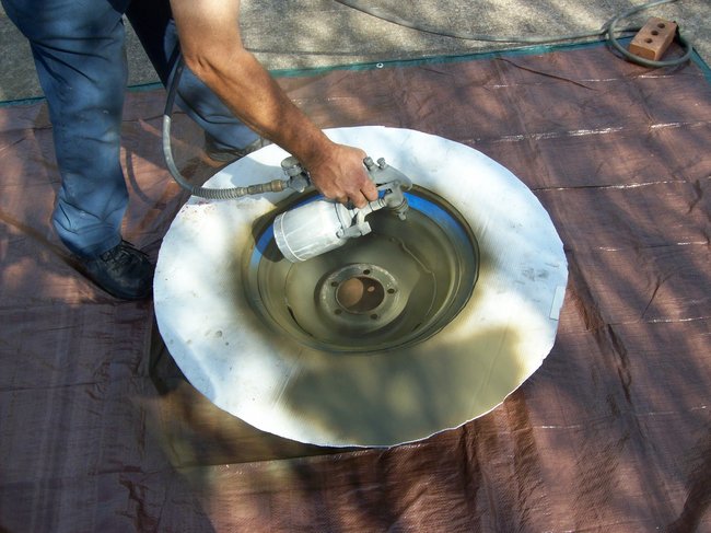

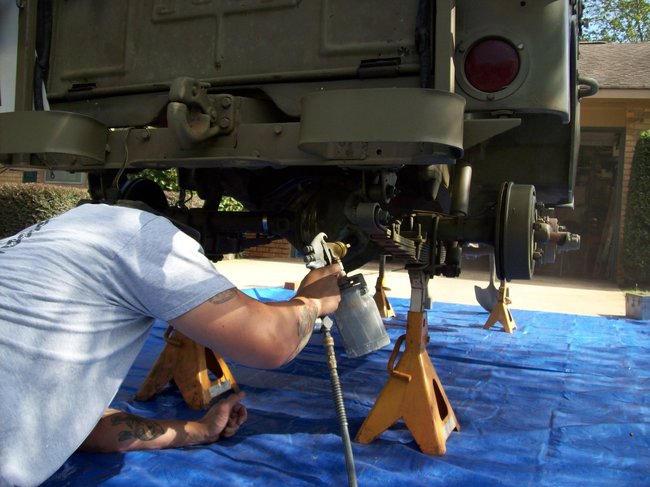

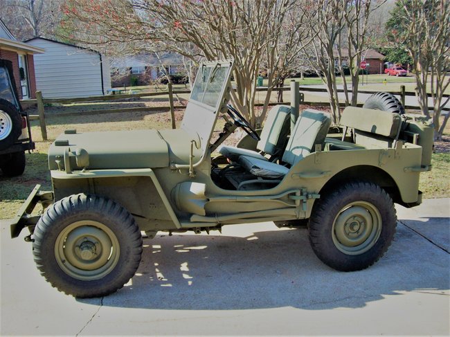

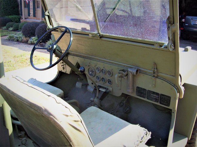

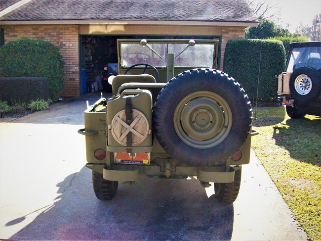

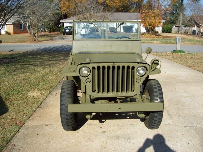

Here's some pics of Willy hours after my best paint job. This is before the insignia went on.
