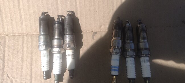

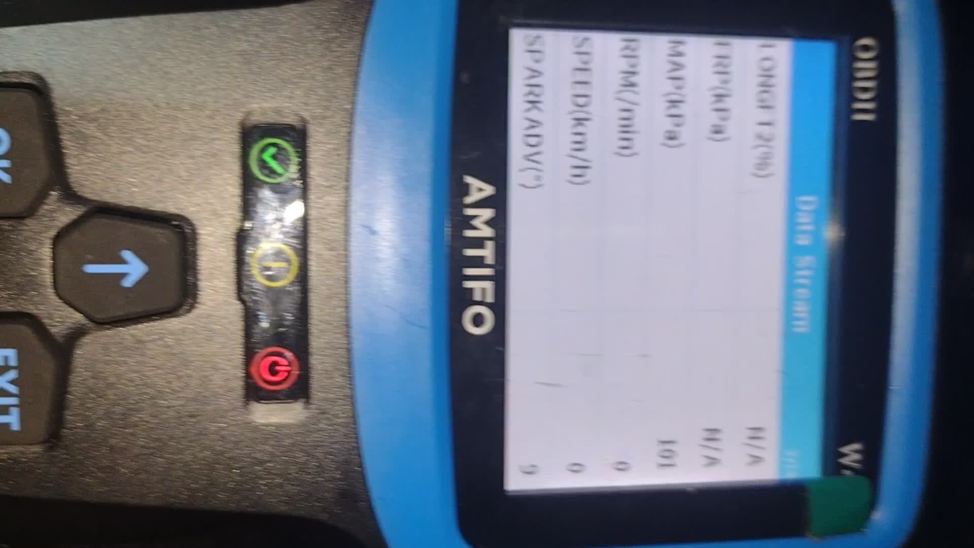

installed new preprogram PCM now it cranks, no start?
2001 CHRYSLER TOWN AND COUNTRY
144,000 MILES • 3.8L • V6 • 2WD • AUTOMATIC
CHRYSLER 01

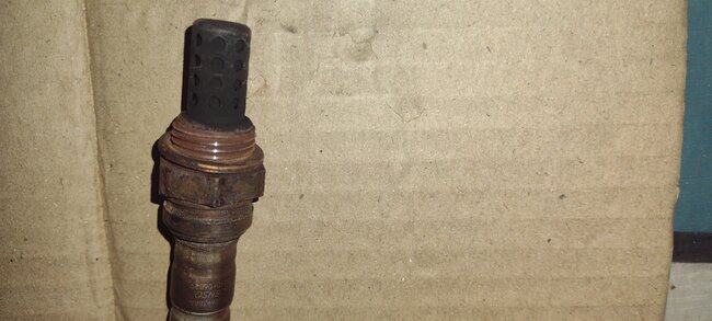

02 sensor
up stream
Mar 2, 2025 at 9:49 AM

spark plugs
Mar 2, 2025 at 9:50 AM
  • 55,443 POSTS
Thank you, do you see the one spark plug that is white? This will be the cylinder that is having the issue. So, it will be low compression, or the fuel injector is not working.
