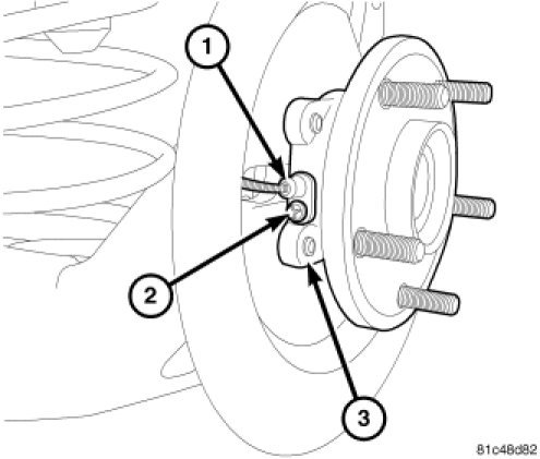

1. Access and remove rear brake rotor.See: Brake Rotor/Disc > Removal and Replacement > Brake Rotor - Removal
2. Right side sensor only - Remove exhaust heat shield above exhaust system covering wheel speed sensor wiring connector.

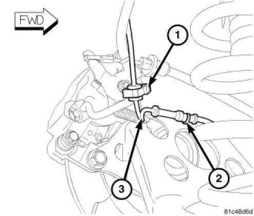

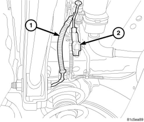

3. Disconnect vehicle wiring harness (2) from wheel speed sensor (1) connector.
4. Remove wheel speed sensor (1) from routing clips along underbody of vehicle.
pic 2
5. Remove wheel speed sensor (3) from routing clips (1) along brake flex hose.
6. Remove wheel speed sensor routing clip (2) from rear axle.
CAUTION: Prior to removal, clean area around sensor head to help prevent contaminants from entering bearing when sensor head is removed.
pic 3
7. Remove screw (2) fastening speed sensor head (1) to hub and bearing (3).
8. Remove wheel speed sensor from hub and bearing.

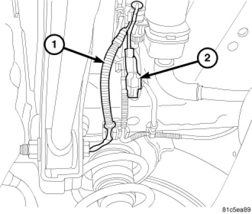

1. Apply bearing grease (supplied with part) to sensor head shaft and O-ring.
CAUTION: Ensure that sensor mounting surface on bearing is clean before sensor installation.
pic 4

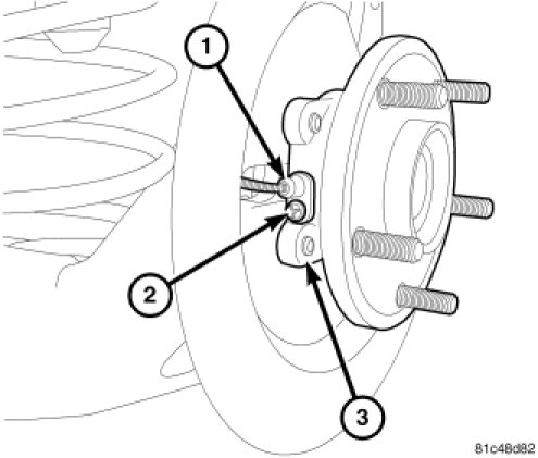

2. Push wheel speed sensor head (1) into mounting hole in hub and bearing (3) and align mounting screw hole.
3. Install NEW mounting screw (2). Tighten mounting screw to 6 Nm (55 in. lbs.).
