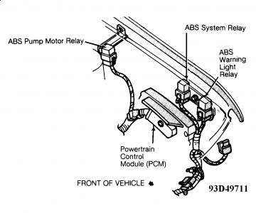

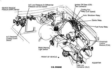

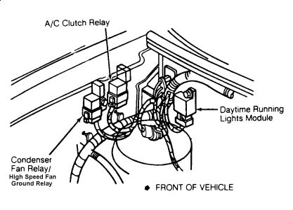

I have a 93 Town and Country that has just lost the hydraulic assist on the brake system. I know there is a recall for the ABS pump but I wanted to test to see if it was just the relay first. This year has just mounted all the relays unmarked on the inner fender so I can't tell which relay it is. Can any one tell me which relay it is or better still post a diagram of all the relays? Thanks in advance.

https://images.2carpros.com/forum/automotive_pictures/99387_Graphic1_441.jpg
https://images.2carpros.com/forum/automotive_pictures/99387_Graphic2_219.jpg
https://images.2carpros.com/forum/automotive_pictures/99387_Graphic3_104.jpg

Great pics. I have the 3.3L and none of those pics seem exact but definitely close enough to know what I'm looking at now. Thanks.
I'll check them out in the morning.
