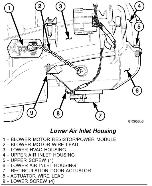

voltages are ok. motor resistance is open.is there a fuse inside the fan motor housing ? removed a nest with hooked wire. motor housing is too difficult to remove . will have a shop do it after i'am finished troubleshooting. . tom

The blower motor isn't too hard to replace. First, here is a link that explains in general how it's replaced. You can use it to help guide you.
https://www.2carpros.com/articles/blower-fan-motor-works-on-high-speed-only
Here are the directions specific to your vehicle. The attached pics correlate with the directions.

2. Remove the passenger side cowl trim panel.
Lower Air Inlet Housing
pic 1
3. Position the carpet to access the front upper screw that secures the air inlet housing.
4. Remove the recirculation door actuator.
5. Disconnect the blower motor wire lead connector from the blower motor resistor or power module, depending on application.
6. Remove the one screw (from the top) that secures the lower air inlet housing to the upper air inlet housing.
7. Remove the four screws (from the bottom) that secure the lower air inlet housing to the upper air inlet housing and the lower HVAC housing.
Blower Motor Wire Lead Grommet
pic 2

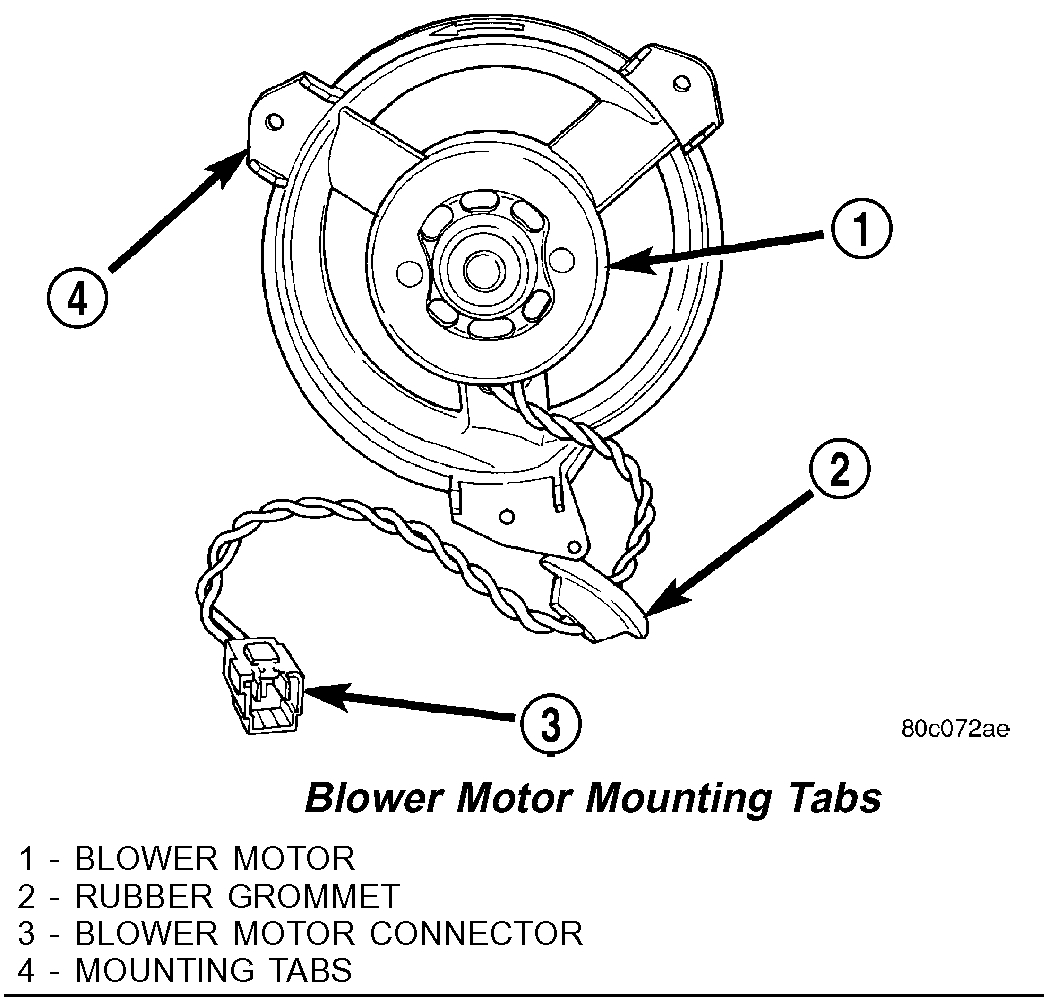

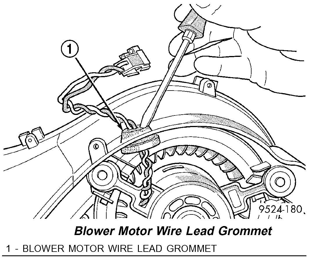

8. Push the rubber grommet through the opening in the lower air inlet housing.
9. Route the blower motor wire lead through the opening in the lower air inlet housing and remove the lower air inlet housing from the vehicle.
Blower Motor Mounting Tabs
pic 3
10. Position the recirculation-air door as necessary to access and remove the three screws that secure the blower motor to the lower half of the HVAC housing.
11. Gently flex the recirculation-air door downward to gain access to remove the blower motor from the HVAC housing.
NOTE: To aid in installation, note the position of the blower motor mounting tabs prior to removal.
12. Remove the blower motor from the HVAC housing by rotating and tilting the blower motor as necessary.
