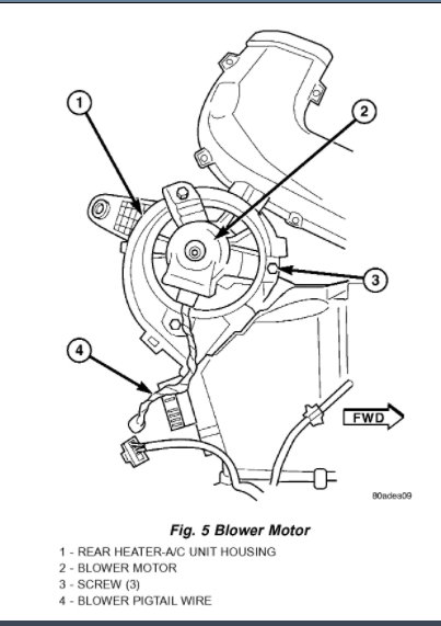

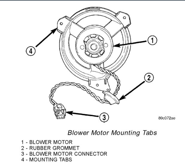

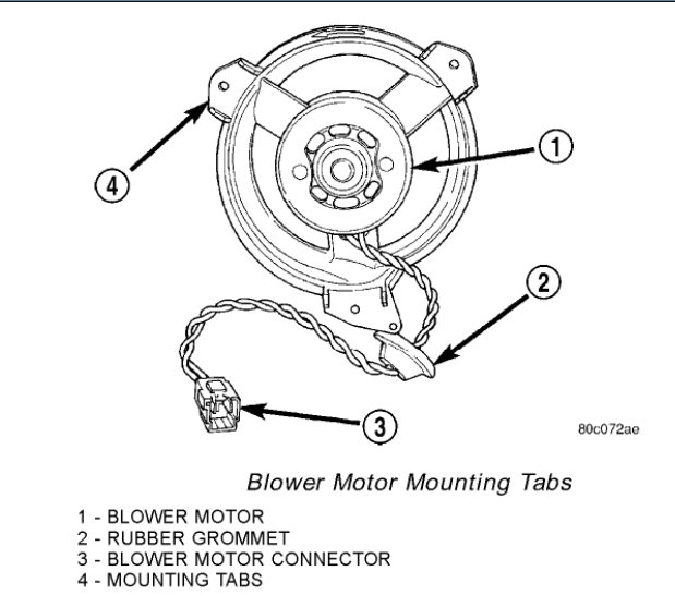

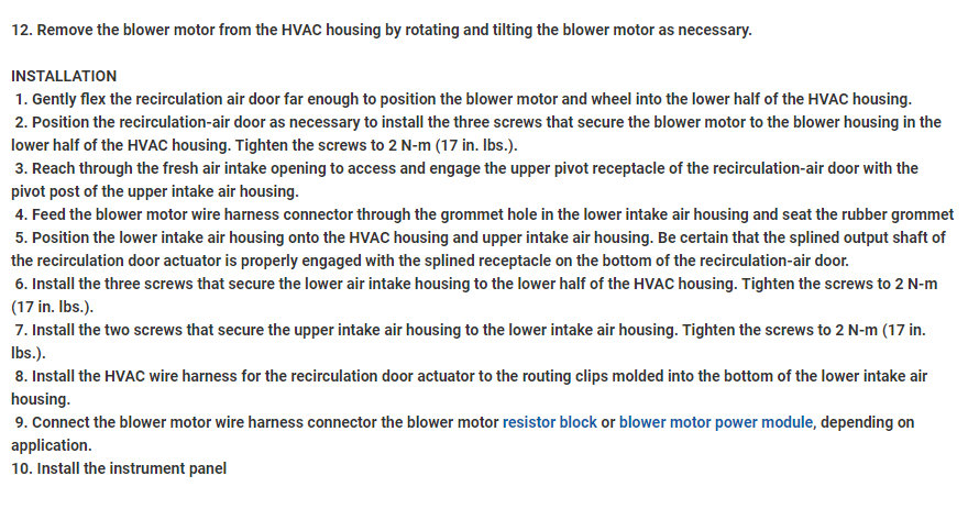

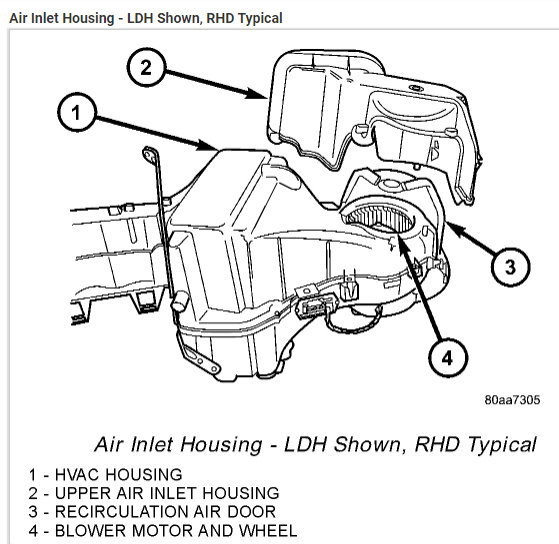

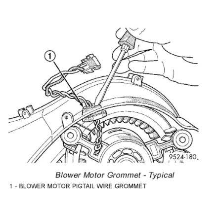

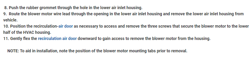

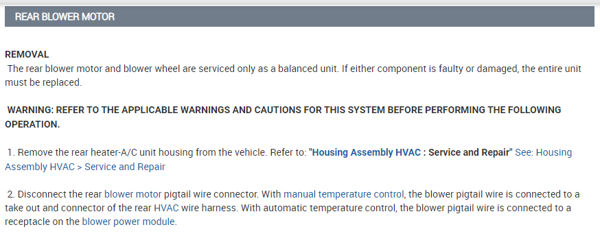

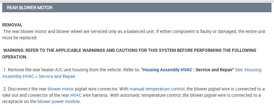

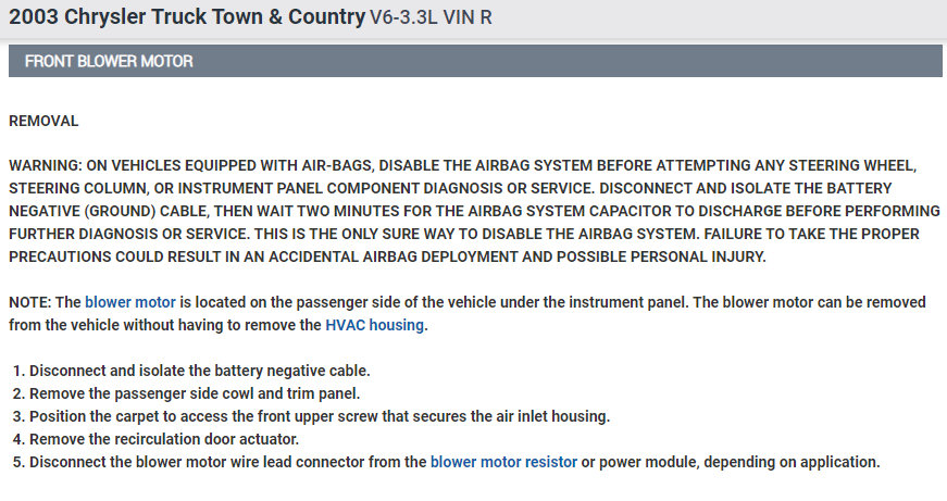

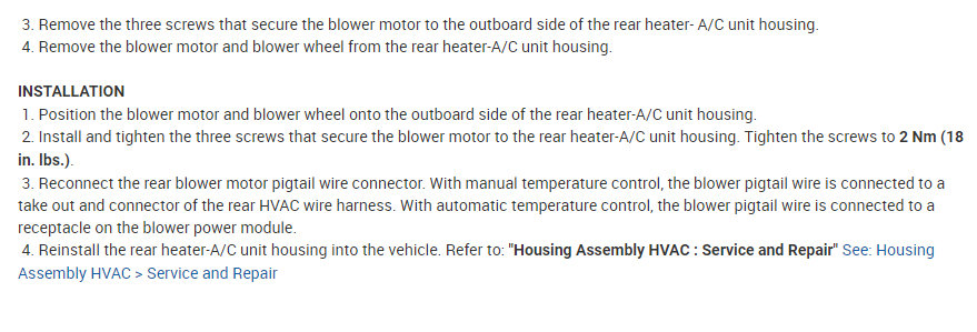

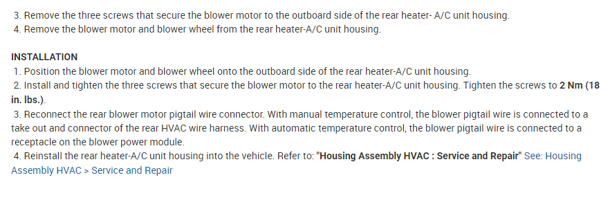

Is there any way to remove the blower motor cover without removing the dash?
Monday, January 11th, 2010 AT 1:48 PM
DANNY L
MECHANIC
5,648 POSTS
Hello, I'm Danny.
No, you don't have to remove the entire dash to change the blower motor. Here is a tutorial on how to change a blower motor:
https://www.2carpros.com/articles/blower-fan-motor-works-on-high-speed-only
I've attached picture steps below on how to replace both the front and rear blowers motors on your van. Hope this helps and thanks for using 2carPros.
