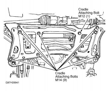

i am unable to remove the control arm pivot bolt because of the engine/tranny is in the way..... the haines manual does not break this down for this year.
i may have to drop the whole pan underneath to get this control arm out....
what is the best way to get the drivers side control arm out?
i have searched everywhere and came up empty, your help would be much appreciated.

Hello .. thanks for the donation .. much appreciated Removal (Control Arm) Raise and support vehicle. Remove wheel. Remove wheel stop. Remove ball joint-to-steering knuckle clamp bolt. See Fig. 1. Mark cradle location. Remove 10 cradle bolts, noting location of M12 bolt. See Fig. 3. Remove cradle. Separate ball joint from steering knuckle. CAUTION:Use caution when pulling steering knuckle from vehicle after releasing ball joint. The inner constant velocity joint can separate.
https://images.2carpros.com/forum/automotive_pictures/266999_town_1.jpg
Fig. 3: Identifying Cradle Bolts Courtesy of CHRYSLER CORP. Separate steering knuckle from ball joint stud using a pry bar. Loosen front pivot bolt. Remove rear bushing retainer. When removing left control arm, front suspension cradle needs to be lowered to allow pivot bolt to clear transaxle. Remove pivot bolt. Remove control arm from vehicle. Check control arm for distortion and bushings for deterioration. Replace components as necessary. Installation To install, reverse removal procedure. Ensure control arm bushing bolts are tightened with vehicle at normal operating height.
