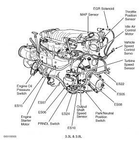

What & where are the:
Turbine Speed Sensor
Output Shaft Speed Sensor
How can I check it?
Jul 23, 2010 at 3:46 PM
OBXAUTOMEDIC
  • 3,711 POSTS
Here are the locations of the sensors.... They are very inexpensive about $15 - $20 each.
https://images.2carpros.com/forum/automotive_pictures/188069_97towncountryturbinesensor_1.jpg
Press CTRL + to zoom in
